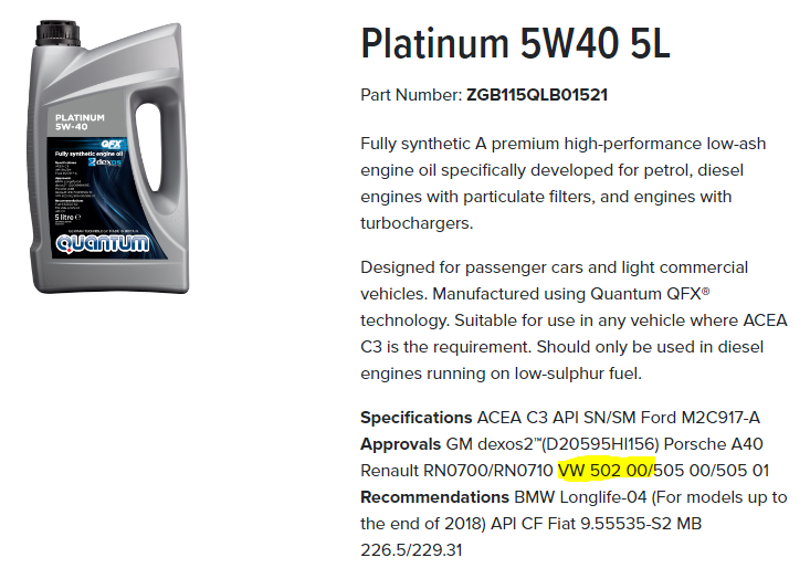

The paperwork shows it was refilled with Platinum 5w 40 oil which I would presume is Quantum Platinum VW 502 FS spec.

@silver1011 Maybe it was VW507.00? Just listed as  FS02 Platinum 5w 40 on the worksheet, presumed  it was VW502 for the fixed service regime?
