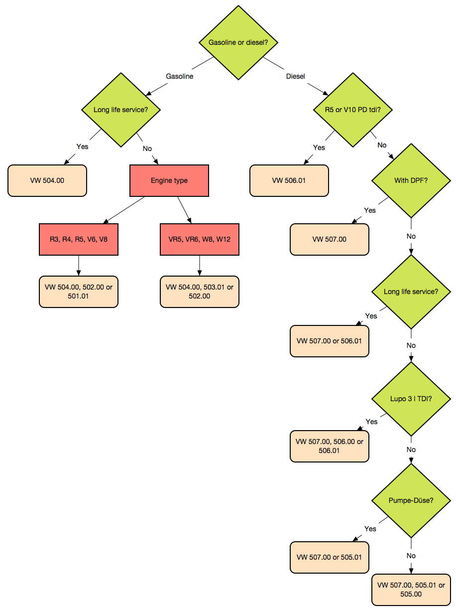

https://www.oilspecifications.org/volkswagen.php
Good image to explain the different numbers. It can be quite confusing.

:blink: That looks like an old infographic...?
Yes. But will explain a bit why the numbers are like they are. Click the link for updated info

Typical VW *******s that will confuse punters and mechanics alike.   Just like that schematic diagram above apparently designed to simplify things.  Just look at the flowchart for the petrol engine. Wouldn't it be much simpler to have said "VW504 to be used for all gasoline engines"   Why are they even bothering about 503, 502 or 501 - just use VW504 and you can't go wrong.

That flow chart shows Fixed and Variable Servicing,
