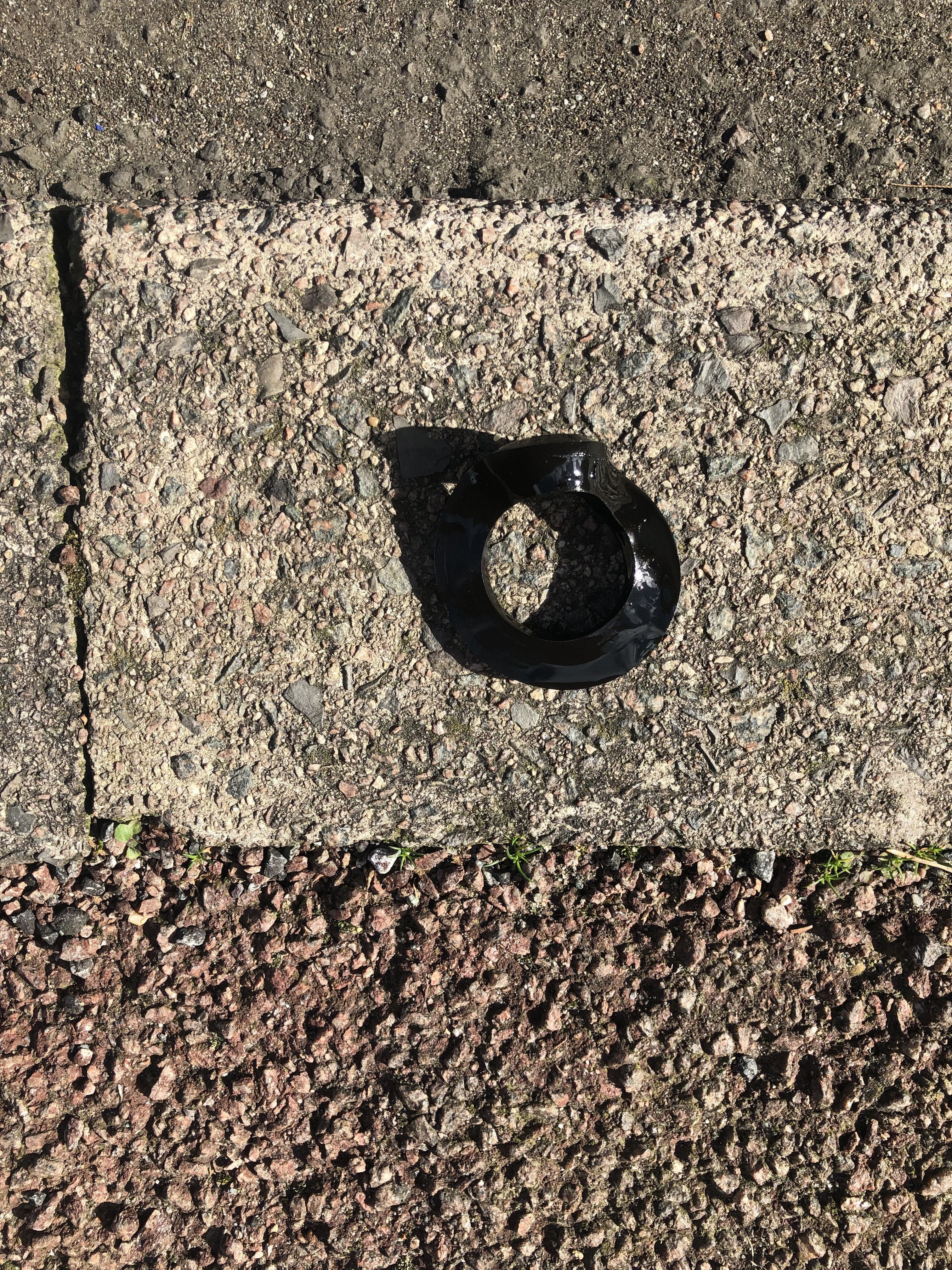

It was found that when the filter was removed - hidden away and only just in sight was a washer from the previous filter. Apparently this has happened on many occasions.
Worth removing the filter perhaps? - and taking a look. Sorry I cannot be more specific, but I recall that a mechanic phoned his Skoda friend in Poland, and immediately got this 'fix' which worked.

THANKS GUYS.  I got it sorted.  When we took off the oil filter there it was, the old filter washer, split and sitting underneath the new one.  two minute job.  Thanks to everyone who responded.  It's a weight off my mind, no way you'd sell a car with an oil light on.

Hello guys . Thanks you for your help , I can’t believe that the mechanic was so idiot and left the old rig inside . 30 seconds job and no problem whatsoever. Thanks to the polish friend :)

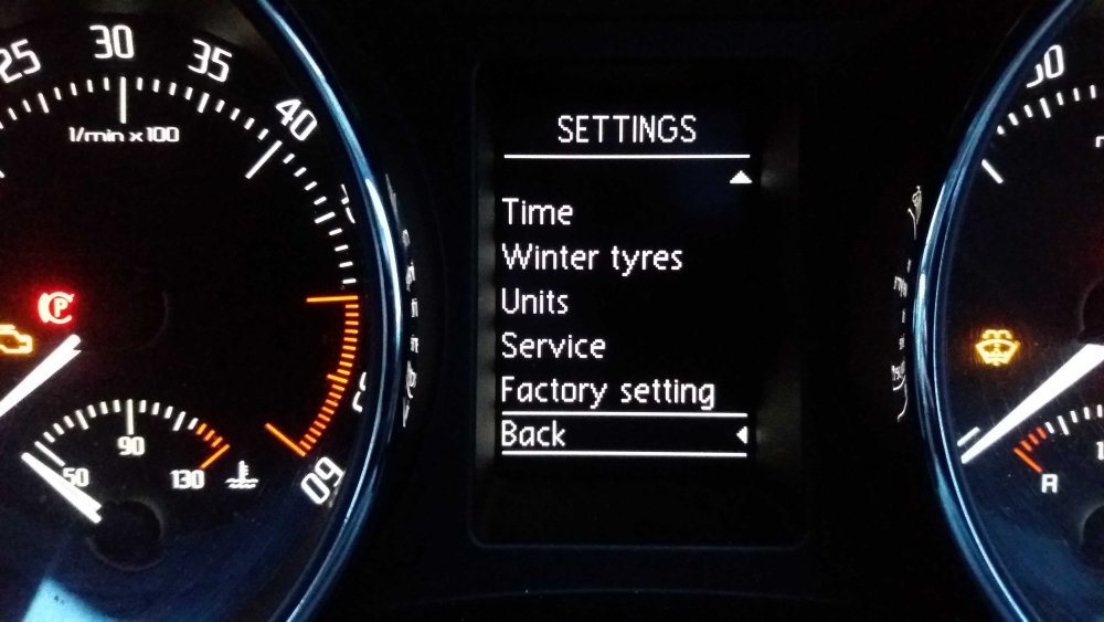

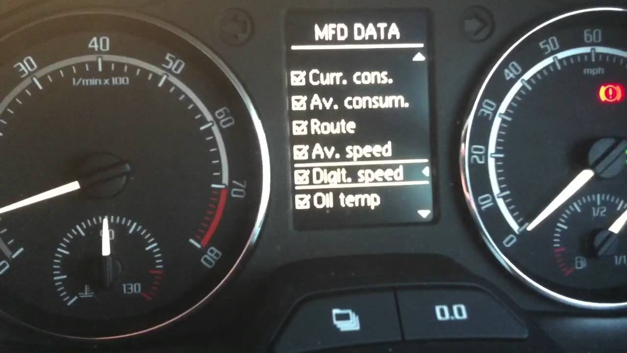

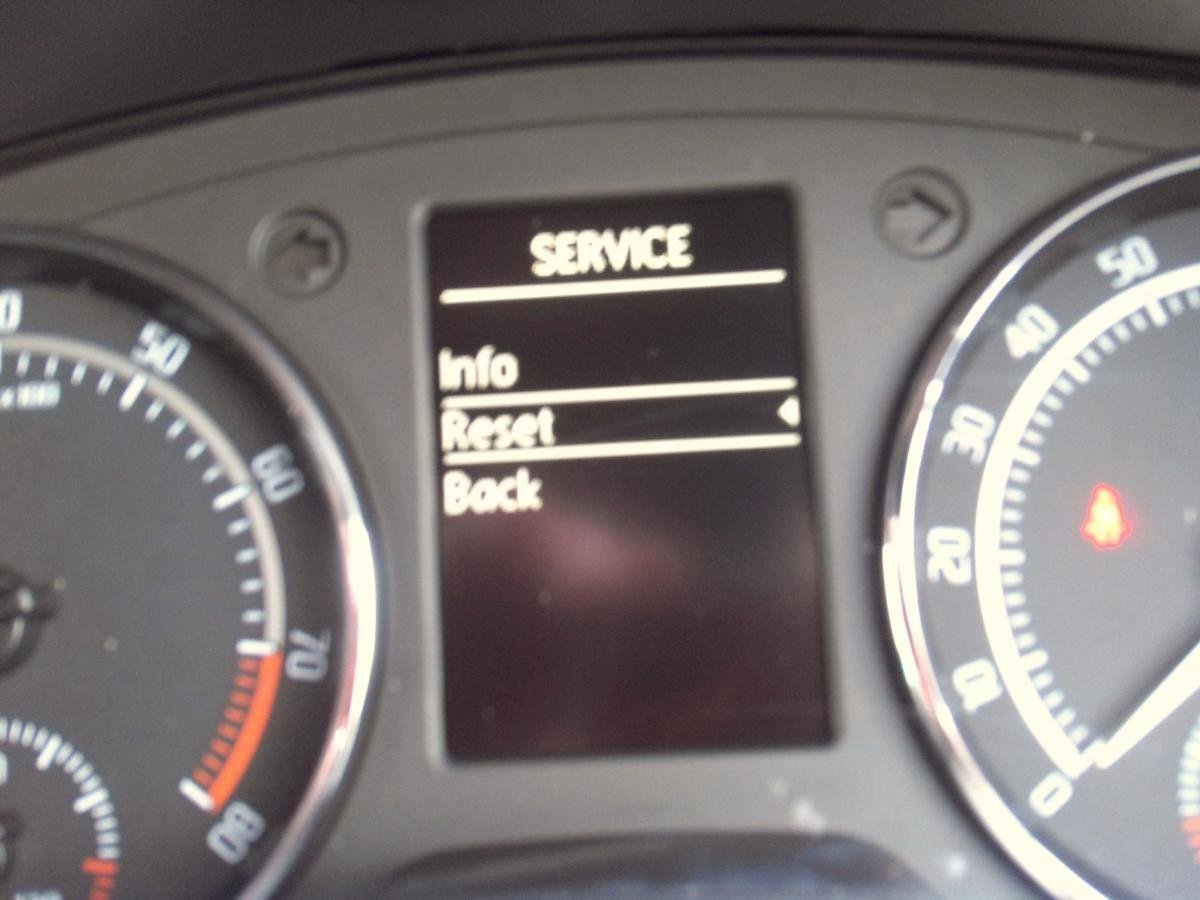

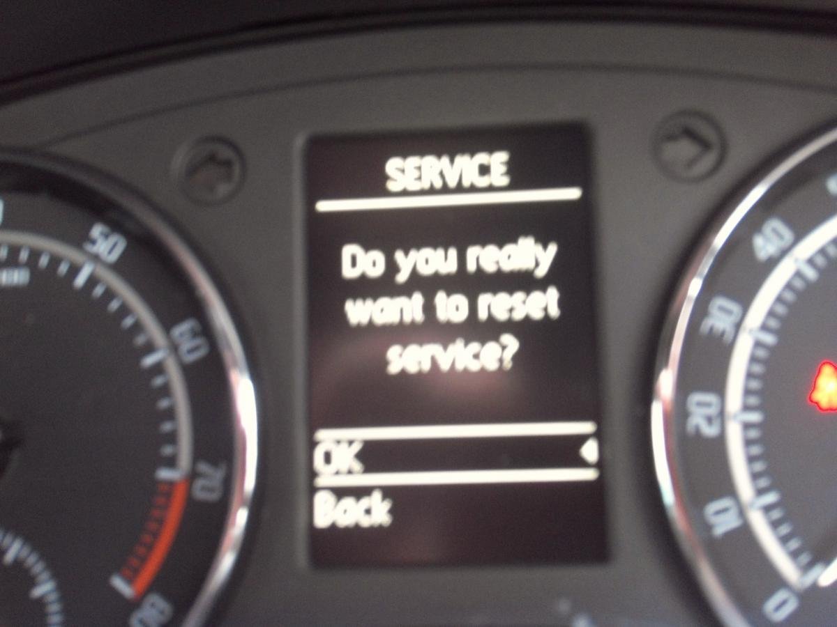

If the car is set for Fixed Service Intervals then you can reset that still with the indicator stalk buttons. (Now i see you have a 2008 car then with button on dash.)
If the car is set on Variable Servicing you can not.
Before it went in for servicing what was it showing as days / km to the service and what is it showing now?
