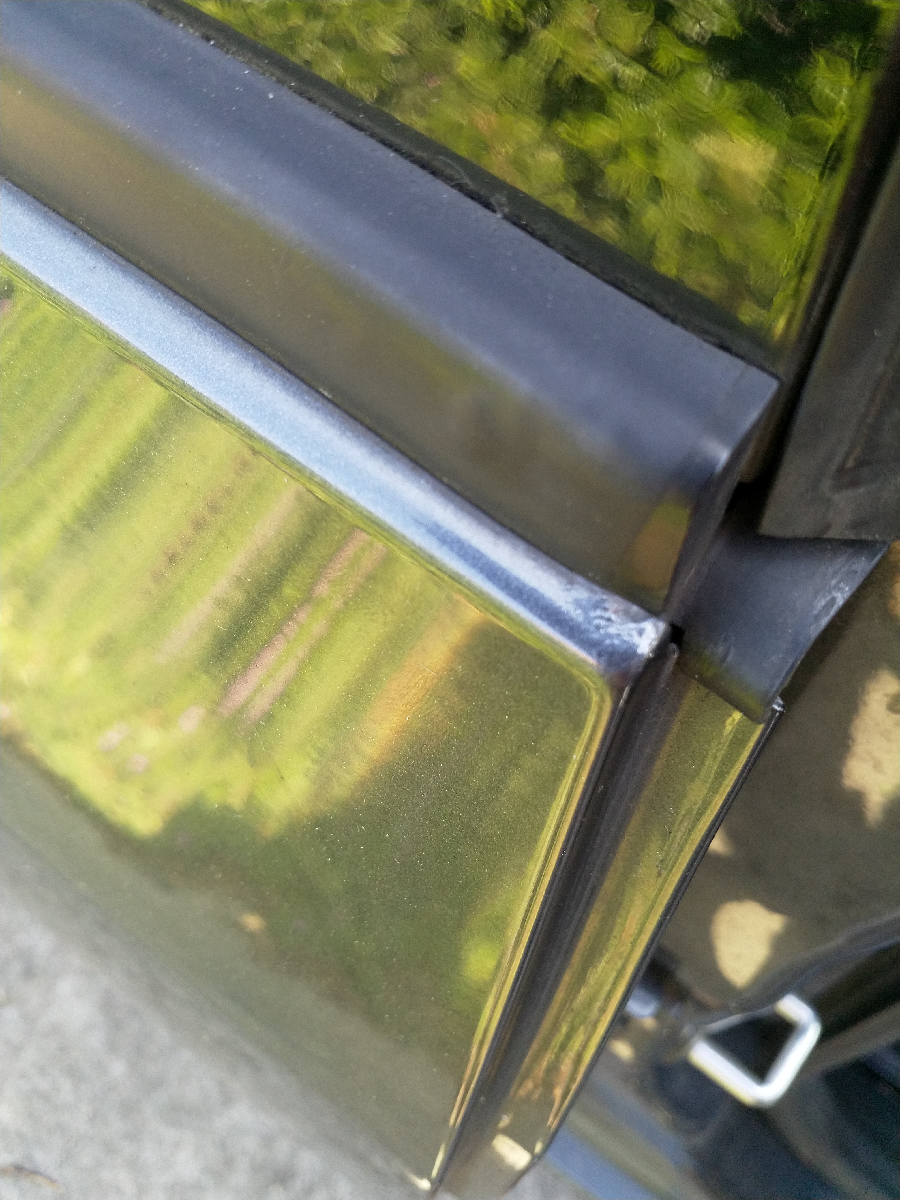

I noticed there is corrosion on both of my rear doors in the same spot - just under the bottom window seal next to the drivers door. (Image attached) Is the a common fault and is this worth a claim against the 12 year anti-corrosion warranty? I also have fairly bad corrosion of the tailgate around the reg lights spreading up and inside the tailgate behind the interior trim.
Becoming more common on the doors now of some Mk2 Fabia.
As to the rear hatch corrosion look down this or the last few pages for a recent post with links to past posts, the hatch corrosion has been common for several years.
The Corrosion Warranty really does not cover it as the panel has no hole,  and the paint warranty does not as expired according to Skoda,
but they still need to get it inspected get a report and commonly get it sorted, as an issue they know about.

Do you think it's worth submitting a warranty claim with the hope of getting this repaired?
I'm really quite disappointed with the bodywork. The tailgate is really quite bad so will need replacing tbh. I had hoped to keep the car a long time so perhaps it's worth looking at fixing myself.
Yes.
  Ask at a main dealership for them to arrange an inspection by a qualified person. Not their qualified person, the Warranty Manager can arrange who ever and a report.
They can use whoever they want to take the photos for Skoda UK
but do not take their word on it not being covered.
They are not paying, and they do not have the rusting car.

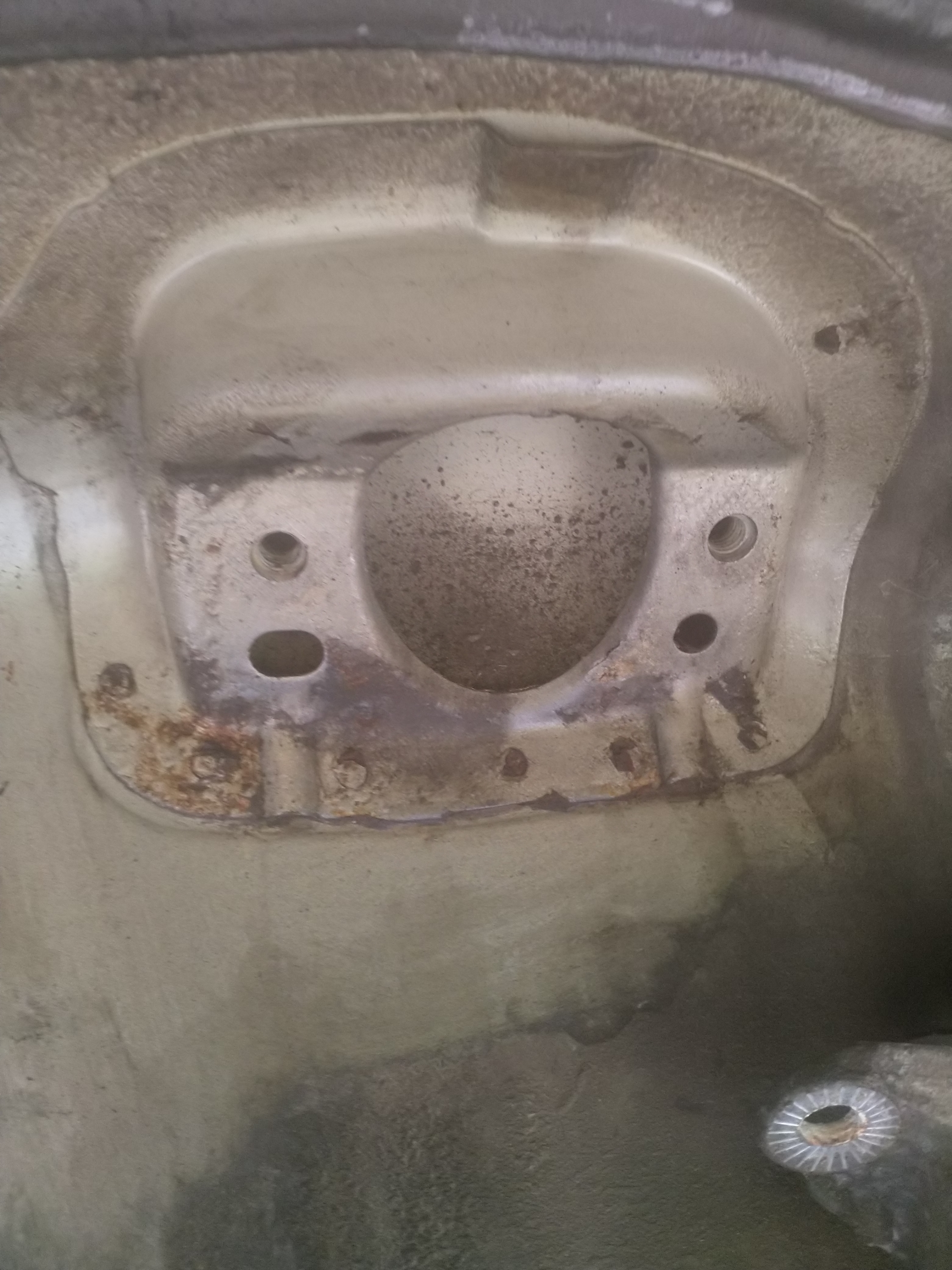

Adding to this, I was replacing my rear shocks and bump stops when I found this in the strut top mount bracket... Not a great place for rust to be starting, seems this problem was carried over from the MK1 Fabia.
i did have my mothers car on the ramp and cant say i noticed any rust starting on the upper shock mountings i will have to have another look, i haven't had chance to check the service book yet, but from memory it was skoda serviced except for a couple of additional services due to the mileage the car covered, i will update later.
You have to remove the wheel arch liner to see the corrosion, it's pretty much invisible without doing this.
