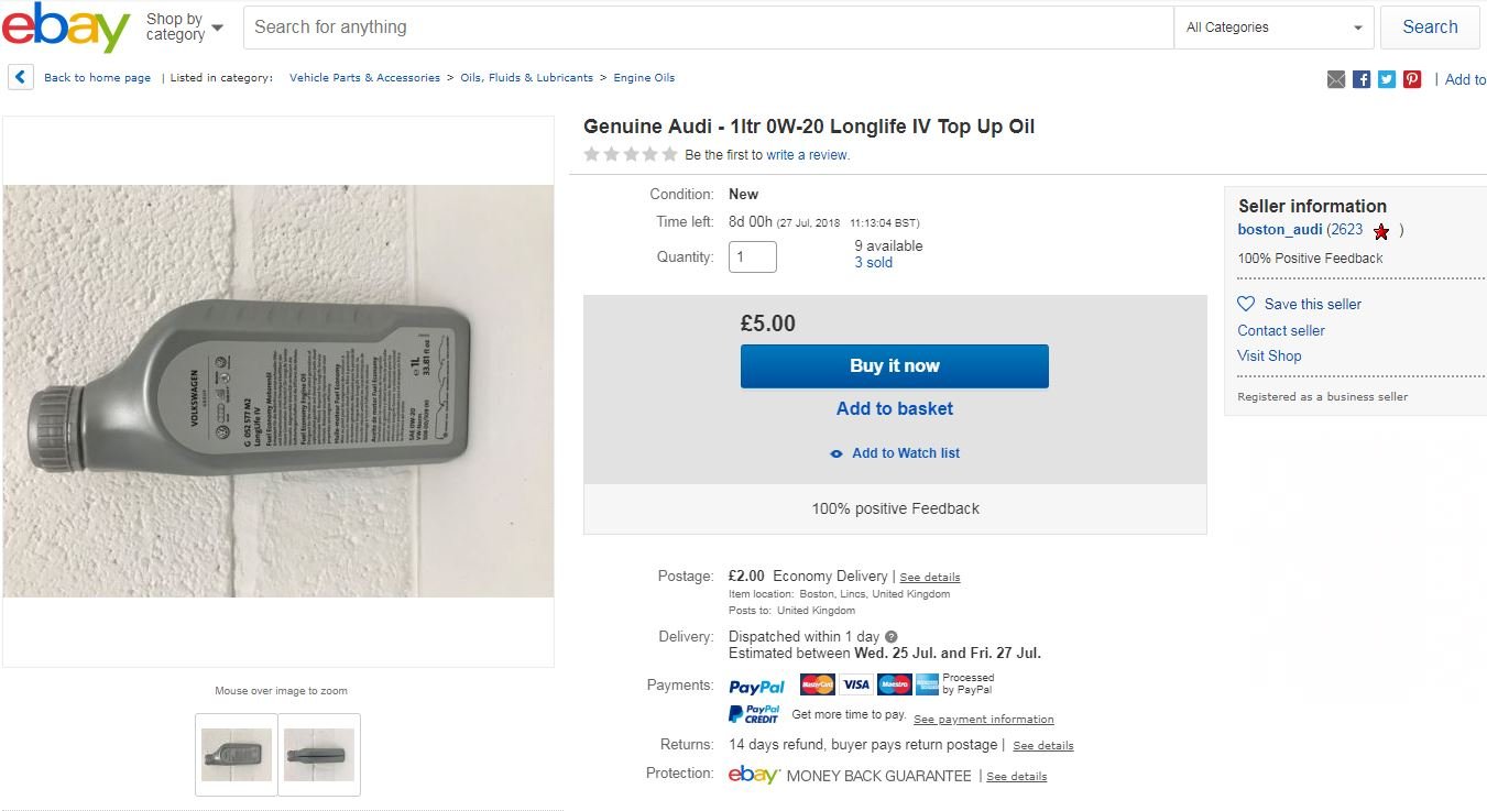

  • Thanks Offski I've managed to find the VW 508 oil from Boston Audi on eBay for £7 inc delivery https://www.ebay.co.uk/itm/142846288652

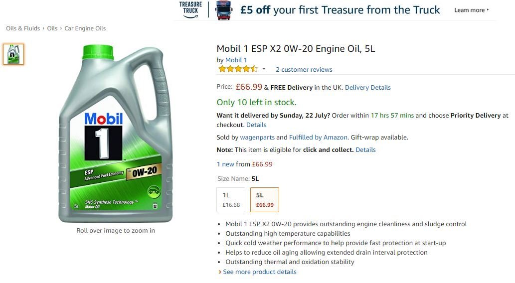

Thanks Offski I’ll pick up some of the Castrol 0w20 from Amazon then. I’m not bothered about the extra cost would rather put the best I can in my Bear. Many thanks again.
Not the best you can IMO,  it will be crap really as Long Life Oil & 0w 20.

Cant open the link, but that sounds like a Typo from them, should be £17.
Other Dealerships would be buying stock from them....
Edited by Offski
It's item no 142846288652 on ebay for anyone who's interested
That's good for 1 litre, £7.00 delivered, even buying 5 of them for an oil change wouldn't be too bad @ £35.
It would be worth asking them how much for a 5 litre container inc. delivery.
Better priced than the non OEM stuff!

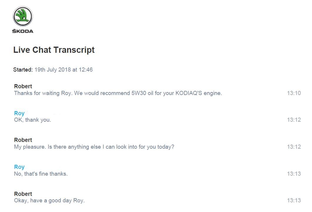

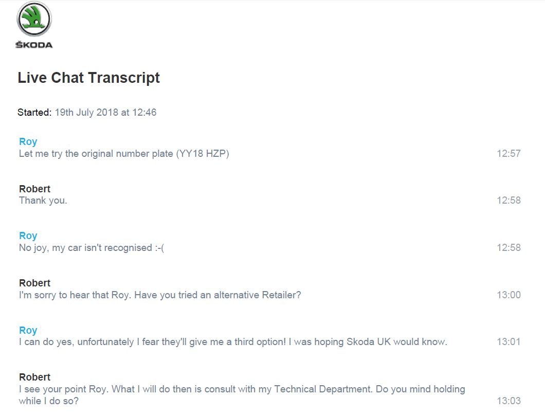

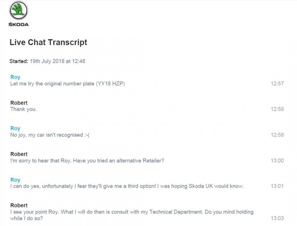

Just out of curiosity I spoke to Skoda UK to ask for a definitive answer on whether it should be 0W-20 or 5W-30. Unsurprisingly they didn't know and referred me to a dealer.
They are now enquiring with their 'Technical Department' as I type. Here's hoping.

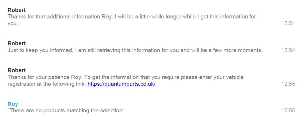

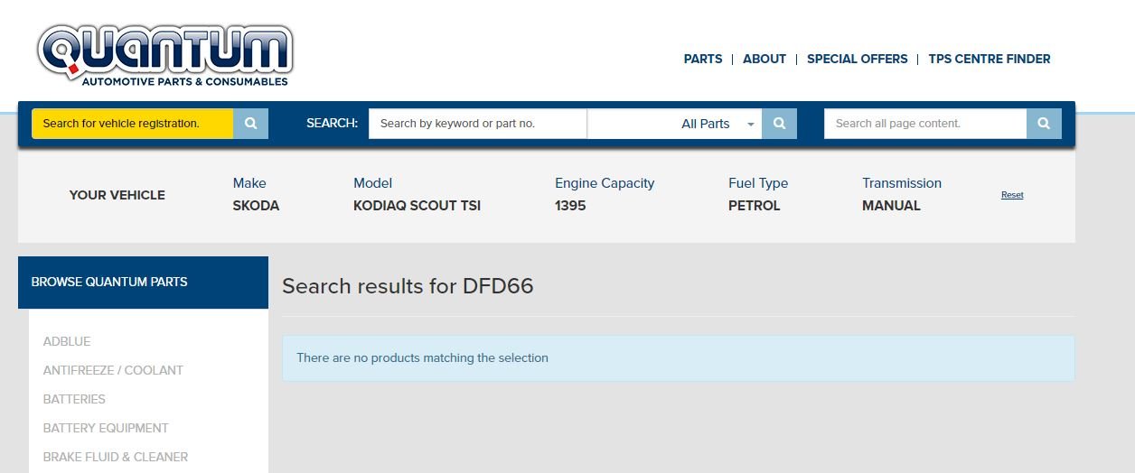

What they did initially suggest was by using this website, Quantum is VAG's own brand name for their OEM oils and fluids.
Type in your reg number in the box in the top left corner...
https://quantumparts.co.uk/
Unfortunately my car isn't recognised. Hopefully you have more luck.

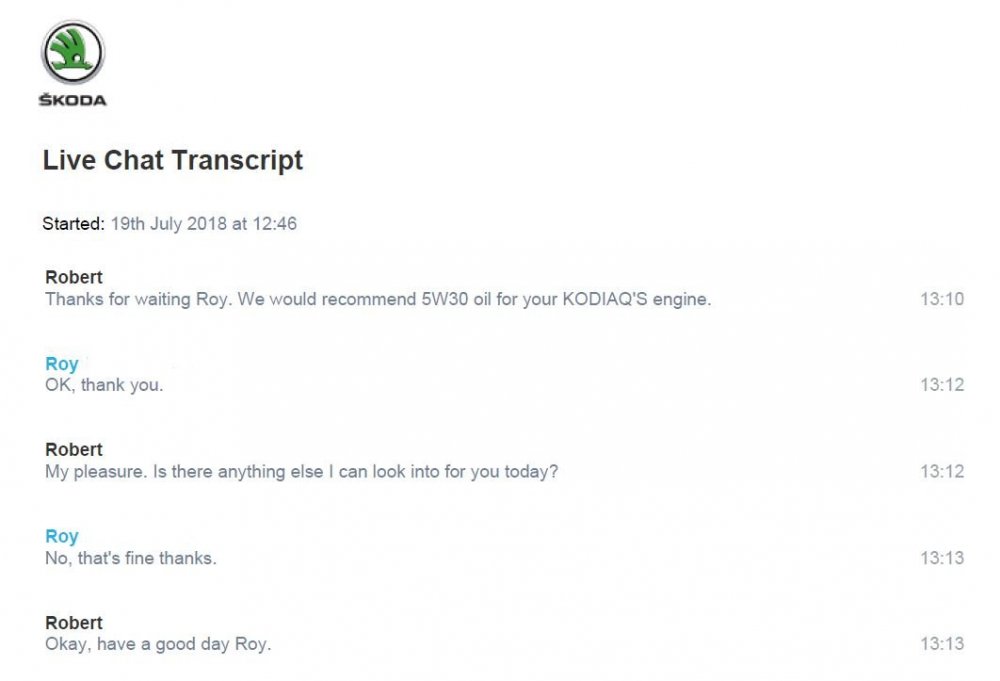

Skoda UK insist on 5W-30.
Clear as mud then :dull:

I’ve just put my reg in the Quantum site, recommended oil for my 2.0 Tsi Platinum 5W40?
^^^ A perfect recommendation for Fixed Servicing of a TSI if it meets VW502 00.
 Pity VW Group Dealership Techs will not suggest or be allowed to, those that care know that is 'Simply Perfect' for owners that care about their cars engines.

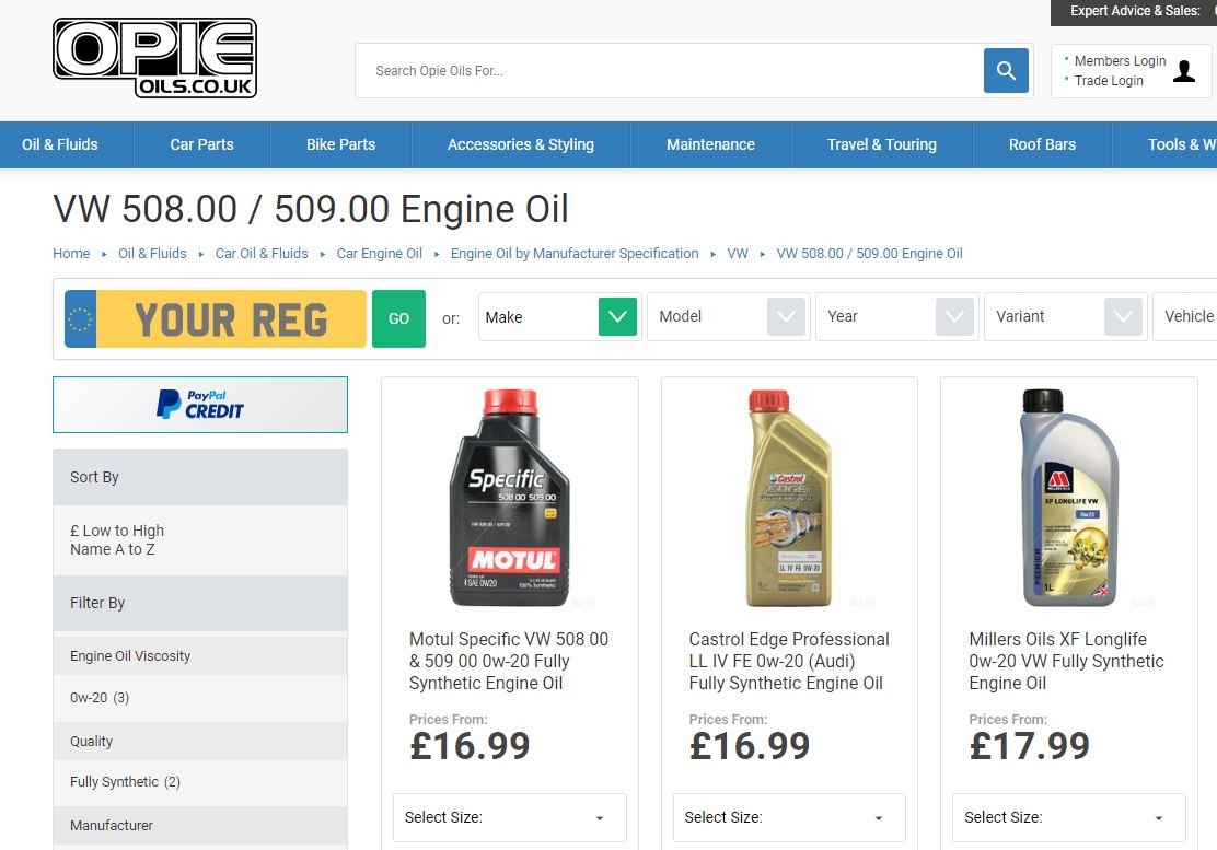

Question is, is there a 5W-30 oil that conforms to VW 508.00?
The only oil Opie Oils sell that is VW 508.00 / VW 509.00 approved is 0W-20!
Grrr!

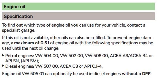

In the Kodiaq manual I got off the Škoda website it shows the following...
Edited by atki81

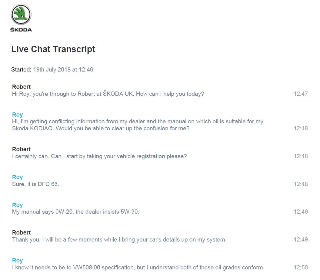

Right, I came close to losing my temper with Skoda UK this afternoon.
They were adamant the only thing I needed for my 1.4 TSI Kodiaq was 5W-30. Nothing else mattered.
I told them that the oil needed to meet one of VAG's oil spec standards. They said no, I said yes. I asked them to progress my enquiry as a complaint.
Later this afternoon I got a call. A complete u-turn. The grade of oil is irrelevant. As long as it meets VW 508.00 then it's fine.
So that means 0W-20, unless someone knows of a 5W-30 oil that meets VW 508.00.
Still not entirely convinced but by this time I was losing the will to live.

I wouldn't trust their search function - my car (1.4TSI) shows up as 0W40 or 5W40 as being suitable (which complies with VW 502/505).
