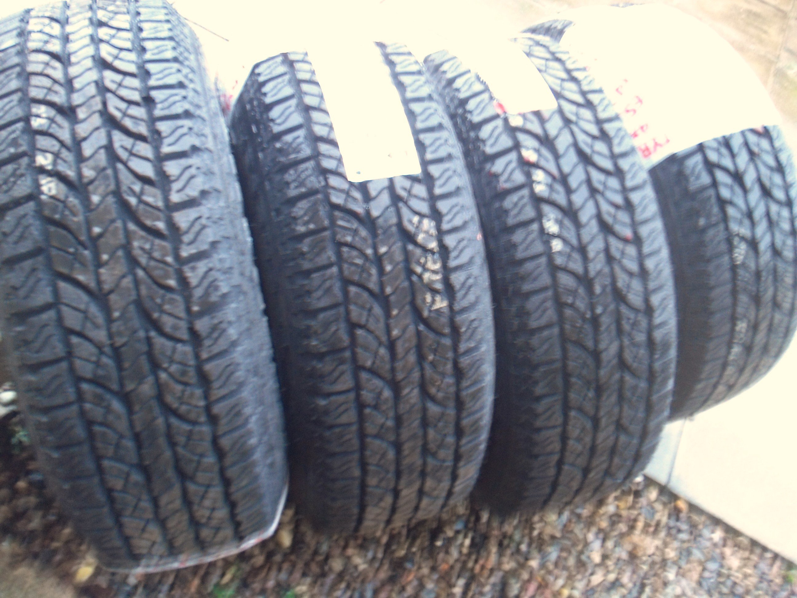

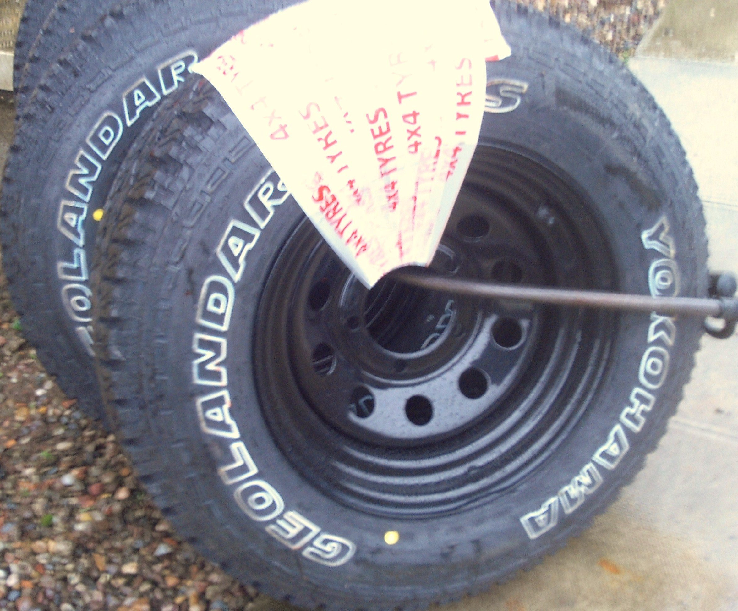

Or go 215/75 R 17 and longer springs and dampers.
Consider the wheels offset as well.
Maybe for Australia go for a 16" wheel and taller tyres and longer springs and dampers.
(215/80 R 16 a good size for serious tyres for serious terrain.)
Or All Terrains with good road manners.
