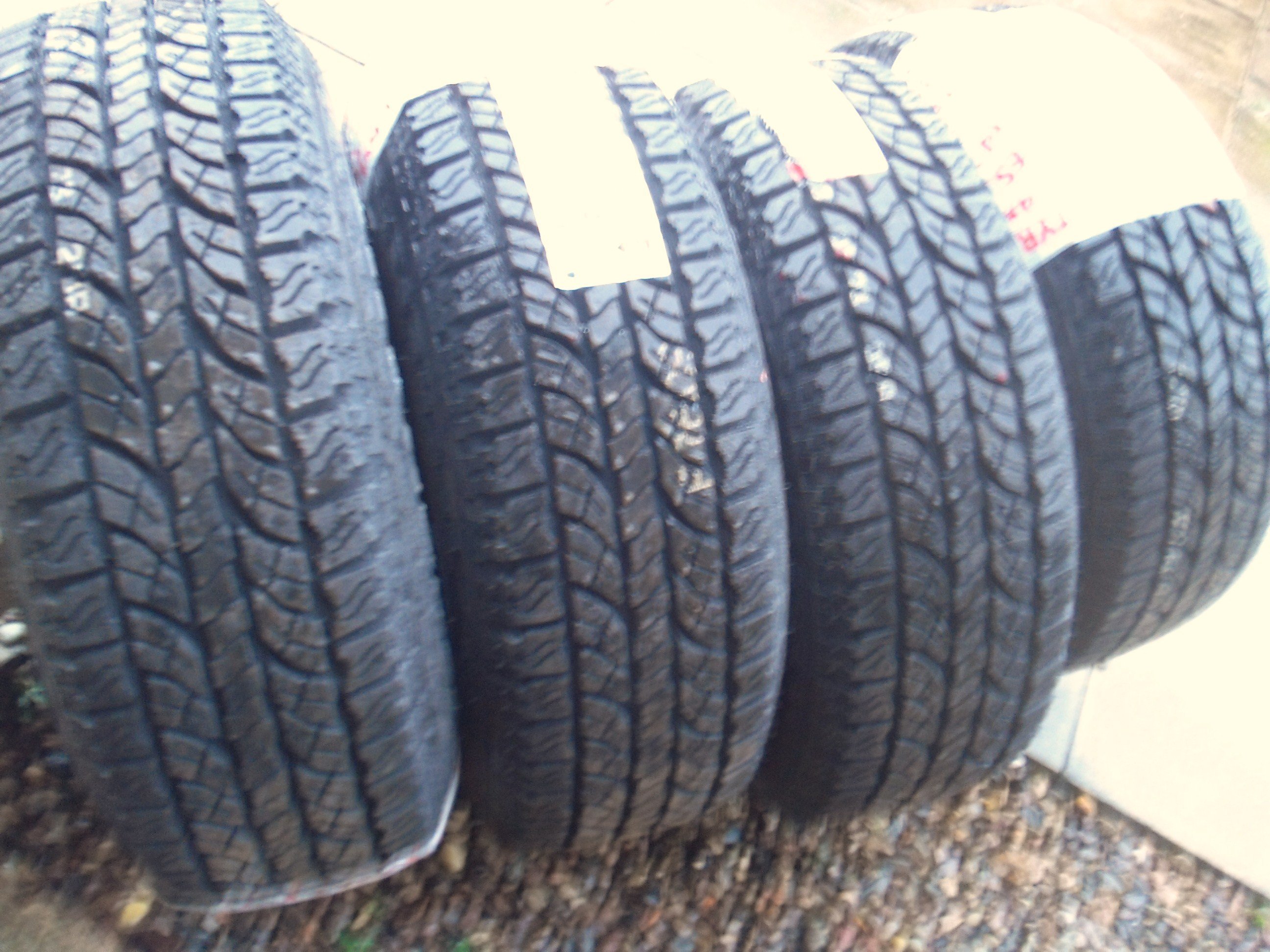

So I bought 4 x Insa Turbo Ranger AT remoulds at £60 each. Mus and snow rated. They are a copy of the BF Goodridge AT tyres. For less than half the price.
... and then 4 x 16"  6.50 J ET42 Alloys for £75 each from Oponeo. (Why buy steels for £42 when you can have alloys for £75? 🙂   )

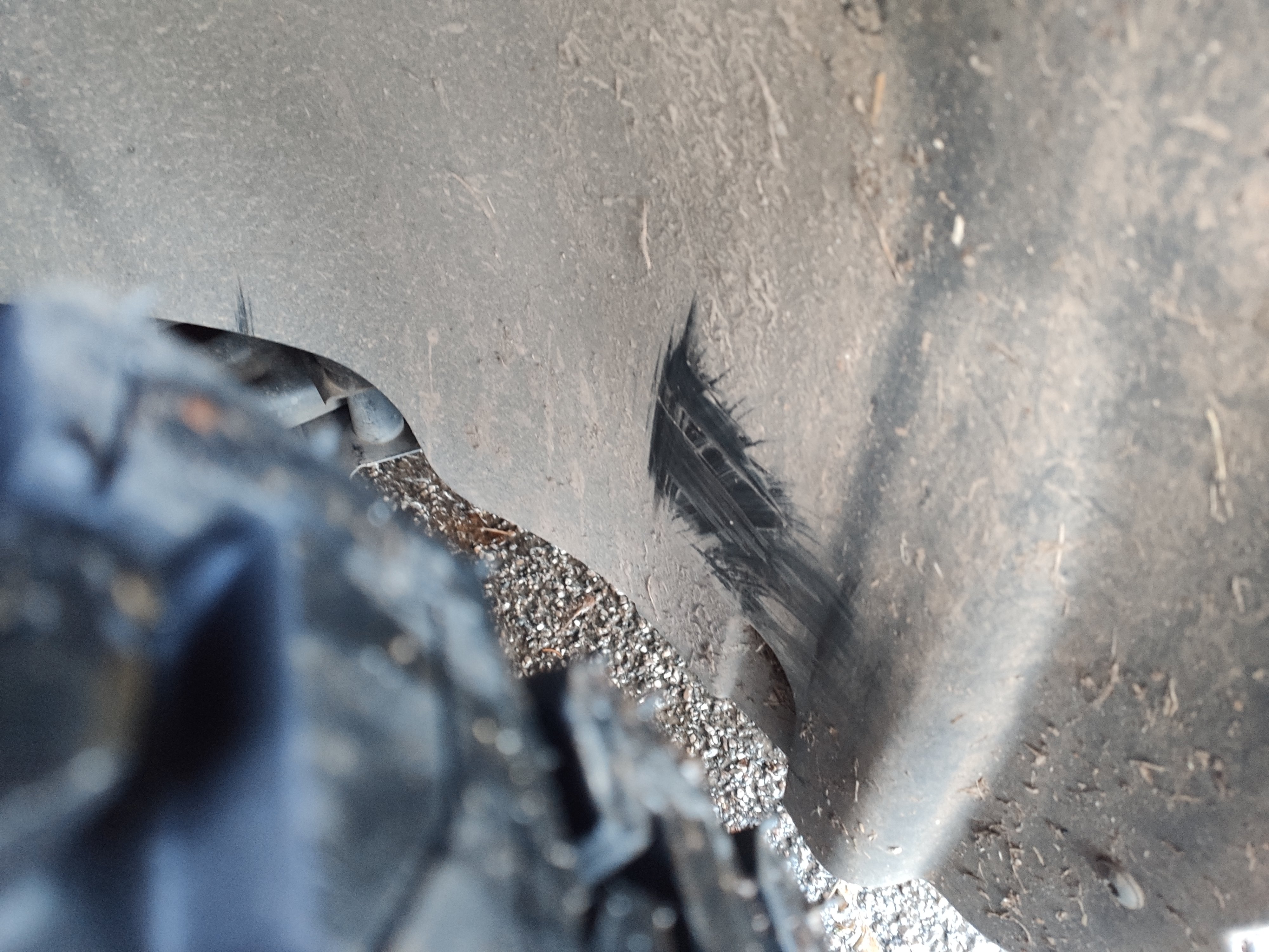

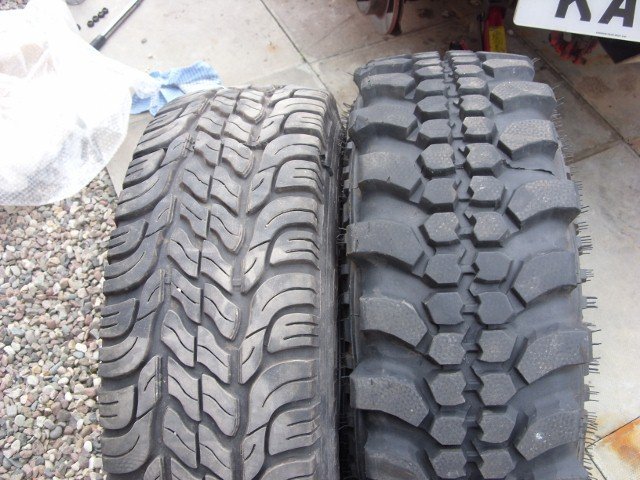

Fitted them 2 days ago. 1st observation was that the size of the tread on the Insa Turbos makes them 5cm bigger (total diameter) not 3cm. They "just " touch the front arch inner plastic liner on full lock, on one side only. Touching at the back of the arch, on full lock. This happens only when parking and gives  a small squeal on full lock . This is reducing to almost silent after day 2 so I'm assuming some of the initial rubber is wearing off where it contacts, or the plastic liner is giving a bit. Other than that , no issues. I rockon after a few thousand miles there won't be any contact.

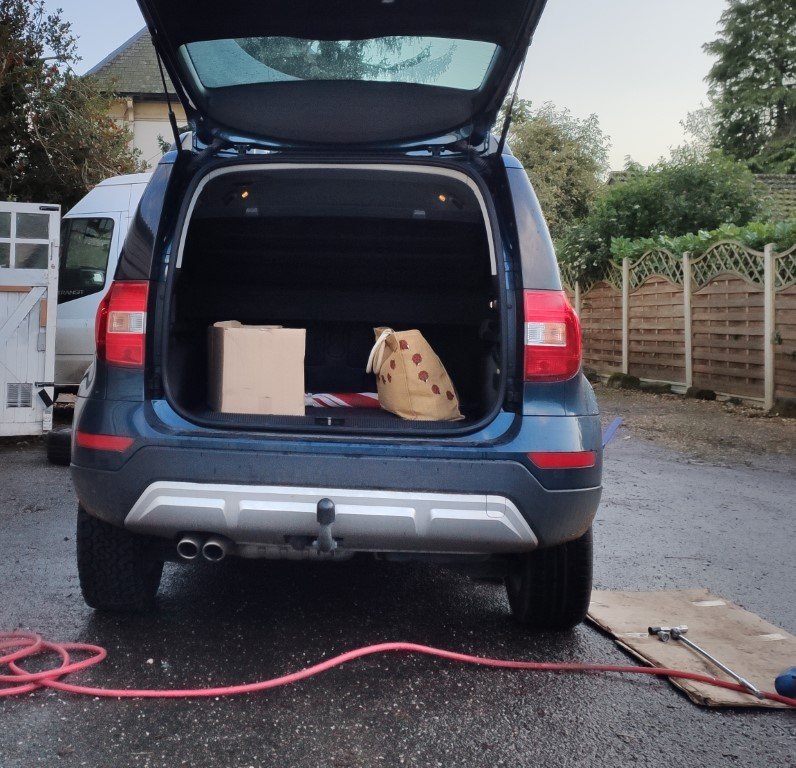

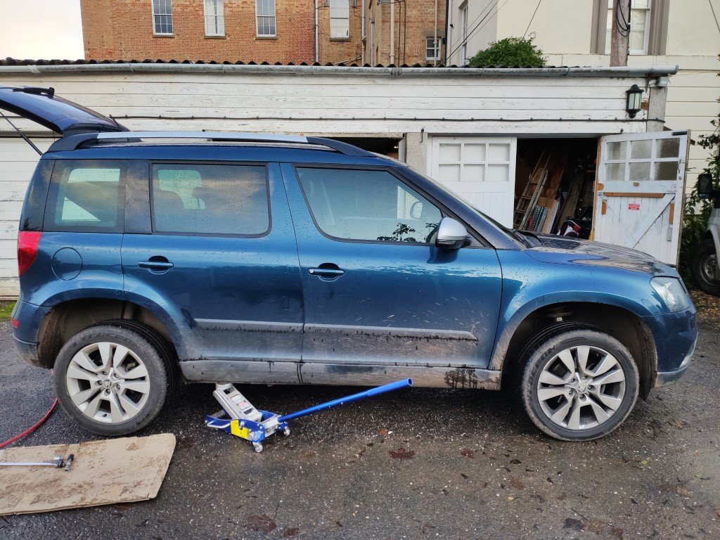

Lifts the car a bit too (hence the photo from the rear - left wheels installed, originals still on the right).
Been off road since the photos and they behave as expected - excellently. Now hoping for snow 🙂

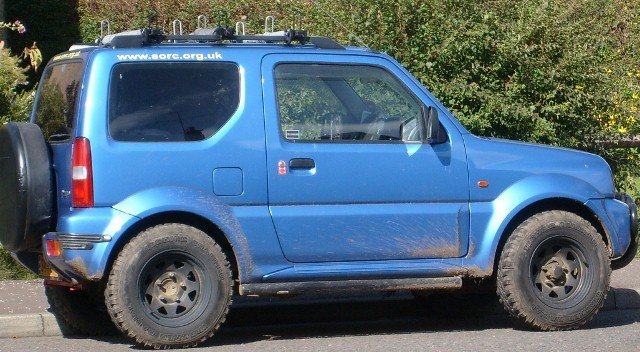

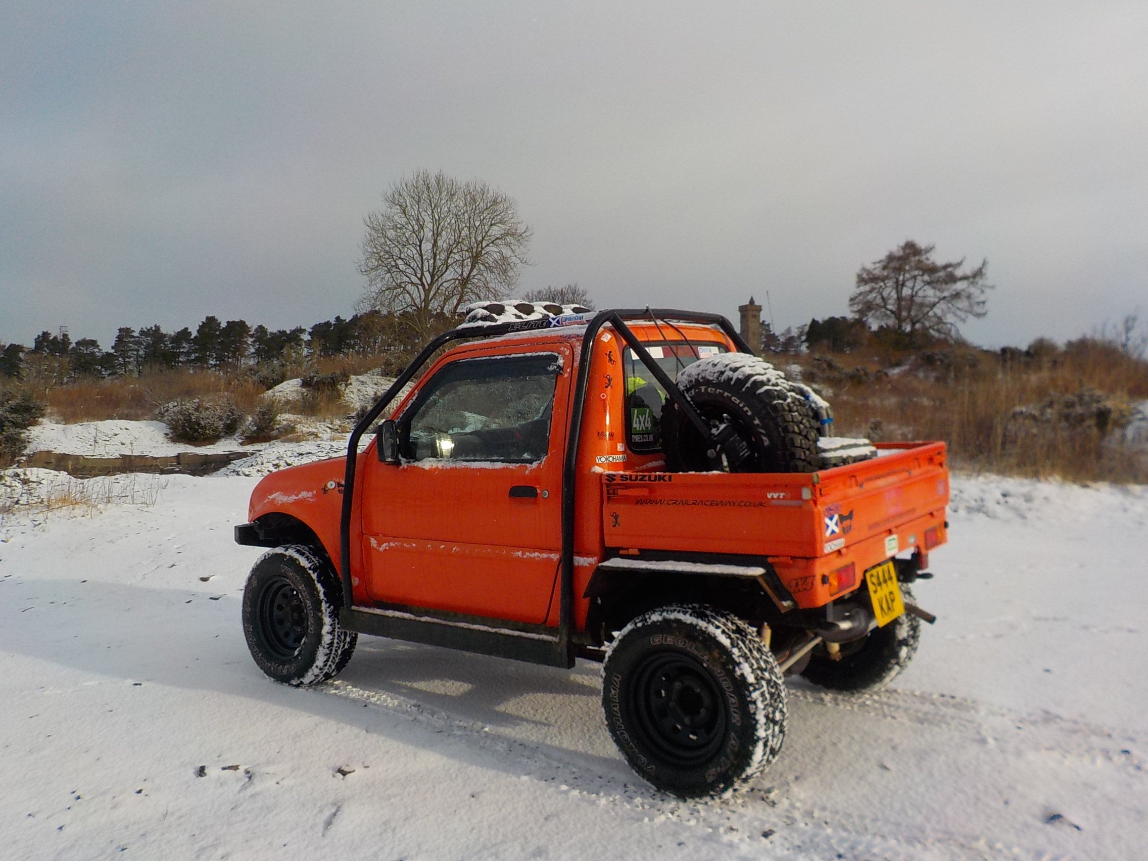

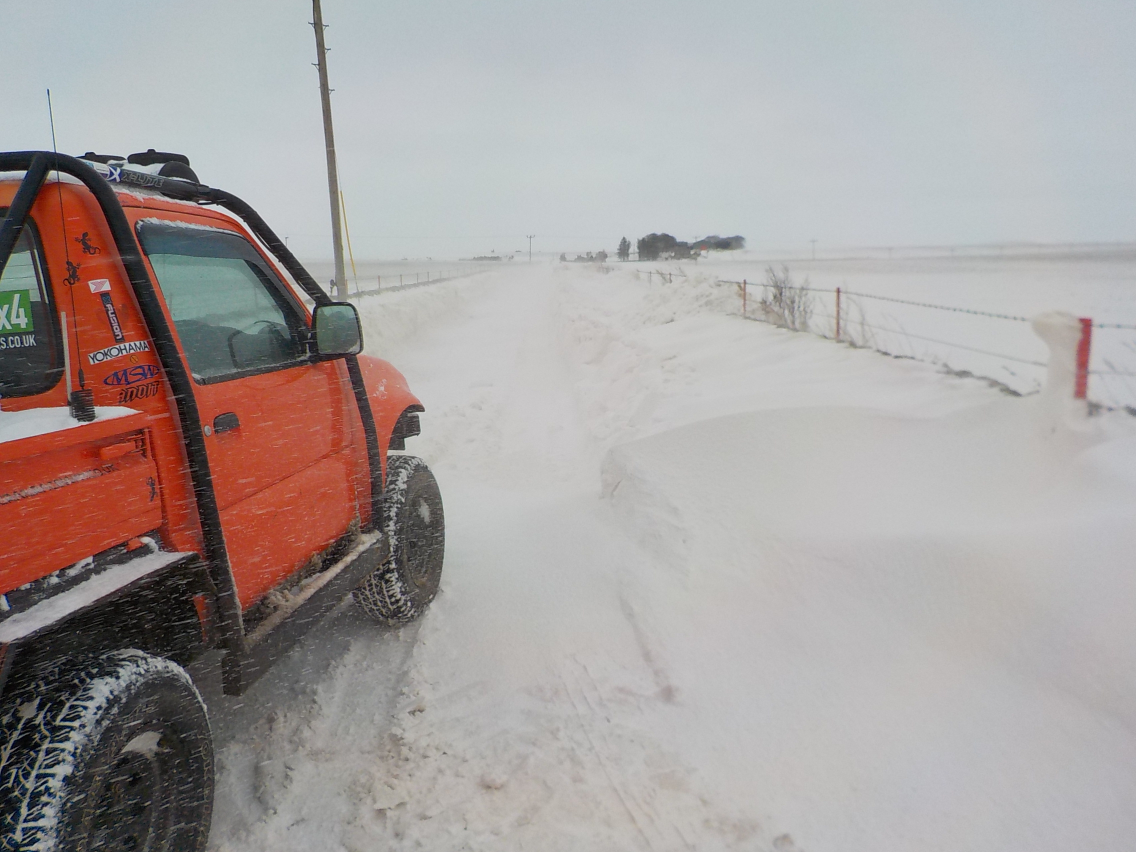

I have used Insa AT's, MT's and Snow Tyres on Suzuki Jimny's over around a dacade and they performed as well if not better than Premium / Big Name tyres.
I have not had any to use in about the past 6 years though.

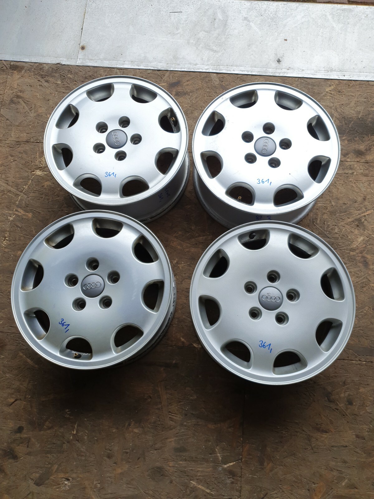

6Jx15 ET45 5/112 57.1 Audi alloy rims 8D0601025FBild 1 - 4 x Original Audi Alufelgen 6Jx15H2 ET45 Audi 100 Audi A4 Audi A6 8D0601025F
https://www.ebay.de/itm/124803659555
6JX15H2 ET45 5/112 Audi alloy rims 8D0601025F

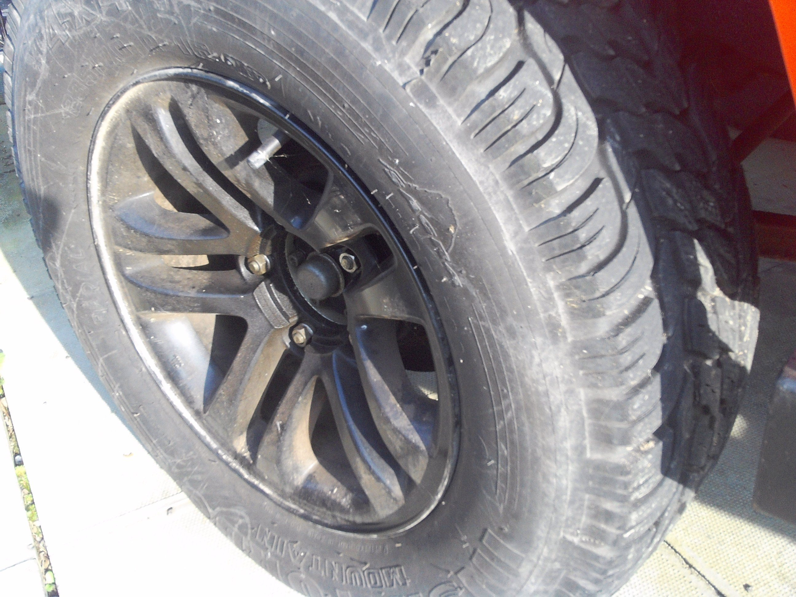

@Rich210I used 195/80 R 15 Insa Turbo Rangers for a few years on an Automatic Jimny when i did not use Insa Muds, and they were good on Snow.

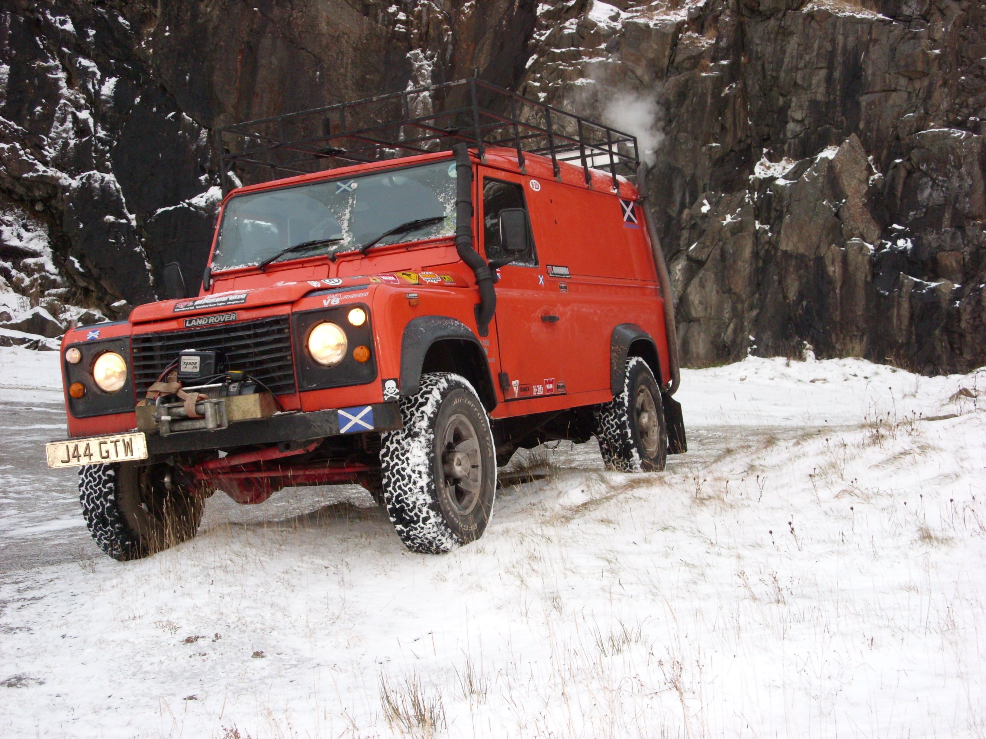

The same tread pattern as the BFG Goodrich A/T's i had on my 110 Land Rover.

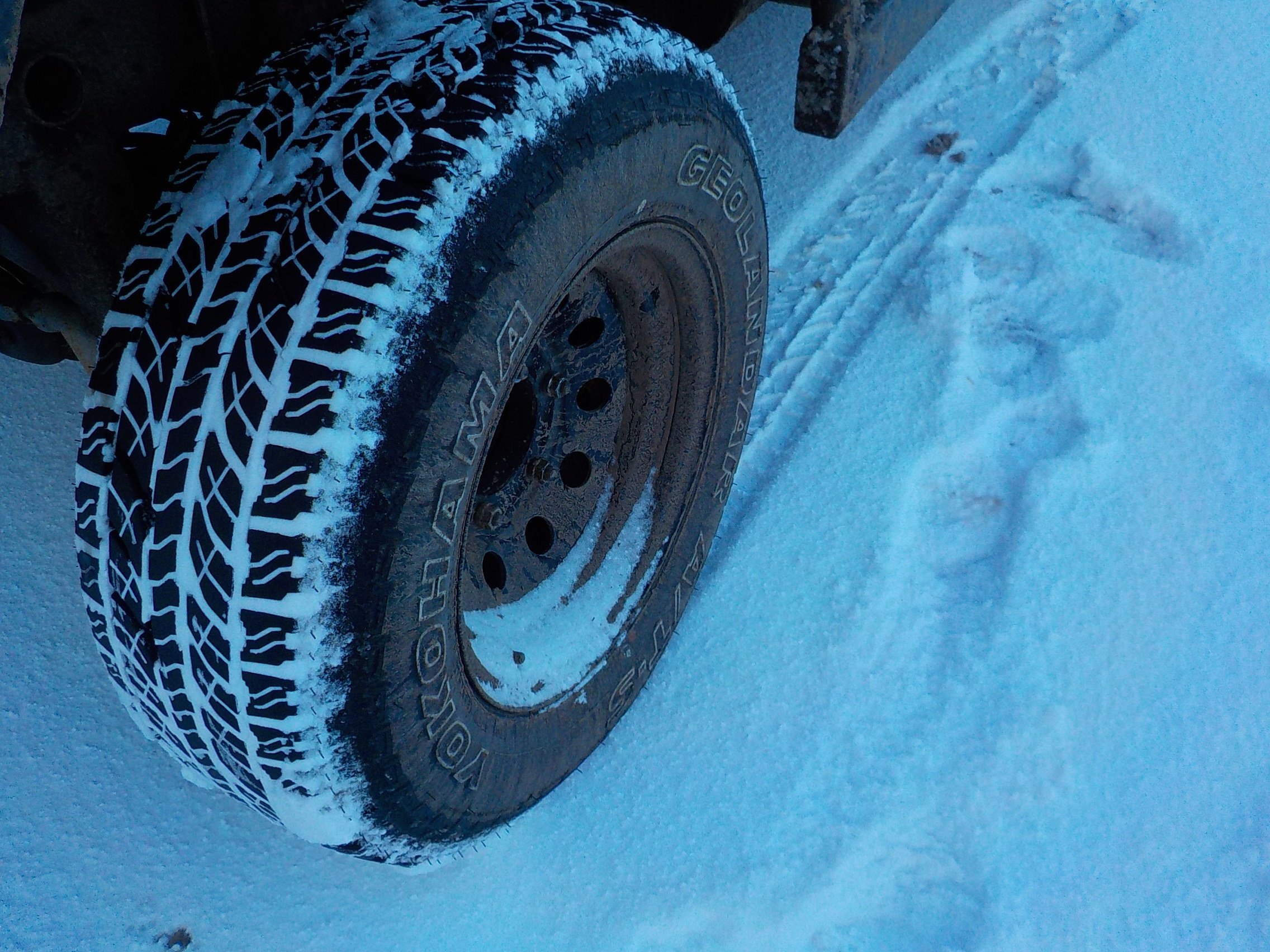

The Orange Jimny on the snow is on Yokohama Geolander G012's.

Yokohama Geolander G012. 235/60 R 16
DSCN3862.JPG.c9023719584e4c229c2a1d952a28c1e5.jpeg.8b61cbbe6336145086a6b440538dbd60.jpeg
327476120_YokohamaGeolander235.70R158x1527s021.JPG.3448f9a48f39e1374cd2e136f0f46a2c.jpeg.a4b378df7fb85efc5b8f46a2d0c1c3d4.jpeg
Edited by Rooted
