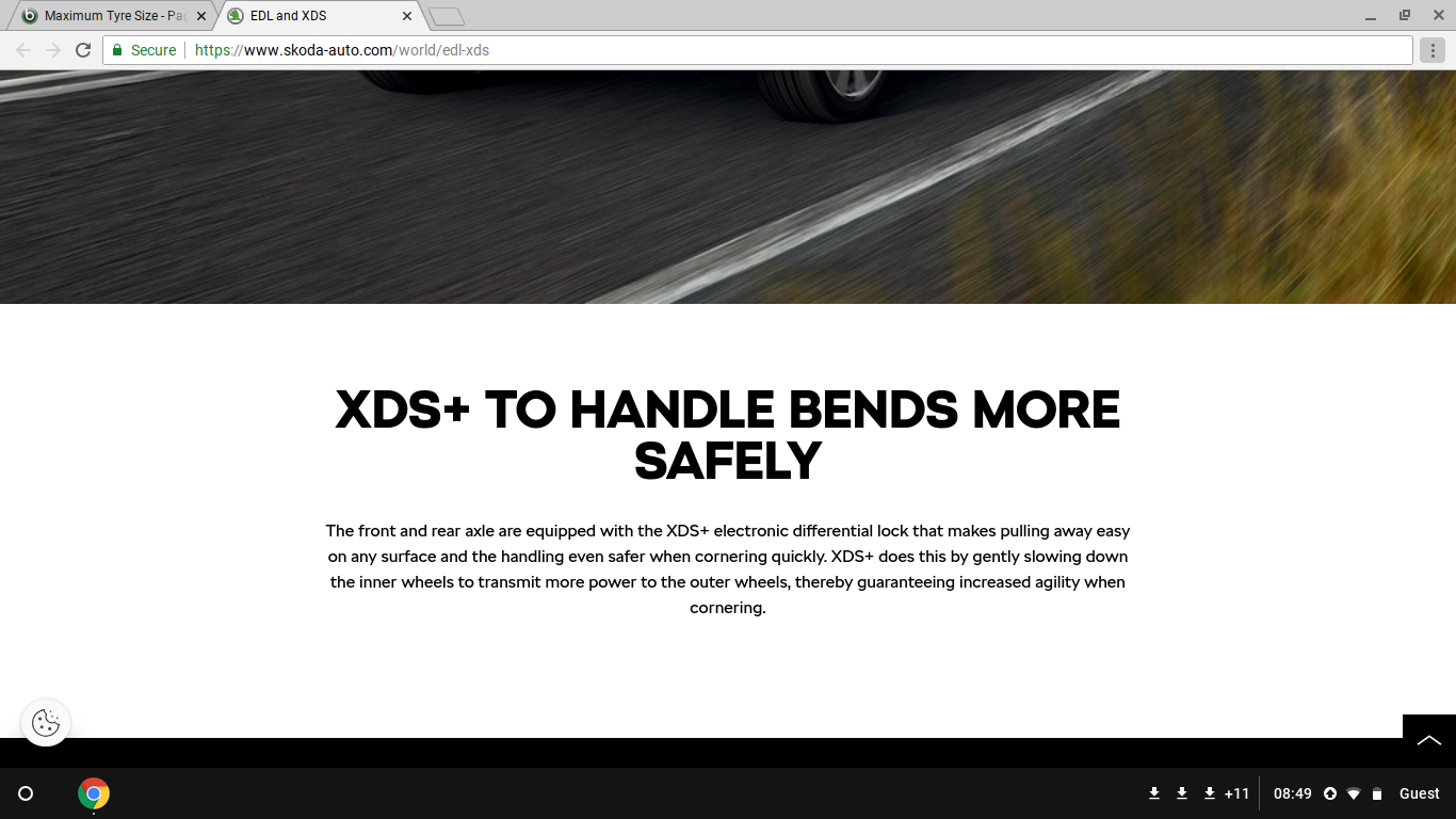

If you have a Yeti with Haldex then i would not be bothering yourself about XDS.
http://briskoda.net/forums/topic/186046-xds-now-available-with-4x4
Plenty threads after this if anyone wants to search.
http://briskoda.net/forums/topic/425322-xds
XDS was standard on Mk2 Fabia vRS and you could set it and some had it off using VCDS for track use or even spirited driving and some put it up from the factory setting.
On track if the brake system got over hot, even with upgraded hoses, fluid, pads, calipers it Disables iis self anyway.
XDS+ followed on from XDS.   Its really just EDL in different flavours.
http://skoda-auto.com/world/edl-xds
