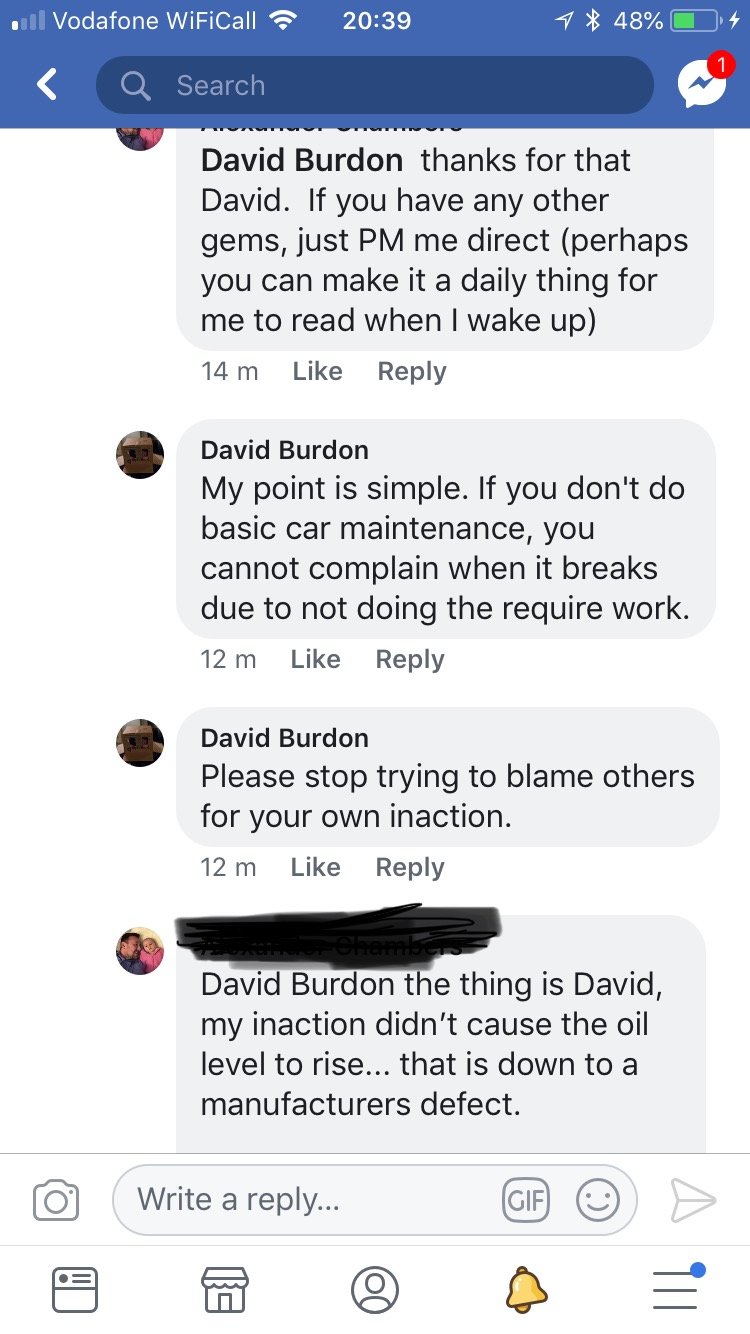

Can I just share that this guy is a douche

Who's David Burdon by the way, what's his involvement in all of this? I hope he isn't linked to the dealer or Skoda UK, very unprofessional.
