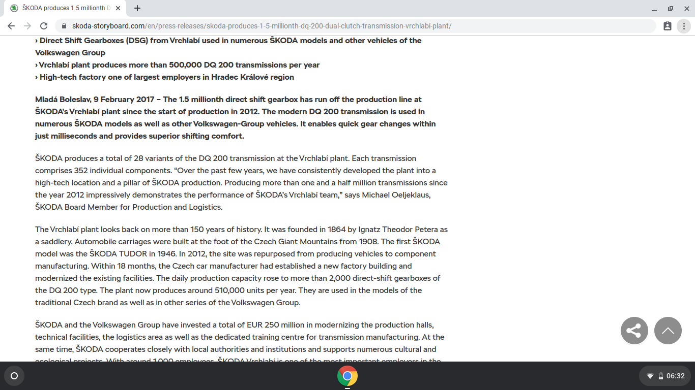

Skoda must now have manufactured in the region of 3 million DQ200 DSG's for application in over 28 models, what leads you to believe that 'every single gear box made for VW, Skoda, Audi & SEAT from 2008 until at least 2015 will fail?
Any figures on the failure rate, 2008-2012 when there was a World Wide Recall excluding Europe, or how many before or since the Service Campaigns, 2008-2012, & 2013-15?
There are issues, there are Recalls again in World Regions, there will be Civil Actions, but 100% failure rate would be a bigger scandal than the 11 million vehicles with Defeat Devices.
