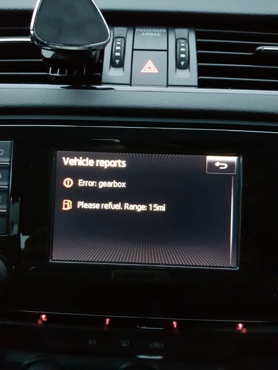

Geqr box error in skoda octavia 2015, conpany saying mechatronic error
Was it working normally and just showing an error or did you have mechanical problem as well?

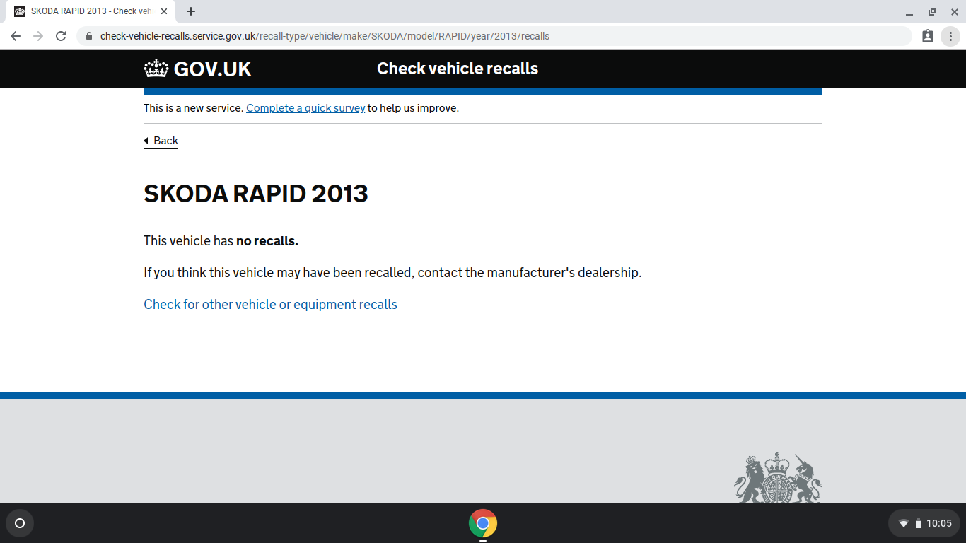

It can only be a Skoda Recall or Recall Action, it is not showing as a DVSA / DVLA RECALL.  Meaning the DVLA does not give VW / Skoda keepers contact details.
For Service Campaign 34F7 the DVLA did give keepers details to the VW Group.

I take it all Rapids from 2013 would have this gearbox? I was only assuming as it's the same symptoms I've found on various threads here.
In hindsight I probably should have taken out services at a skoda dealer but I was offered a service plan from the Vauxhall dealer when I purchased the car.
So if a 'Recall' is showing still this might well be '34H5' outstanding, the Software Update.
You had best check.  Regardless of the fault and cause of the leak now that will need doing.
The leak might well have happened even if the Oil Change was not carried out as the Software was a preventative measure.
I doubt if Skoda will care though.

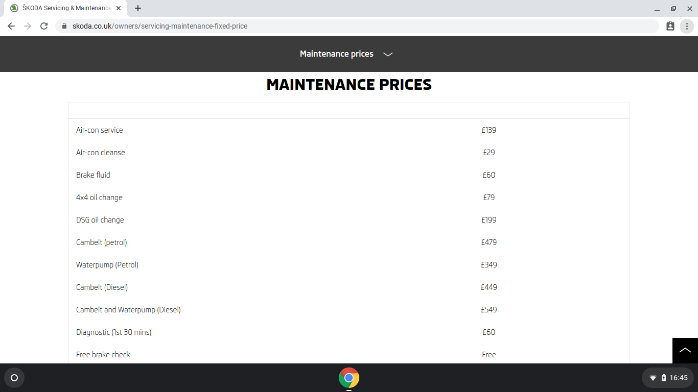

FWIW, my Skoda dealer (Murray's in Plymouth) also told me that my 65 plate DQ200 Octavia required a DSG oil change at 40k too! :)  It's not at 40k yet, but it would be interesting to see what they say if/when I book it in!!
It is interesting when you ask why they want more than the advertised fixed prices, and is it because they are not a participating dealer.
Usually they say it is because it needs 'special oil'.
