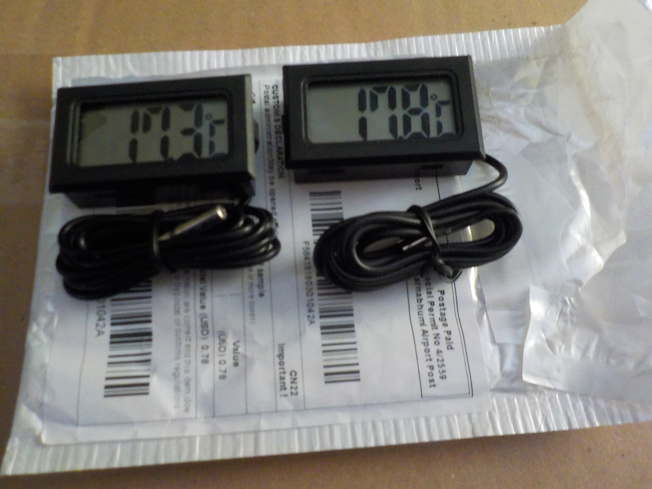

Digital Thermometers are dead handy, you get professional equipment, or 43 pence free delivery from China ones do the job,
check oil temps, tyre temps etc.

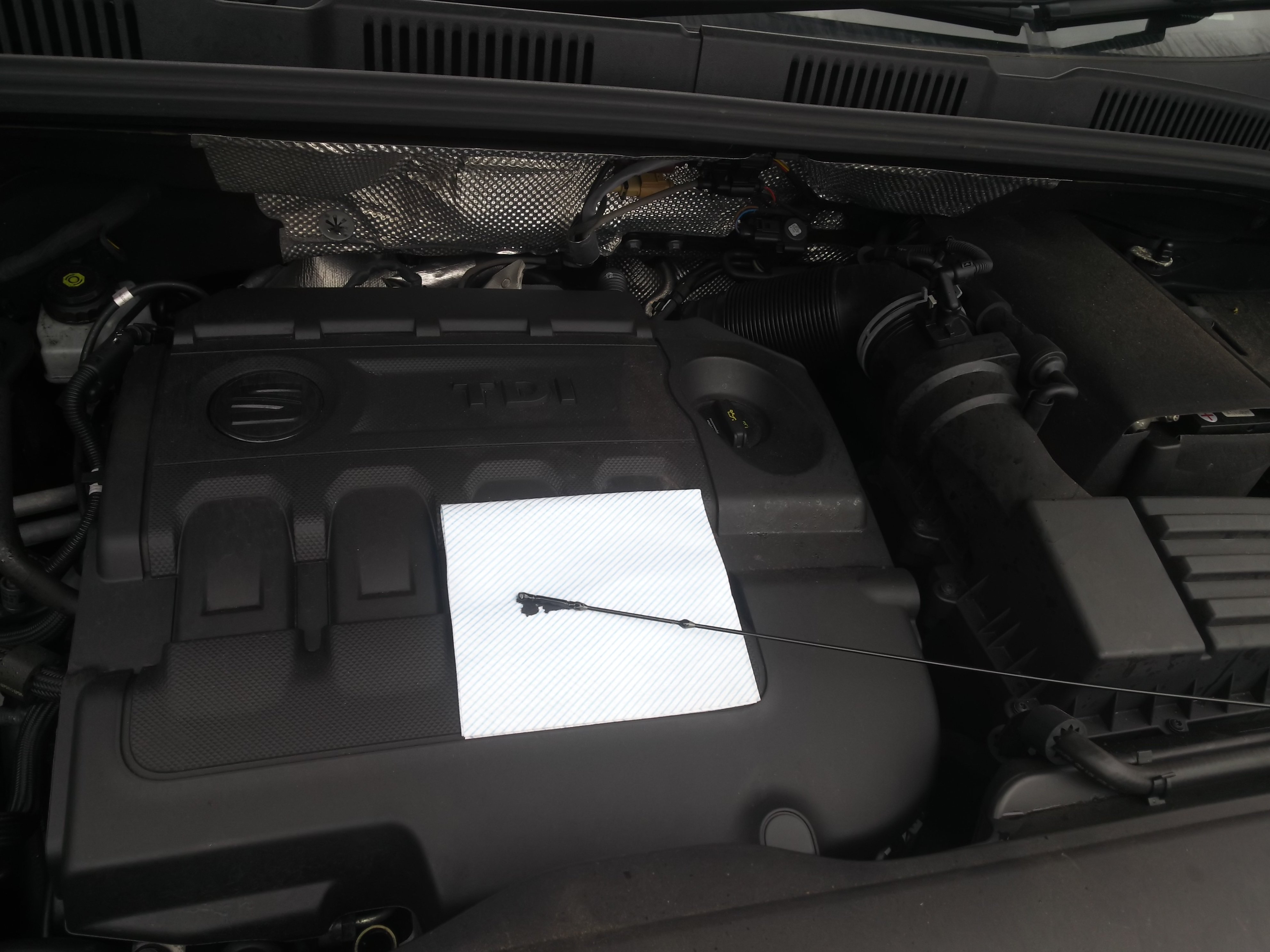

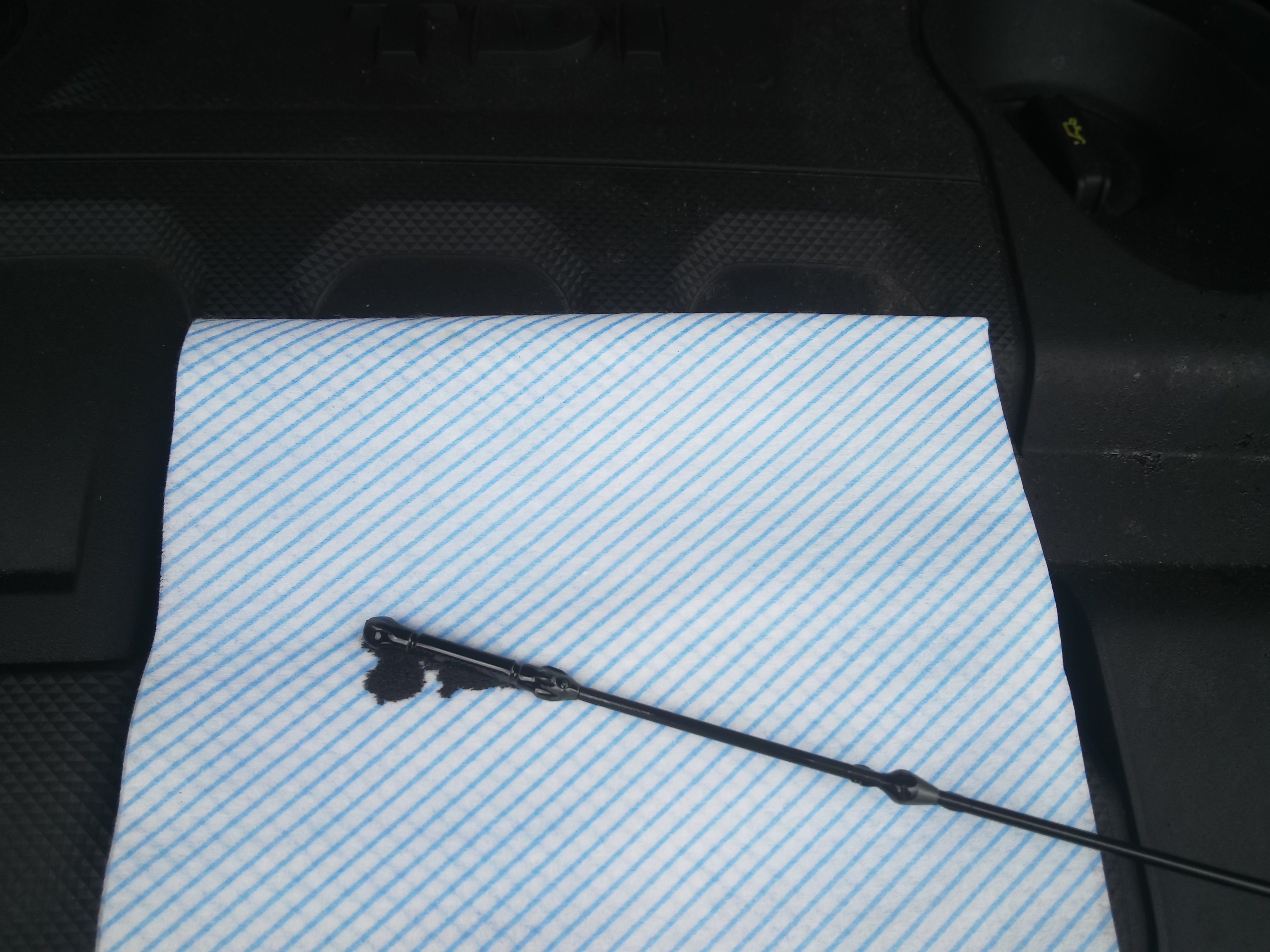

Better done than not done and using what you use for your nose or ar53 or J-cloth copy things for washing dishes seems preferable to nice clean cloths even if 5 for 99 pence.
