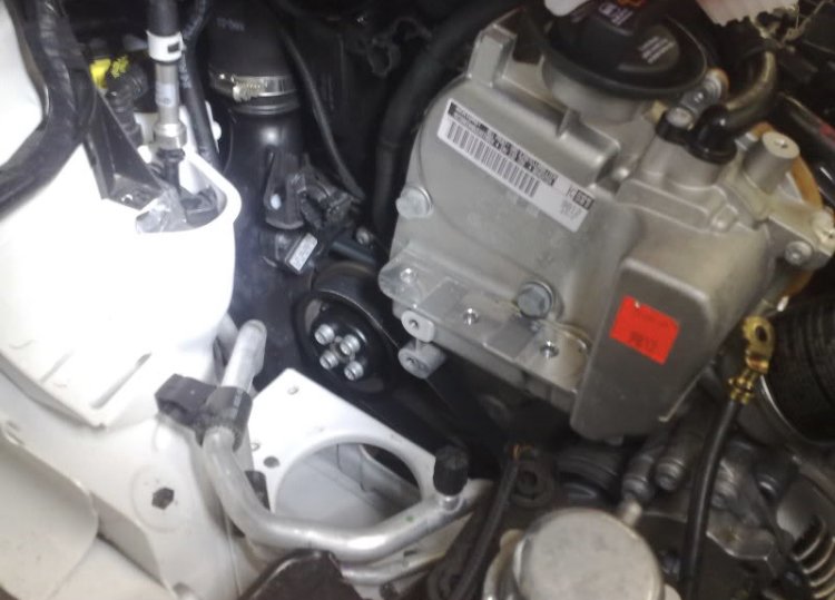

The Water Pump has the Supercharger magnetic clutch, 2 rubber belts to change.
That is Drivers side of a right hand drive car.

The water pump has failed - bearings they think.
They are going to replace it mid next week.
It is going to be expensive.  DAMN!
