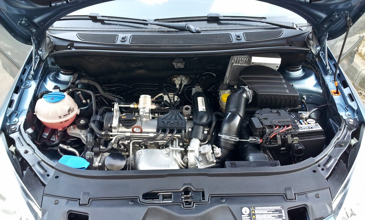

Those leads are replacement upgraded leads, original ones fitted didn't have the corrugated trunking. Although I note someone has modified them by cutting the trunking so they can clip the leads to the old small clips rather than fit new larger clips. Hope they didnt damage leads in the process. And not neatly arranged at the coil end as is normal, see pic. Very dirty around lead carrier, not great for ignition leads.
So I called Evans halshaw, expressed my concerns, told to take the car down and they would arrange a courtesy car, on the drive there the stutter on acelleration  wasn't as  frequent but the cars been used today, even still doing it more on cold running I wouldn't think is normal, at time no technicians were available but I showed the chap on service desk. He actually mentioned the turbo/waste gate. But it's logged at least now so abit of peace of mind
When I bought it first thing I did was take it to shell and put fuel in. I never use supermarket fuels in my car, some people think thats a myth but I stand by it
But yeah xman I see what you mean about the leads, the lead at the back that just seems to be hanging in the air I thought was abit weird.

I also note that it has a Mann oil filter fitted, so last change was definitely not by a Skoda or VAG dealer (which is not necessarily bad, the Mann is a top OE quality filter).
Come to think of it, check it has had the turbo shim fitted. This vintage had a recall, and this could be the reason.
