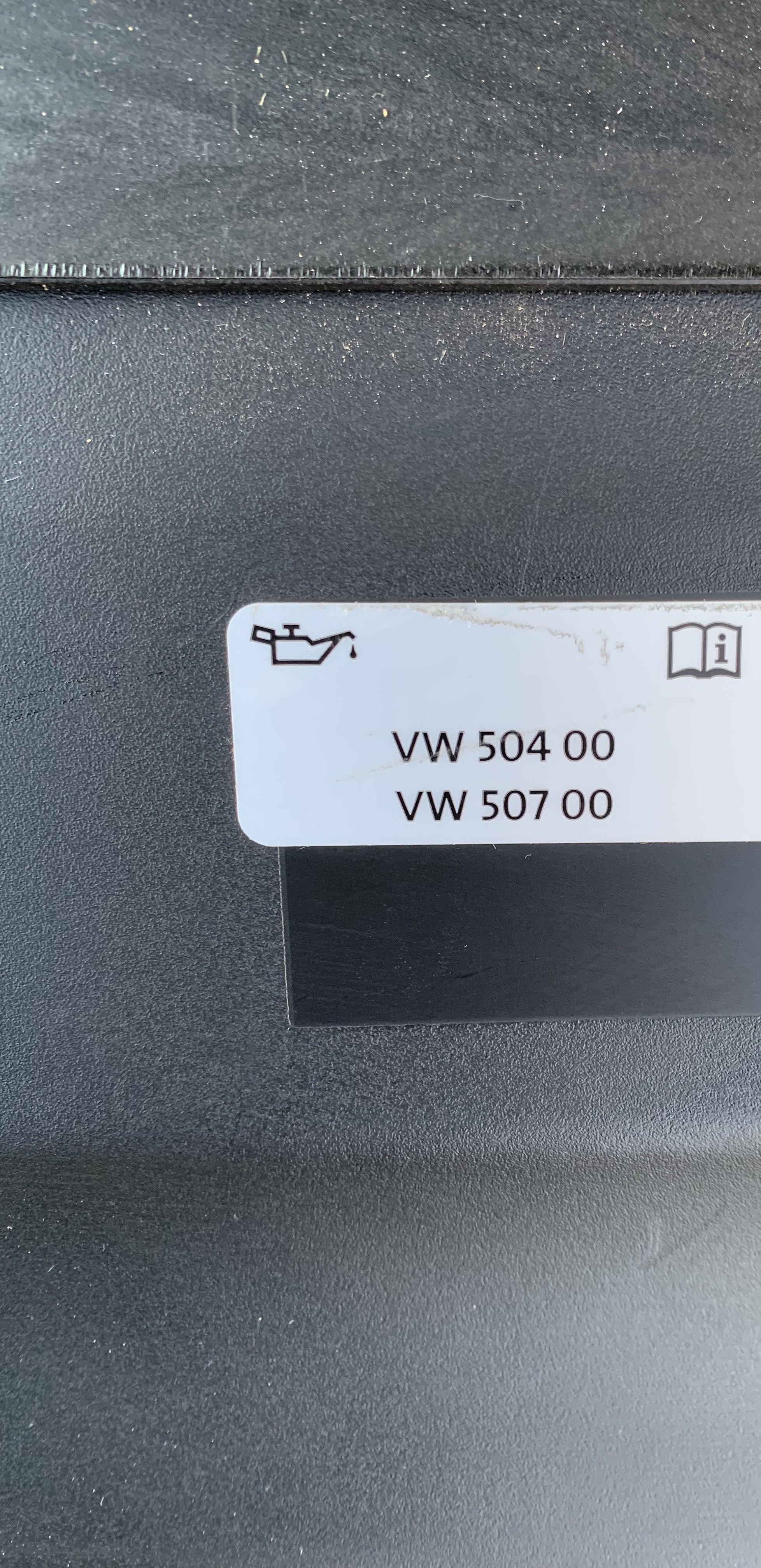

  • This was underneath the bonnet so I think I can safely assume the Quantum 5w30 will be suitable for topping up.
Good.

Nah it was built January. Spent 3 weeks at Emden that’s the longest it’s been sat around. Ordered some Quantum 5w30 (504/507 approved) hope that does the trick!

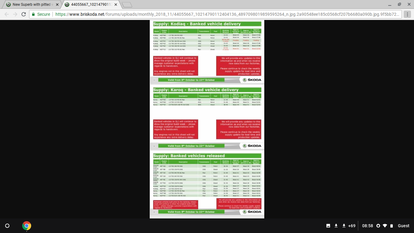

No i mean 'Banked' (Bunkered) as in Stored because they could not be First Registered after August 2019 when not WLTP Approved.

http://briskoda.net/forums/topic/458953-new-superb-with-pitted-windows-and-chromes
