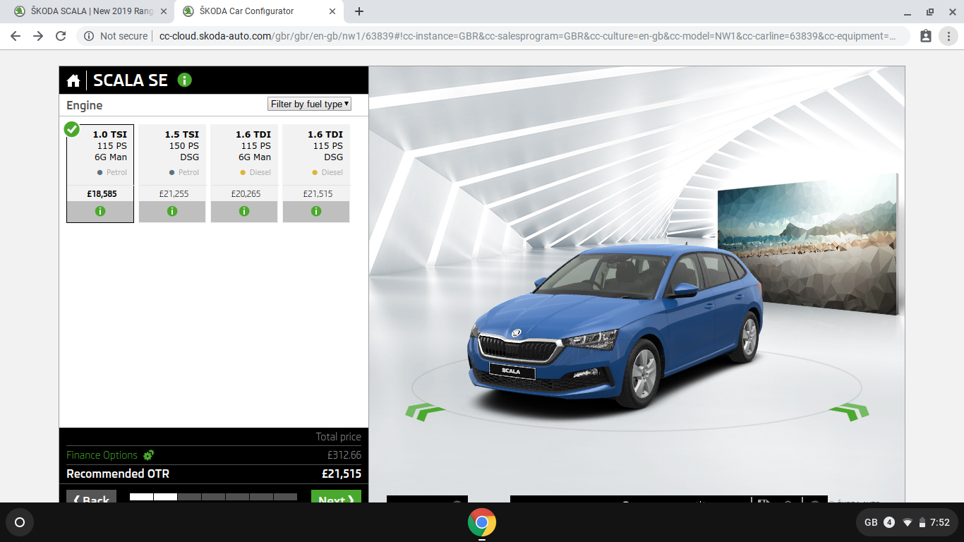

5 minutes ago, Skoffski said:
Do 2019 & even the 2020 1.6 TDI SCR 115ps fwd Karoq / Octavia not still have DQ200 7 speed twin dry clutch DSG's.
My understanding is that my 1.4 Superb does
Correct your 1.4 Superb is a TSI and does have a DQ200 DSG.
But then not a Diesel & a petrol with not more than 150ps / 250 Nm & not AWD..

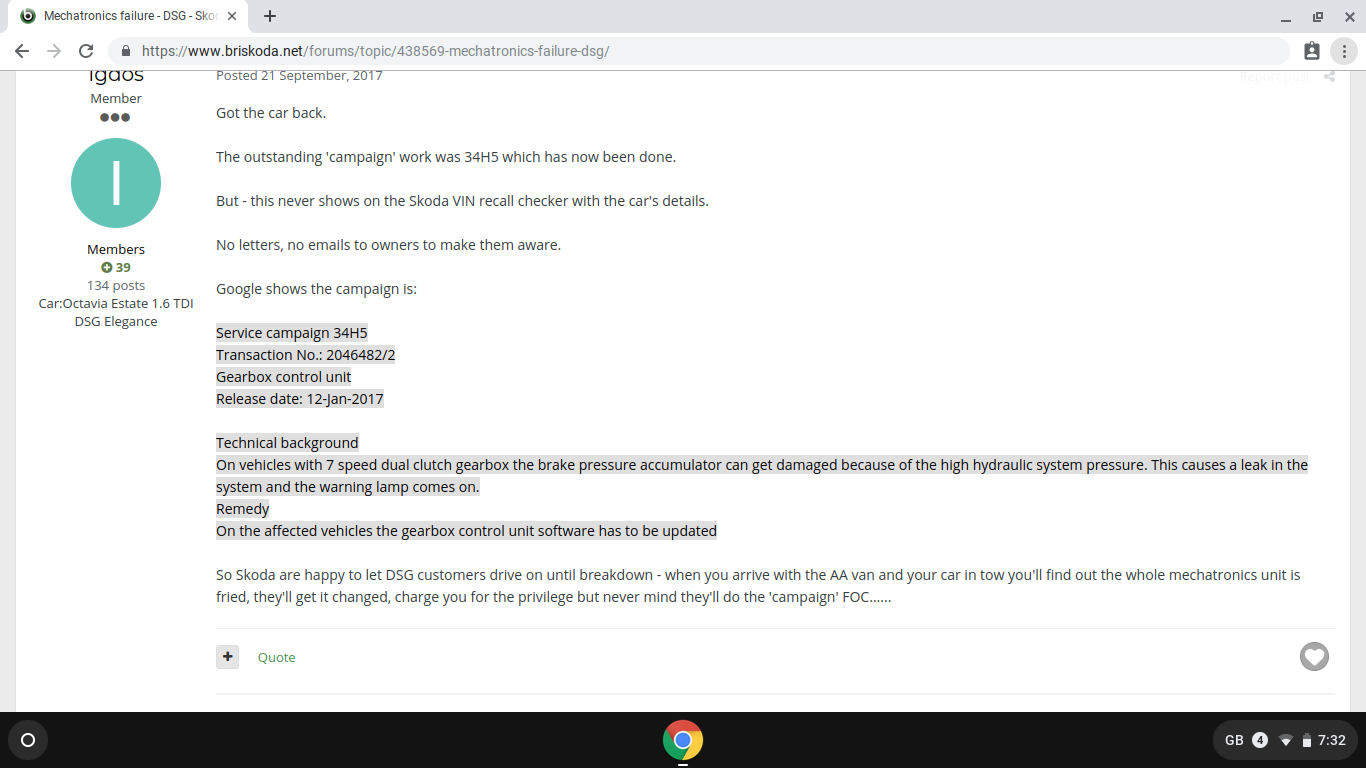

Should your car have had service campaign '34H5' or not, or has it had it carried out.
Skoda UK will always say they will not contribute as the first and sometimes 2nd response, but that does not mean they will not eventually, because they do.
Reason being as you said above.

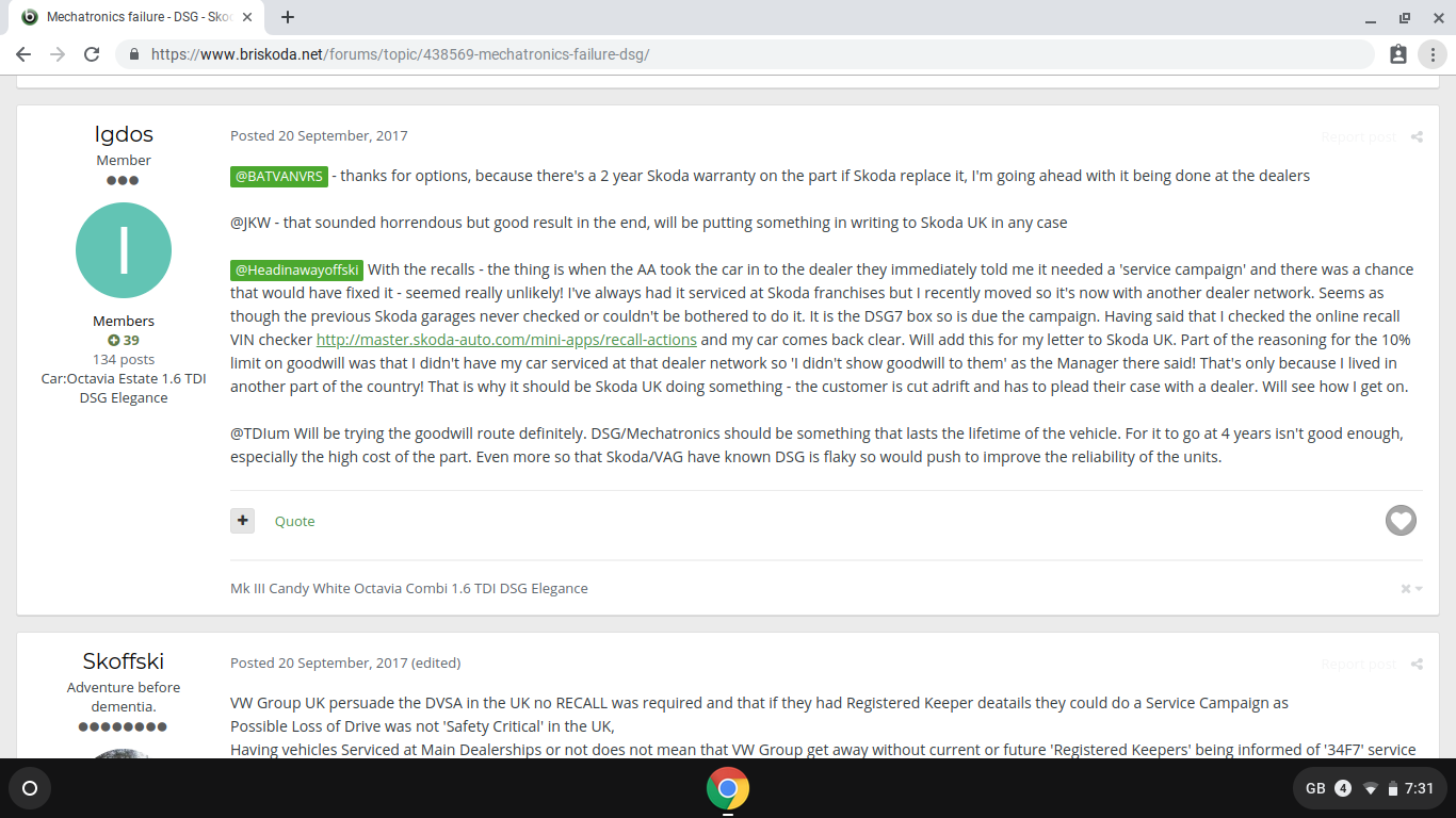

@Wiganyeti
I have never known the VIN checker to show '34H5' as being required even on cars needing that Service Campaign,
Not the old checker or the current one.
http://skoda-auto.com/services/recall-actions
It does show '34F7' on 2009-2012 DQ200's when outstanding sometimes, but can even show as not required when actually it is.
It needs to be a Dealership that checks or Skoda Customer Services.
Did you ask them to check?
