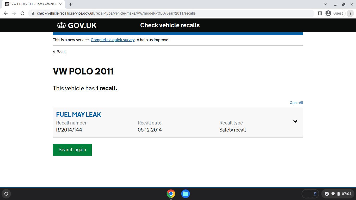

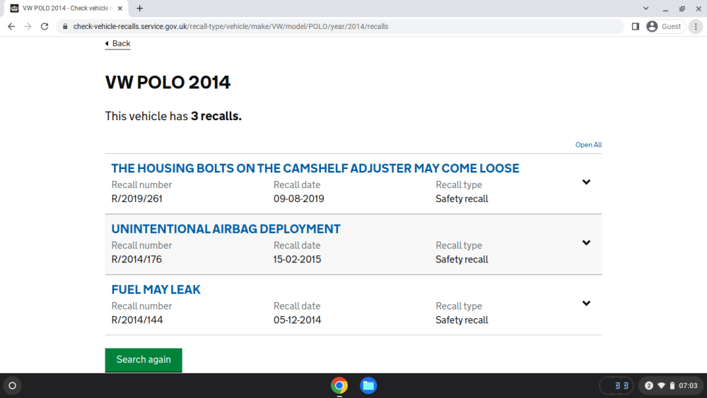

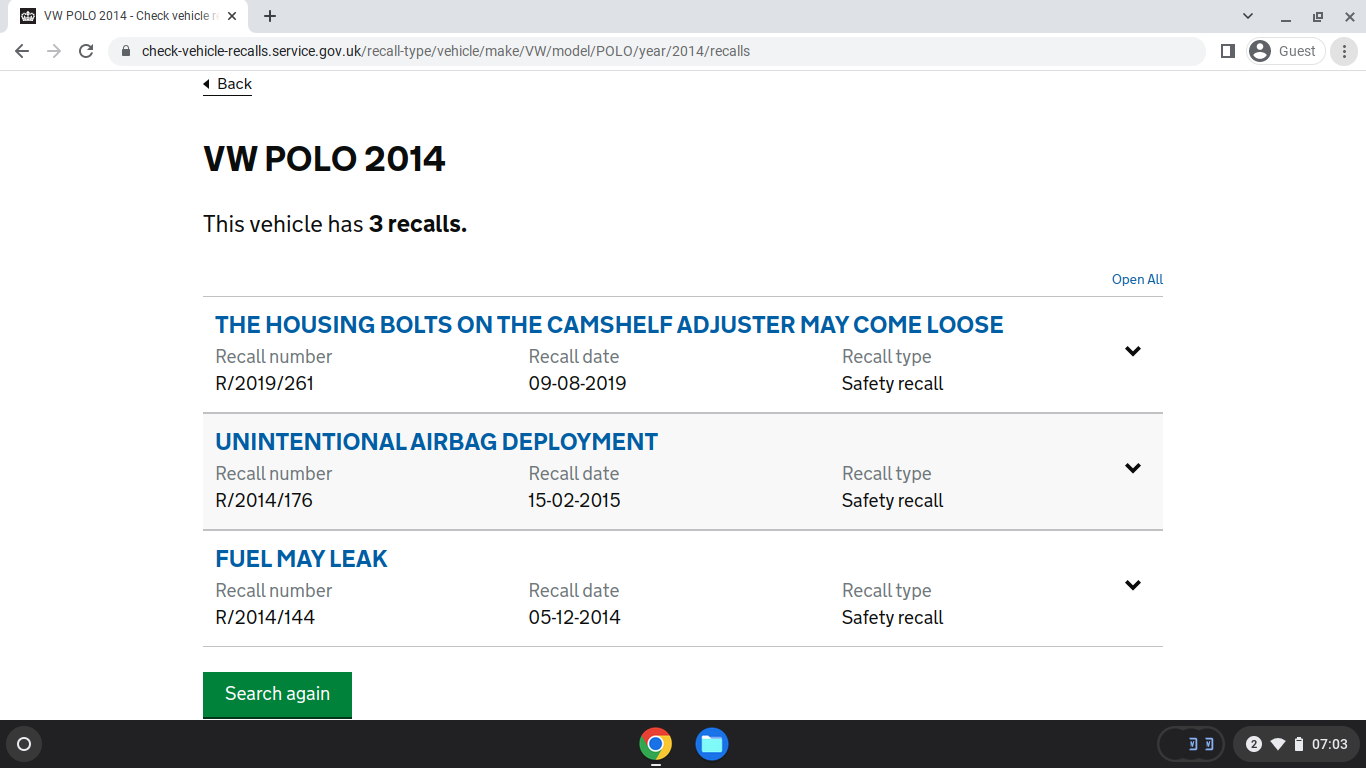

A 1.4 TSI from what year is it and in which VW car ?
Edited by toot

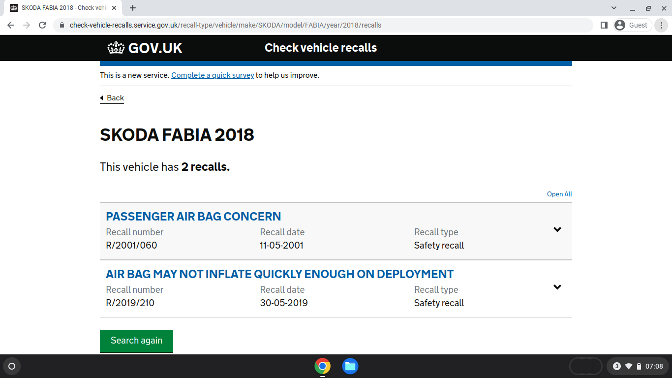

The car is 2018 and the garage identified the issue as a fuel leak due to loose fuel rail bolts.
@MrMan001
What VW Model from 2018 is your 1.4 TSI in & Is it just a TSI or a TSI ACT?
Skoda never fitted them to mk3 Fabia's.    (Other than the limited run of 1.4 TSI 125ps  R5 Tributes.)
Euro 6 1.4 TSI,s were in other Skoda Models as TSI's or TSI ACT's and are still used in the PHEV's.

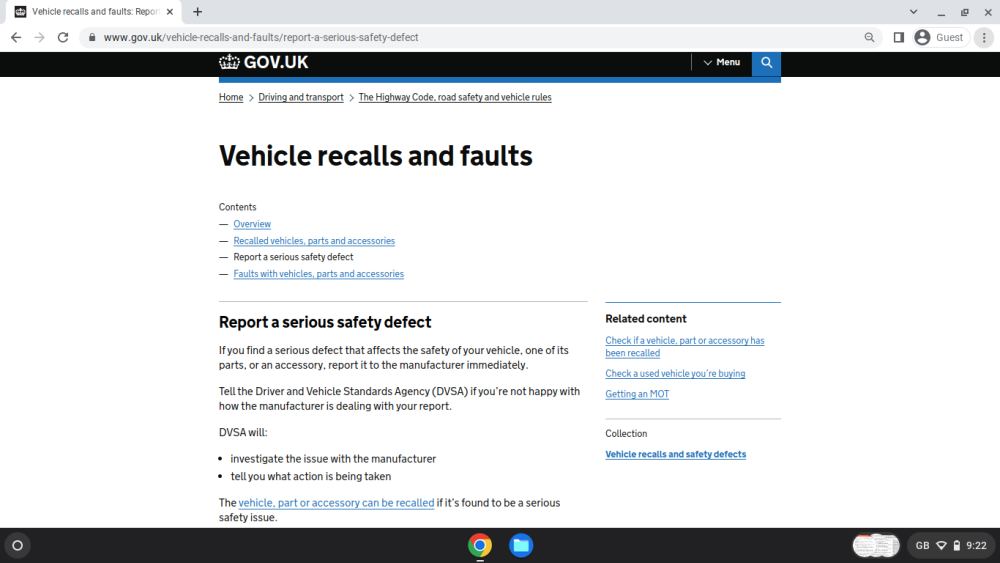

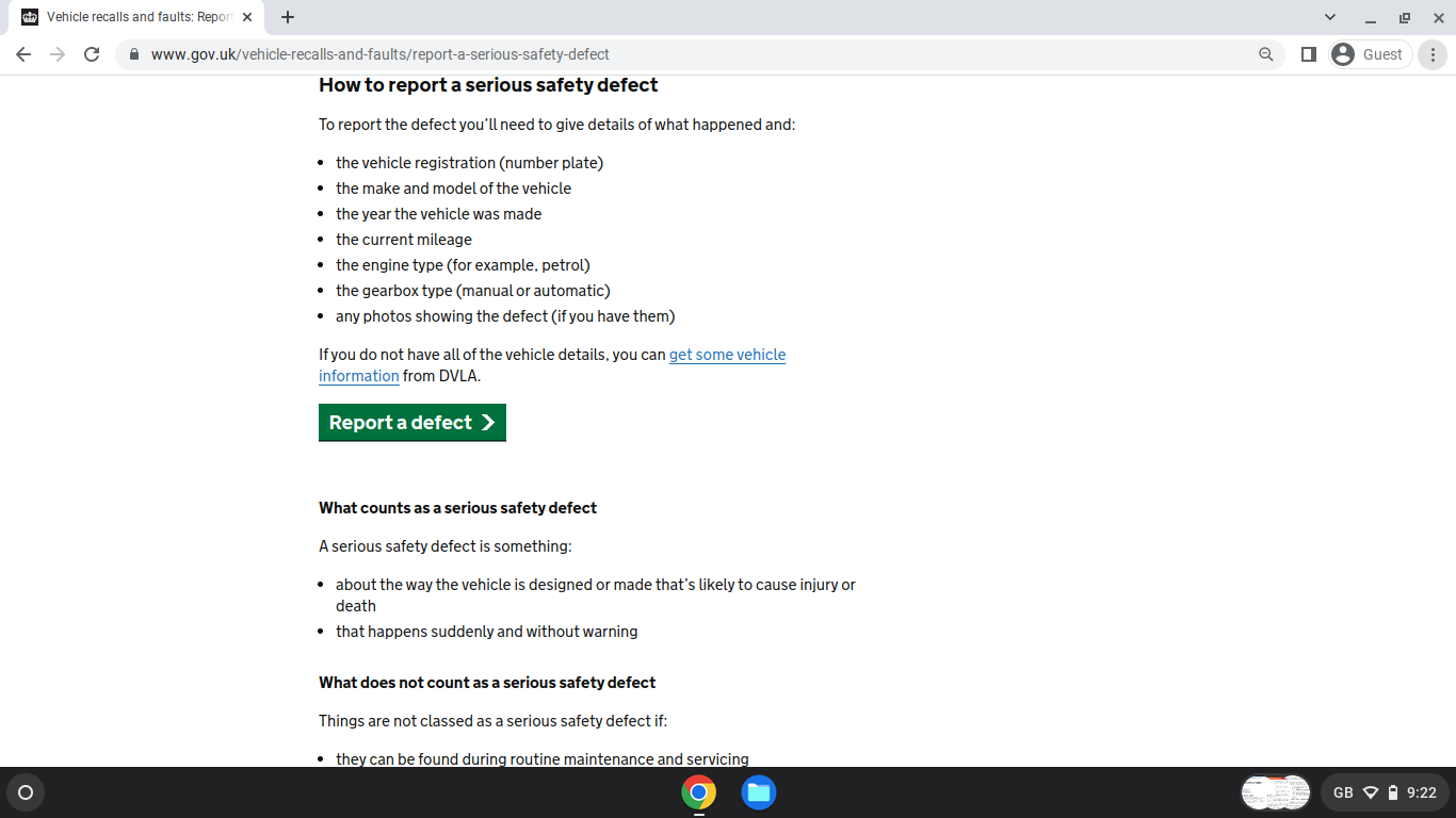

Have you checked with VW if there is a TPI on your vehicle or a DSVSA recall?

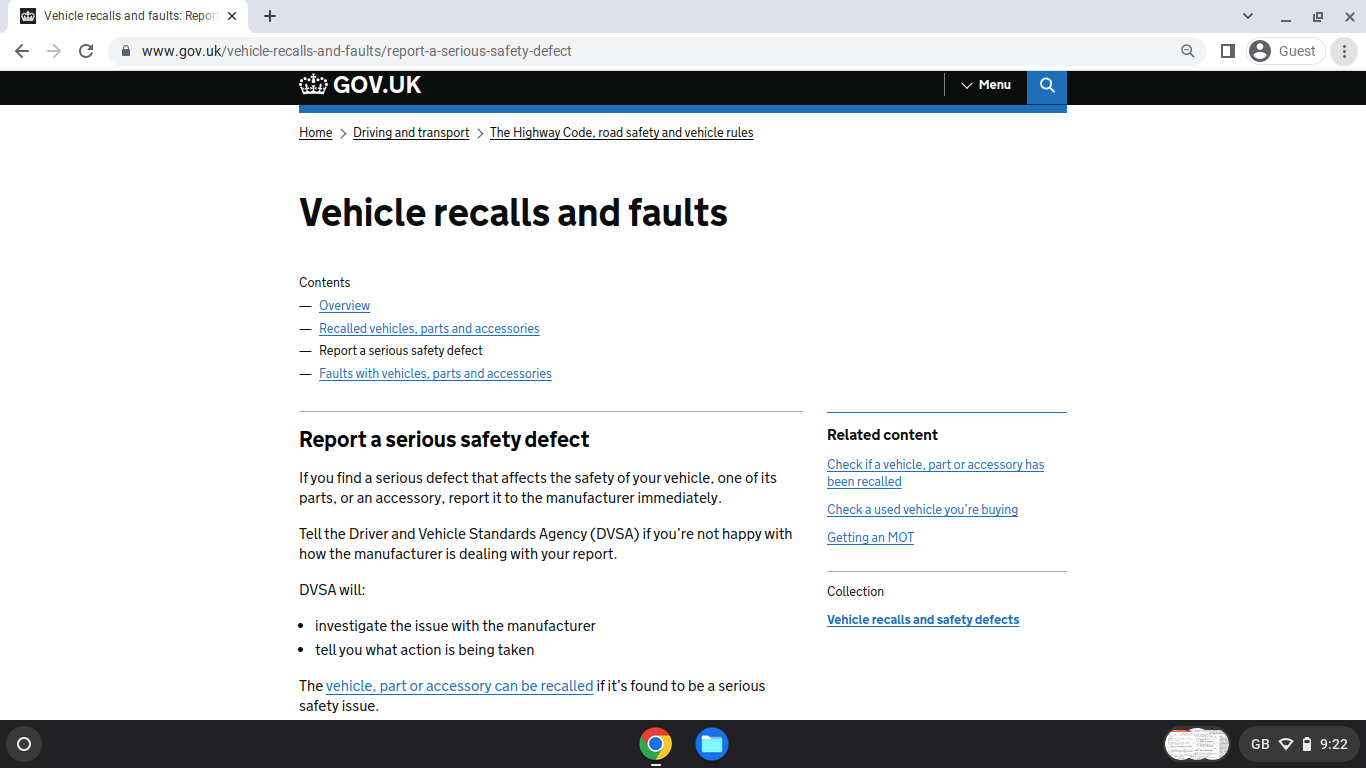

You can report concerns to the DVSA.
Edited by toot

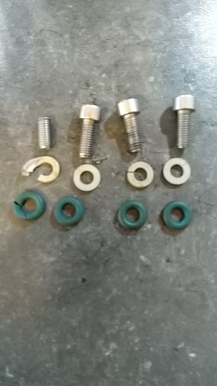

My Fabia 2016 1.2TSI 110 DSG also had a loose bolt to left side of fuel rail. I have inspected it during cambelt and water pump change. I have just replaced the bolts and locktite them also, just to be sure. It was around 160kkm on the milage of the car.
Good thing I have checked.
By the way, just take the cambelt and water pump to be changed at the dealer, because it is a right pain in the ass to do. It took me 8h to do both on jacks (I have no lift) and the amount of disassembly of the engine is quite high compared to official guides (in the guides the engine is usually out of the car :D and can be accessed easier). No need to use official tools, a white marker does the job quite good, just remember to mark the sprockets to block of engine and not only the belt, because the belt does not align after couple of turns when checking.
After this milage, the belt and pulleys were quite in good condition, but the water pump was a bit loose (free turning compared to new). I have also noticed some carbon buildup on the valves and will be likely take it to the dealer for cleaning later this year, since this is something, I cannot do on my own unfortunately.
