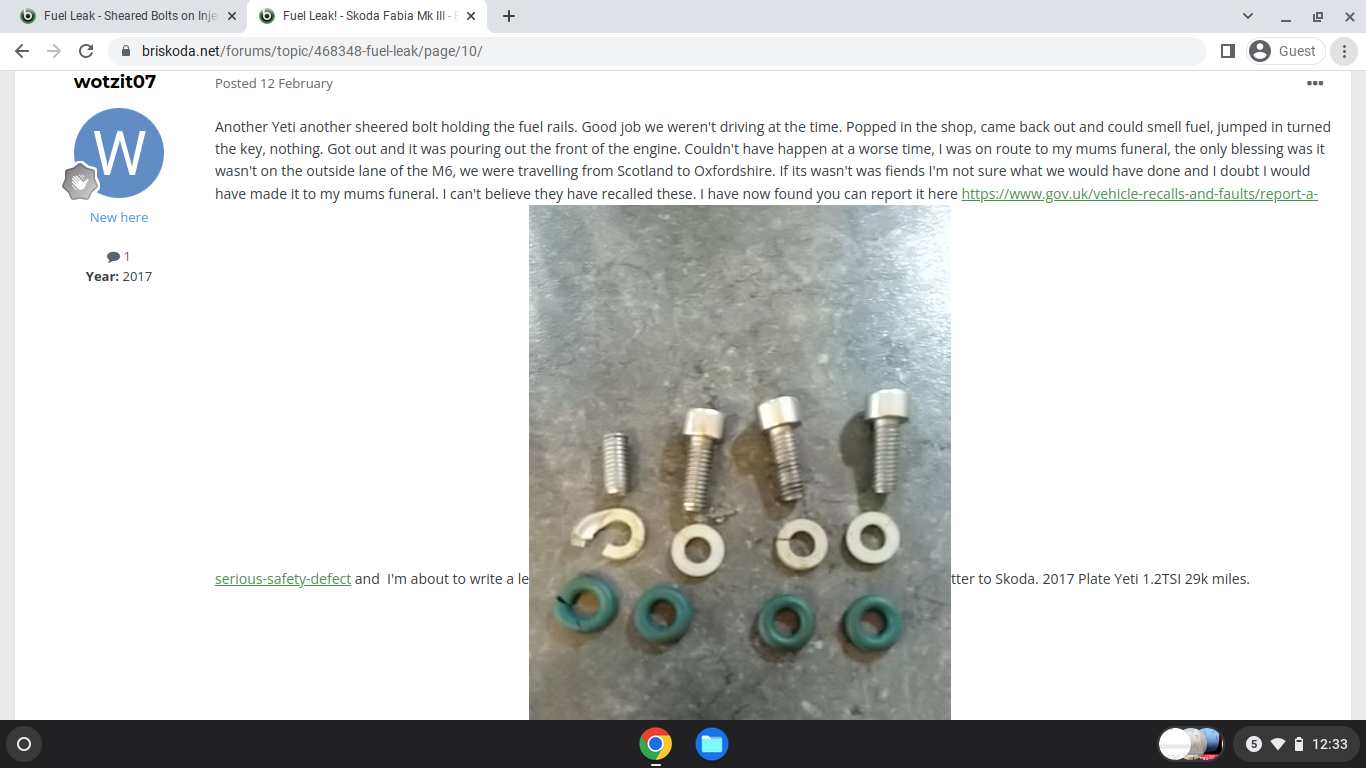

On the RAC attending they identified fuel leaking from injector 1. (They were taken by surprise when opening the drivers door caused petrol to squirt out - looks like opening the door primes the fuel circuit?) It's since gone to our local garage to investigate. I'd seen some reports on here of sheared bolts on the rail holding the injectors in place and subsequent leaking - which sounded similar.
On investigation, the garage have confirmed the same thing - loose and missing / sheared bolts - at least one of which they are having to drill out - and the seal on injectors 1 and 2 gone as a result.
