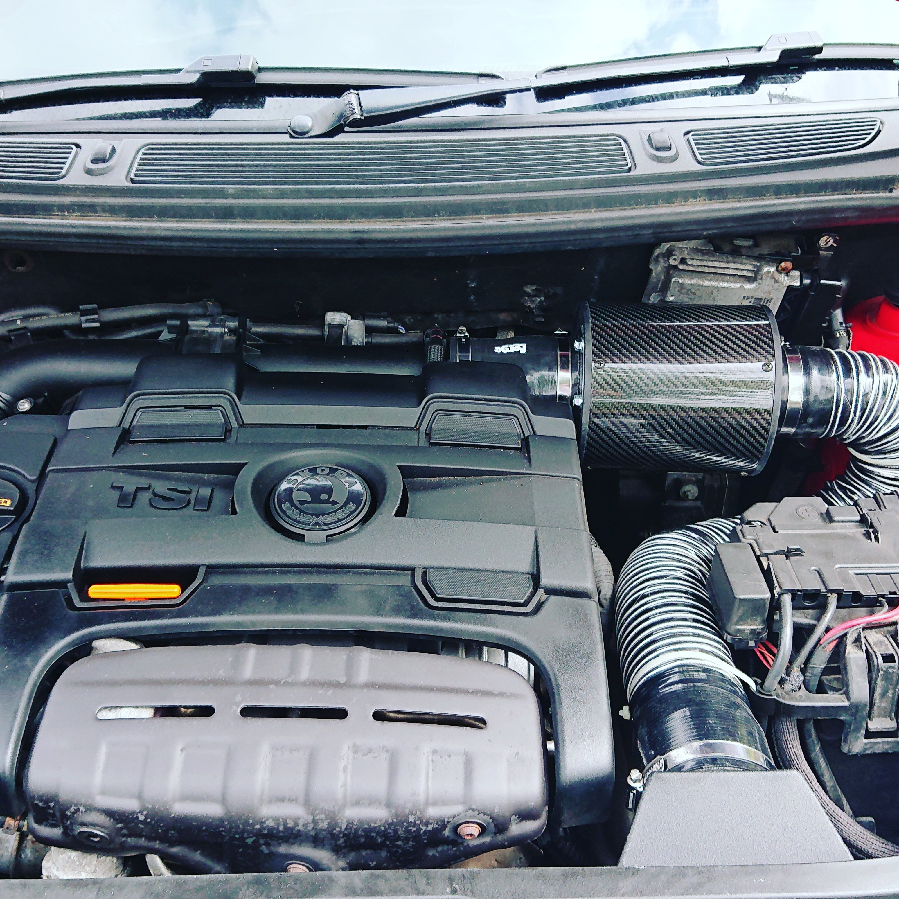

 Fitted on my fabia vrs, seams to spin up abit better we shall see when on rollers

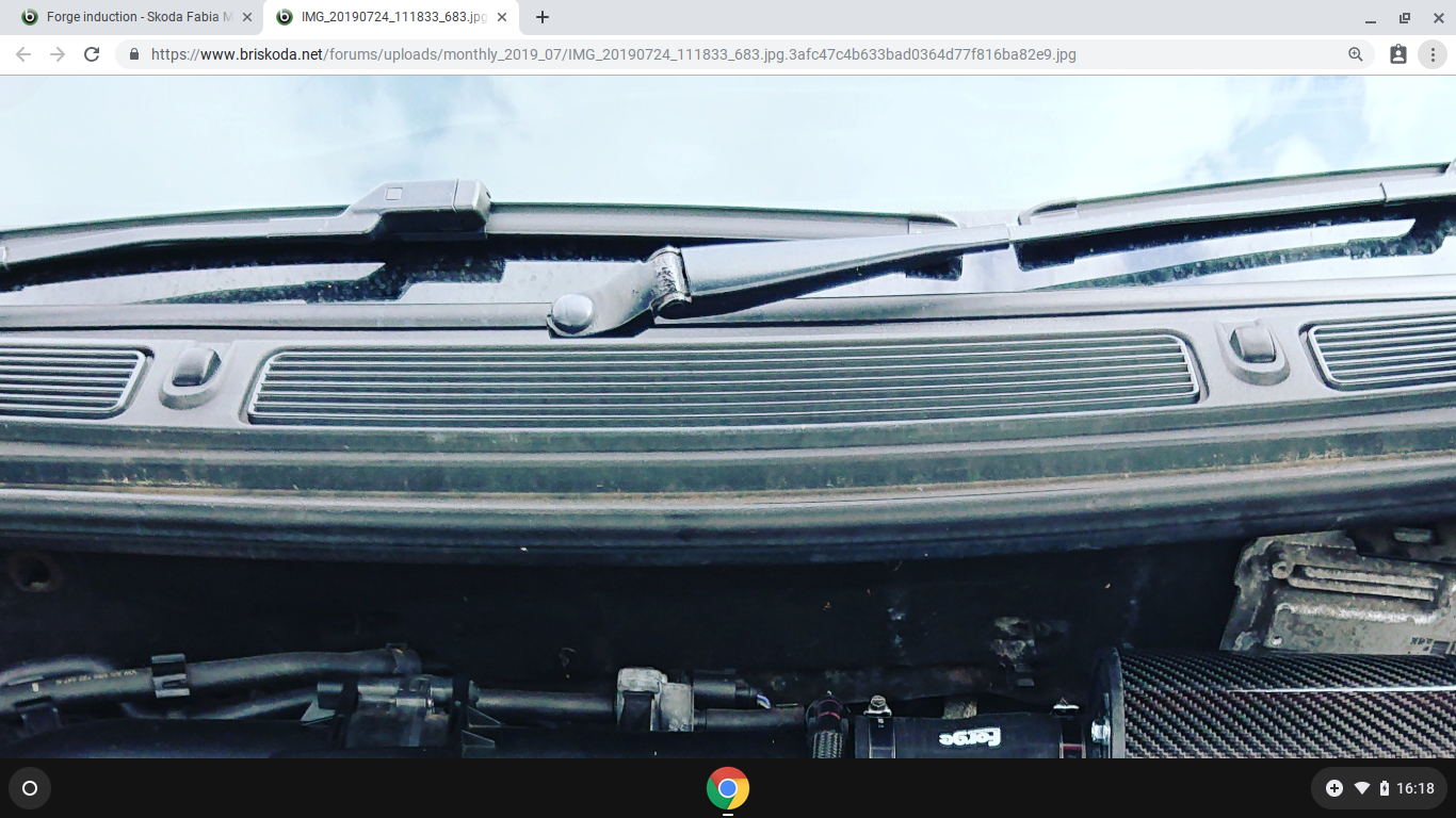

@Pirate76
Do think your car is running standard map or maybe remapped and that ECU has been opened?
Have you had it on a dyno before starting to mod?
Didn't bother putting on rollers when I got her wanted to make sure all was OK before power runs, there is a possibility she has a stage one map, had many modified cars in my time she's awfully quick if it's standard would make sense if she's running 215 to 225 bhp

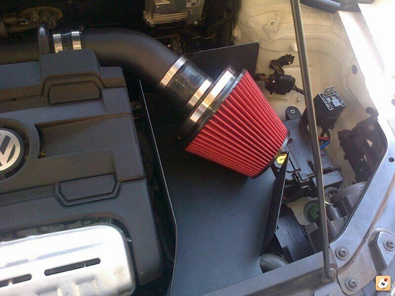

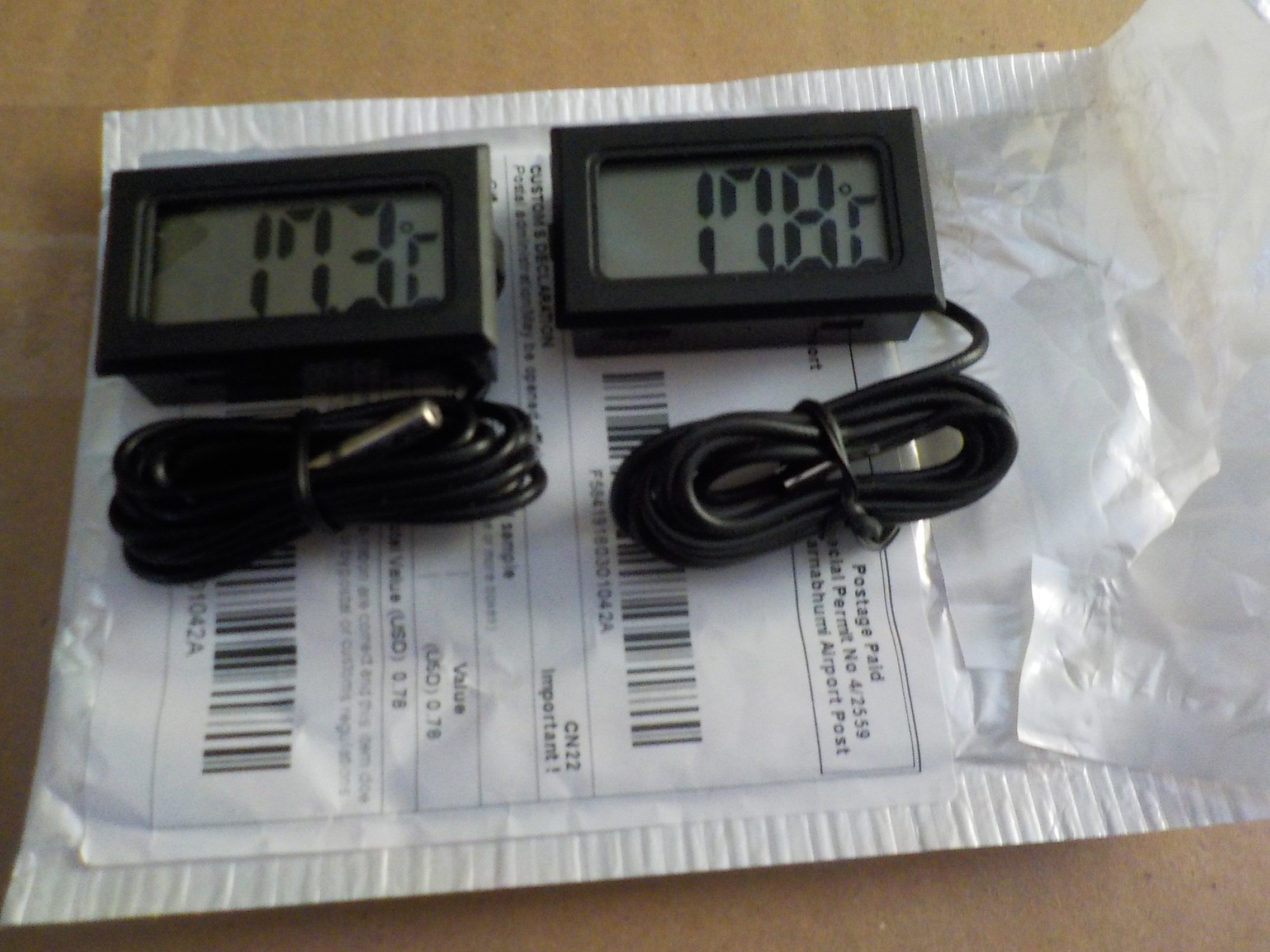

What can be an issue is just how hot the area behind the battery is.
I did checks years ago and there were threads. At about 26*oC ambient i was getting reading into the 50's c back there while driving.
Just be aware after spirited driving if really warm day and then sitting with the bonnet closed and direct sun or held up in traffic,
you soon know if heatsink is an issue.
http://briskoda.net/forums/topic/282048-induction-kit
£1.99 or so Digital Fridge Thermometers.  Dead handy.   For checking tyre heat as well.

Very interesting thanks buddy, can easily sort that if it shows up

There could be a few reasons why the bracket has been off.  Poor show it didn’t go back on properly though to keep it looking undisturbed.

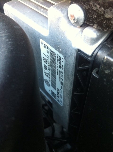

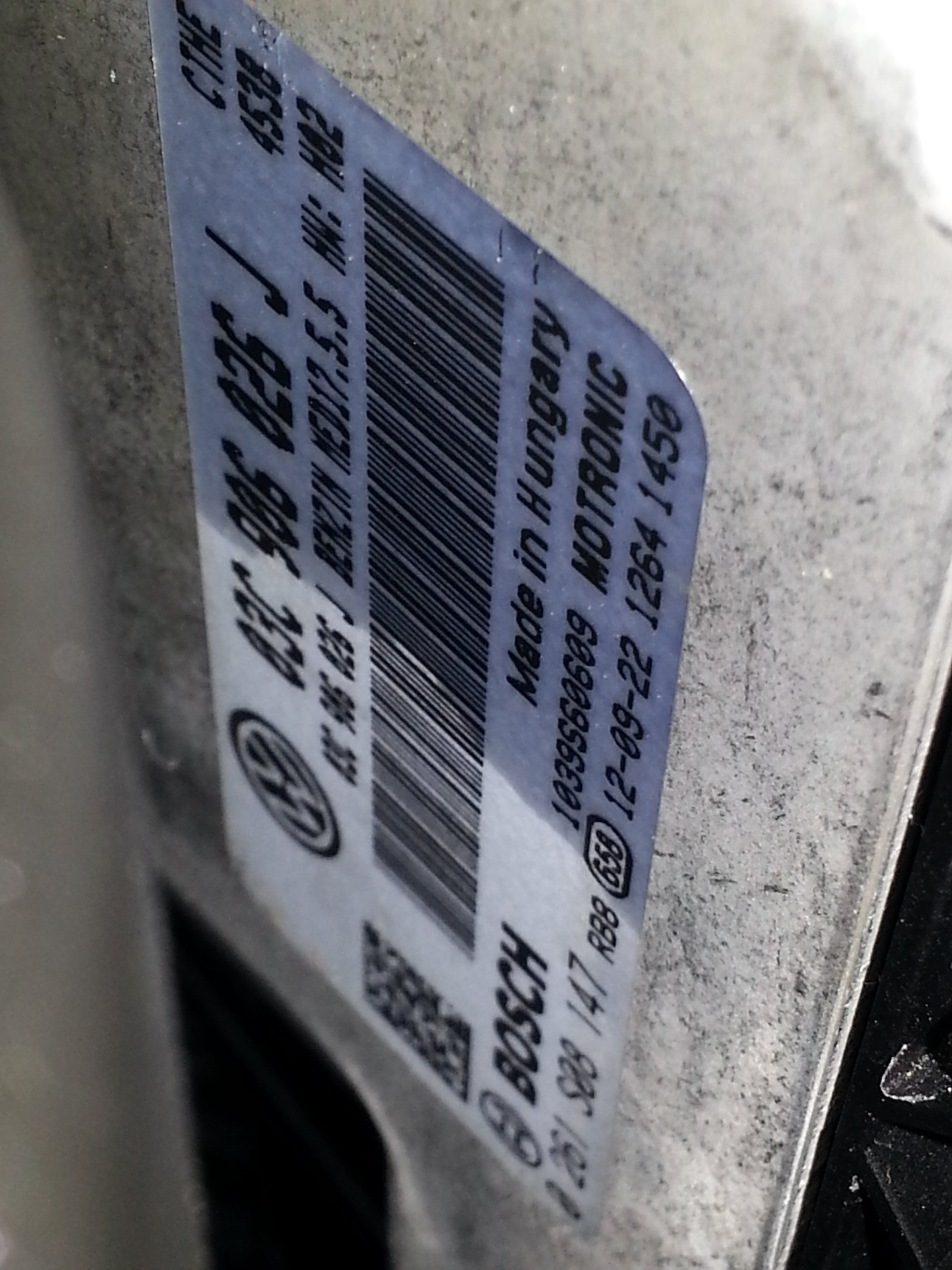

I had 2 ECU's for an early CAVE, and they had different maps.
Externally there are 4 different ECU's between CAVE & CTHE 2009-2014.
Then the Locked, not locked.
These are CTHE.

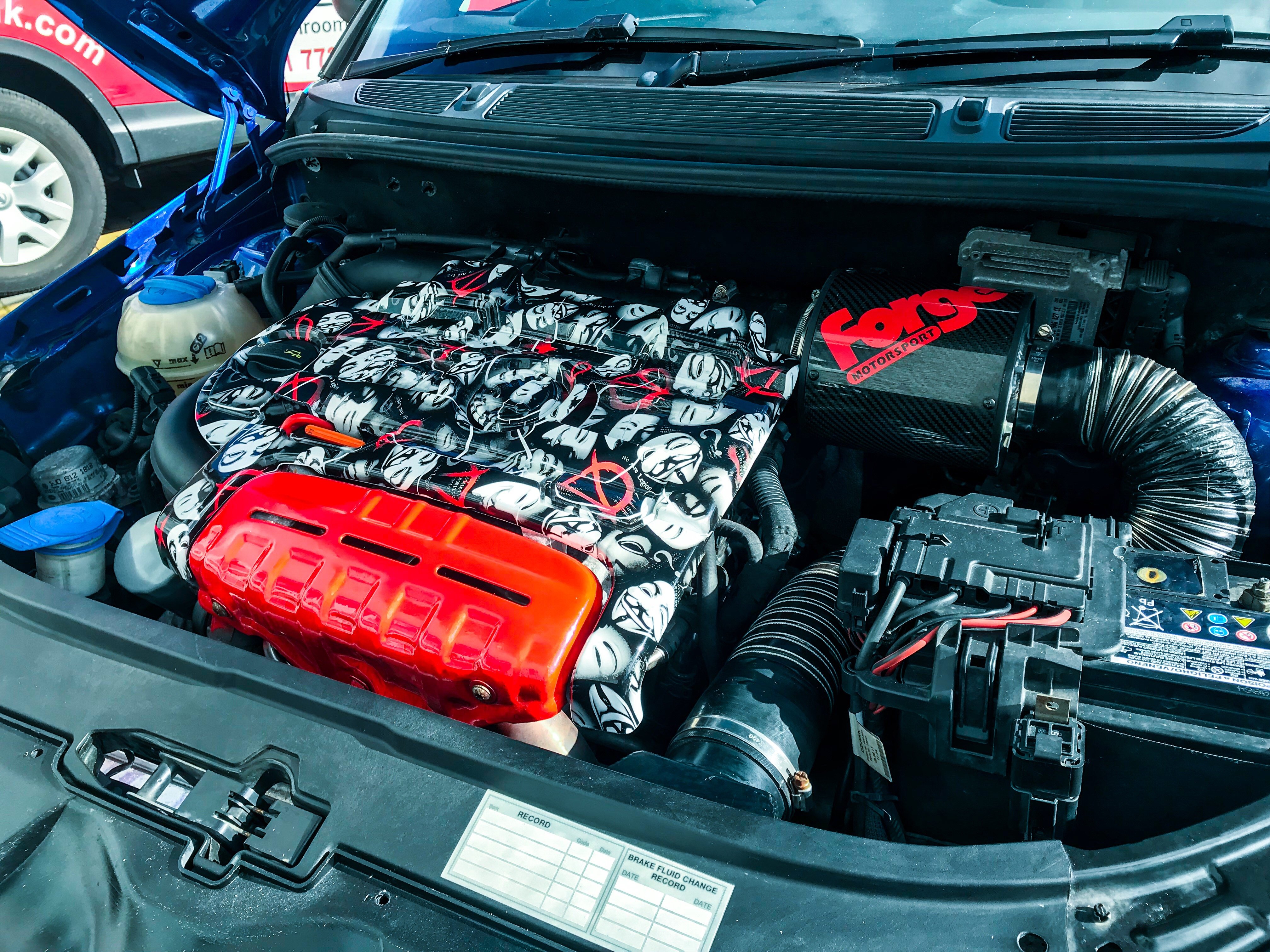

I've had mine about a year, I picked mine up cheap and cant fault it as a temporary until I get the RTMG intake, If your planning to keep I'd recommend buying the battery relocate, flip the filter to north/south tray and getting the air flow sorted properly as that standard snaking air intake forge provide(mine is like yours) is awful IMO.

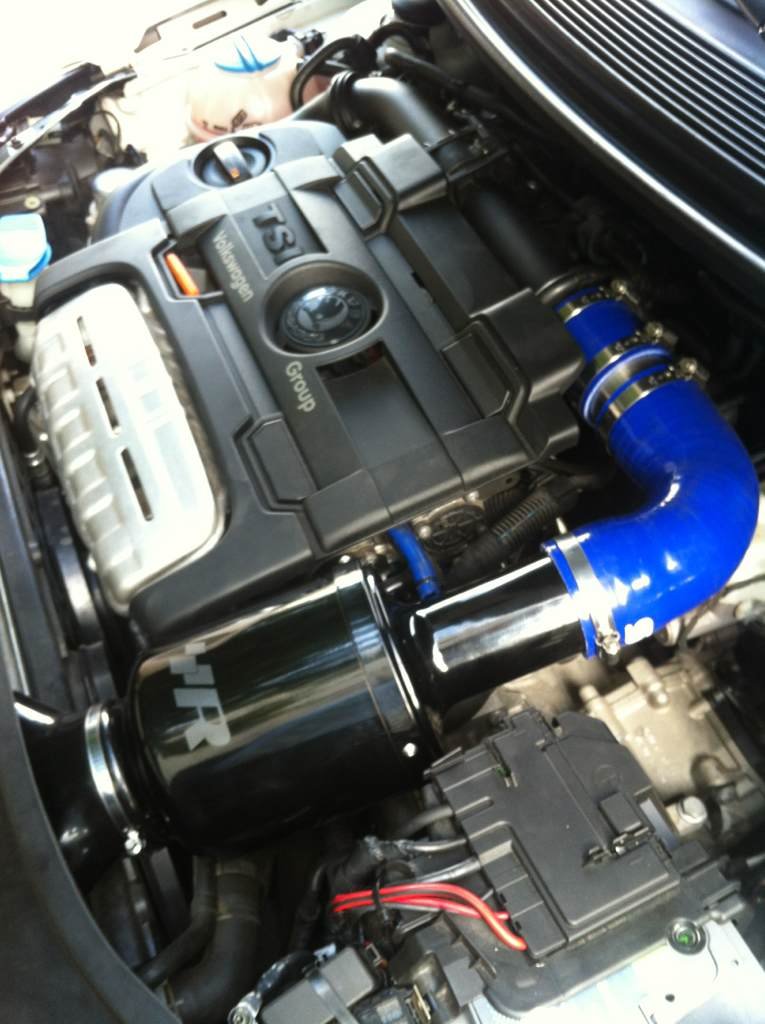

Battery to the boot as the Polo GTI is a good thing, and take the 'Success Ballast' off the rear crash bar of Hatchbacks.
