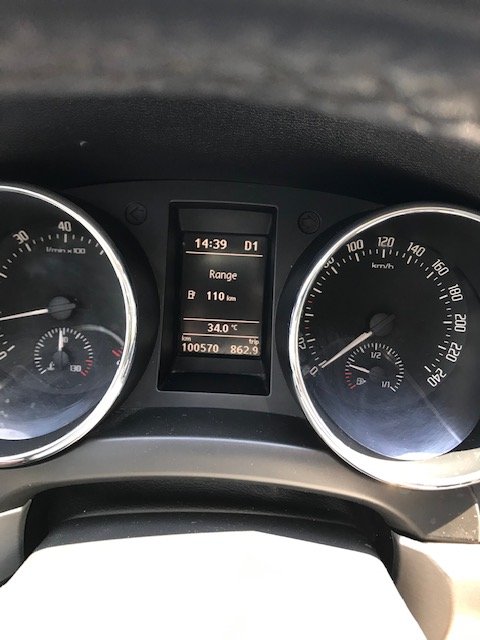

I have Yeti 2012(April) with 100k KM, and for some reason after 10-15mins of driving in D drive i do see on the dashboard where the KM is seeing, an icon of screwdriver switching between D1, D2, D3 etc to the screwdriver icon,
Attached are the pics,
Any reason for this?
Please advise.

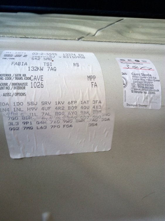

In the spare tyre well there should be a sticker showing what if any Service Campaigns have been done.
'34F7'  or '34H5'.
There are some that never needed or got either, there are 2012 DSG's that Skoda / VW said did not need these,  this is the White Spanner flashing ones when faulty in my experience.
Ask a Skoda Dealer or Skoda Customer Services to check your cars VIN / Registration.

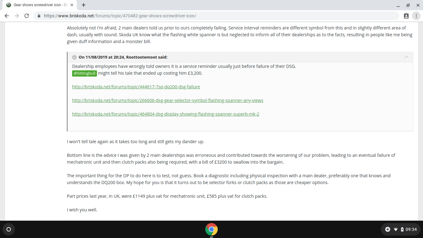

Unfortunately the flashing white spanner is alerting you to a DSG problem, a proper diagnostic including physical inspection will confirm this. With ours it was to notify us the internal pump within the mechatronic unit was leaking fluid and losing pressure, eventually leading to a car that was immovable as it couldn't select gears due to complete lack of pressure to operate clutches.
55 minutes ago, Urrell said:
Is it not just a service reminder, what does the service info say on the Maxidot?
Absolutely not I'm afraid, 2 main dealers told us prior to ours completely failing. Service interval reminders are different symbol from this and in slightly different area of dash, usually with sound. Skoda UK know what the flashing white spanner is but neglected to inform all of their dealerships as to the facts, resulting in people like me being given duff information and a monster bill.
20 minutes ago, Roottootemoot said:
Dealership employees have wrongly told owners it is a service reminder usually just before failure of their DSG.
@Sittingbull might tell his tale that ended up costing him £3,200.
http://briskoda.net/forums/topic/444617-7sp-dq200-dsg-failure
http://briskoda.net/forums/topic/266606-dsg-gear-selector-symbol-flashing-spanner-any-views
http://briskoda.net/forums/topic/464804-dsg-display-showing-flashing-spanner-superb-mk-2
I won't tell tale again as it takes too long and still gets my dander up.
Bottom line is the advice I was given by 2 main dealerships was erroneous and contributed towards the worsening of our problem, leading to an eventual failure of mechatronic unit and then clutch packs also being required, with a bill of £3200 to swallow into the bargain.
The important thing for the OP to do here is to test, not guess. Book a diagnostic including physical inspection with a main dealer, preferably one that knows and understands the DQ200 box. My hope for you is that it turns out to be selector forks or clutch packs as those are cheaper options.
Part prices last year, in UK, were £1149 plus vat for mechatronic unit, £585 plus vat for clutch packs.
I wish you well.
