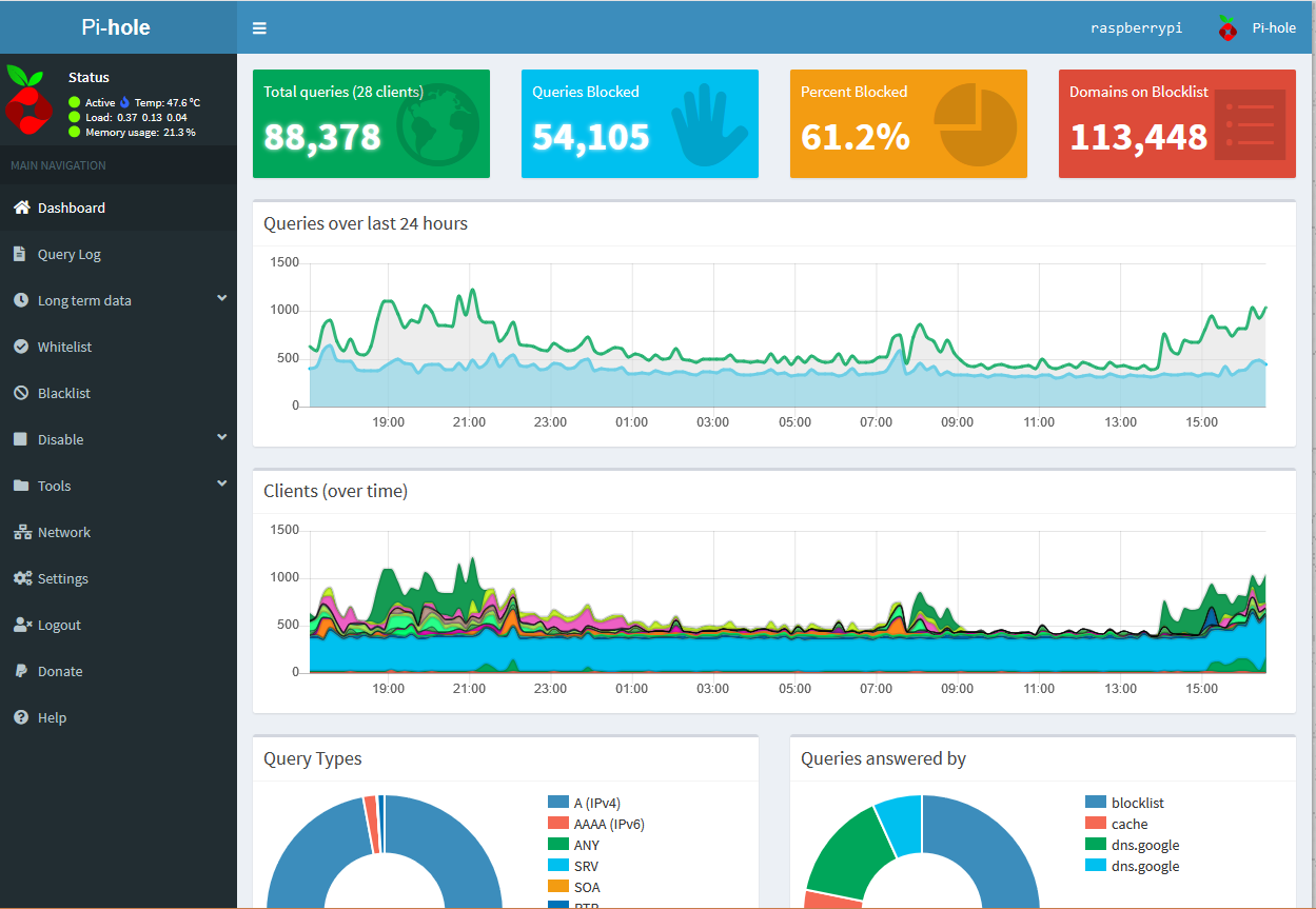

If you have a bit of technical know-how and a Raspberry Pi 2 or newer (the two go hand in hand really), look up Pi-Hole and never have an advert or tracker on your entire home network ever again. It really speeds up browsing too! :)

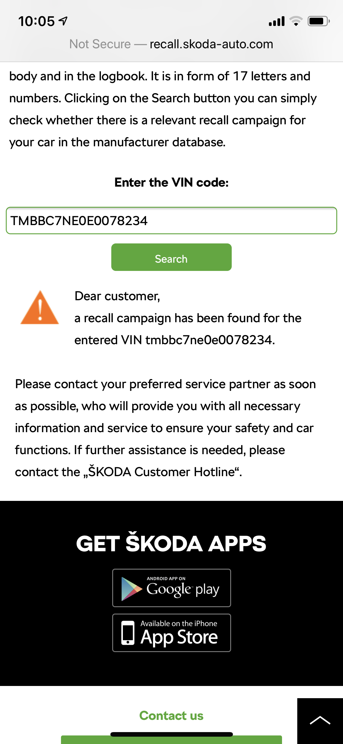

The plot thickens! When they called they specifically said it was to do with DSG and that the car required a software update. Car first registered end of October 2013.
@gonzolagonda
Service Campaign '34H5' has not being showing on the VIN checker the public can use.  That has been from early 2017- late 2019.
Does your VIN show on it now?   Or still not show, yet shows on the dealership network!!
http://skoda-auto.com/services/recall-actions
Curioser and curioser!
Just phoned Skoda UK and indeed it is Service Campaign 34H5, so Murray VW were correct in that it is a DSG/pressure accumulator check, with a software update if needed.
