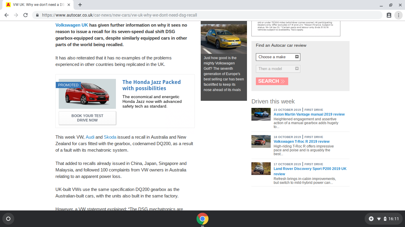

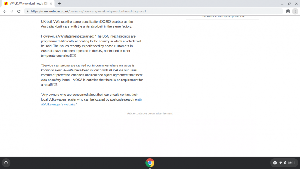

Pity Autocar / What Car / Piston heads / Haymarket Media Group friend to VW never appologised and corrected this & did the same size of article  when a Service Campaign had to be started in Europe / UK.
But that is how it is, Honest John or Bob Flavin have to tell it like it is sometimes, as VW Advertising is big money....

I thought I'd ollow up this matter a bit more out of interest.  Googling links suggests that the DG200 upto 2016 was the most problematic.  The ECU may be one of the problems - there are firms that can rebuild them for you at rather lower cost than a new unit from VAG.  E.g.
https://www.ecutesting.com/common-faults/volkswagen/volkswagen-golf-audi-a3-dsg-7-gearbox-problem/
Here they say the synthetic oil used caused a problem until they changed to mineral oil + other issues.  Berisford, the advice to put it into neutral at traffic lights etc reappears , for what it's worth, but I'm inclined to believe you.  They do go on to praise the DSG however.

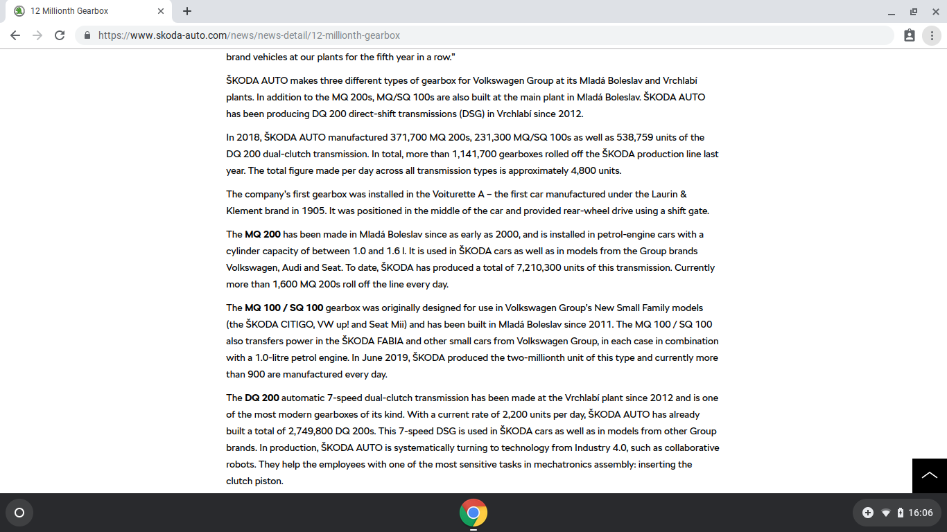

SKODA build 2,200 DQ200 DSG a day, have them for 28 applications,
have built millions.
