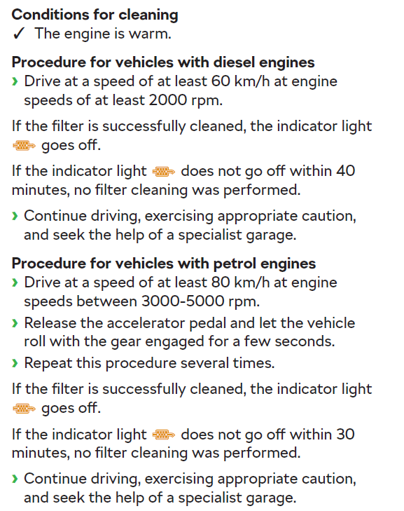

Drivers / Owners might never have an issue, but if they do have and ask at a Garage / Dealership it is good if the Sales Staff, Service Staff and especially the Workshop Staff and Professionals know what the procedures are that are in a Owners Manual and hopefully part of the Technicians training and knowledge.
No point just saying there is nothing to worry about GPF's will have not issues or warning likes show if there is one on the car showing and the driver can not find the section in the owners manual.
