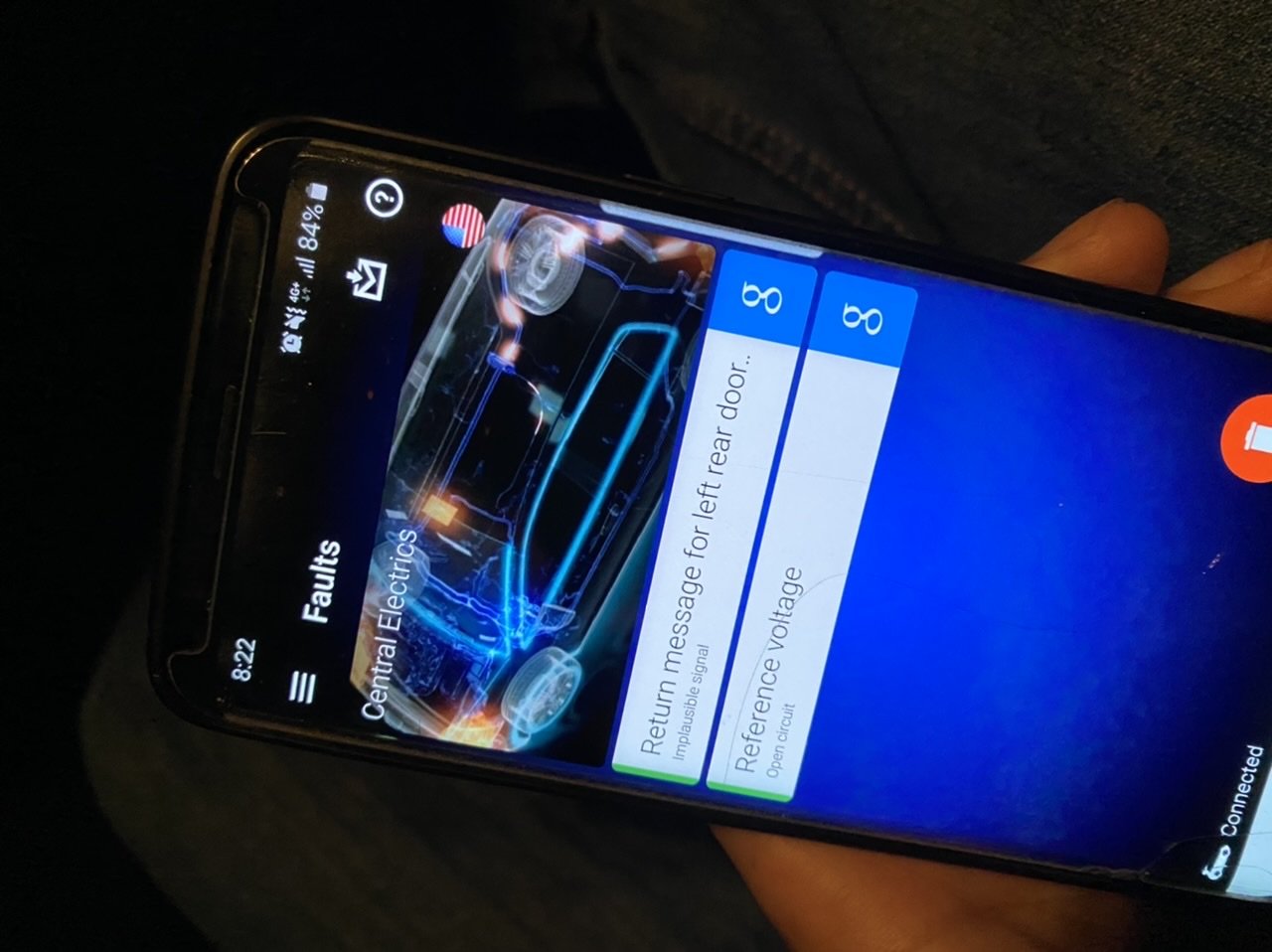

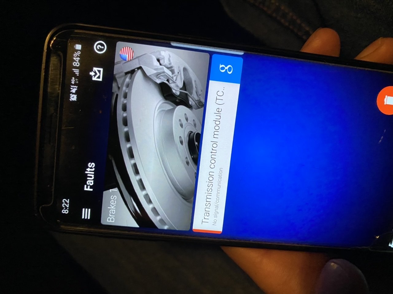

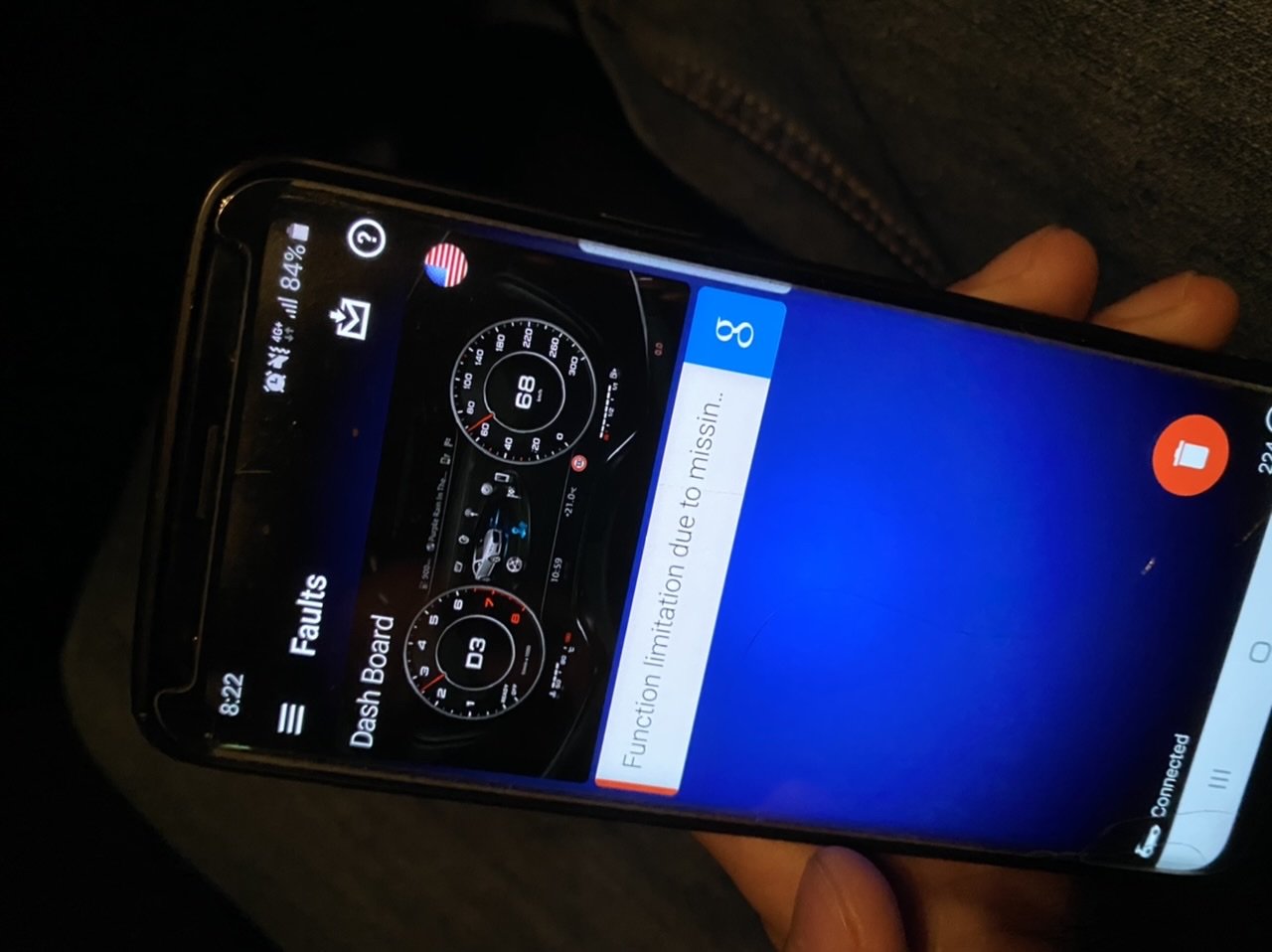

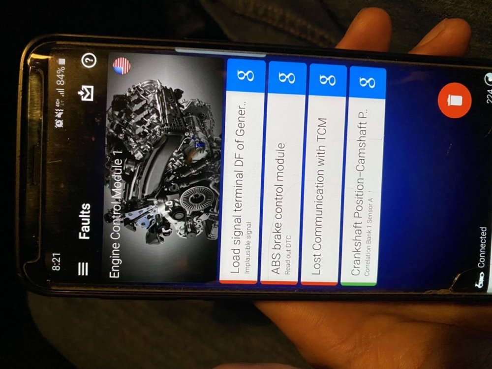

Got an computer to check it yesterday getting all sorts of codes
After checking the fuses
the control unit for automatic gearbox 5 AMPS was blown changed it now the car starts and drives
however when i put it into sports regardless of putting my foot down it cuts out after 10-30 seconds replacing s on its own without a gear selected.
looking at the codes looks like i have a faulty altenator however not sure if thats actually causing it....

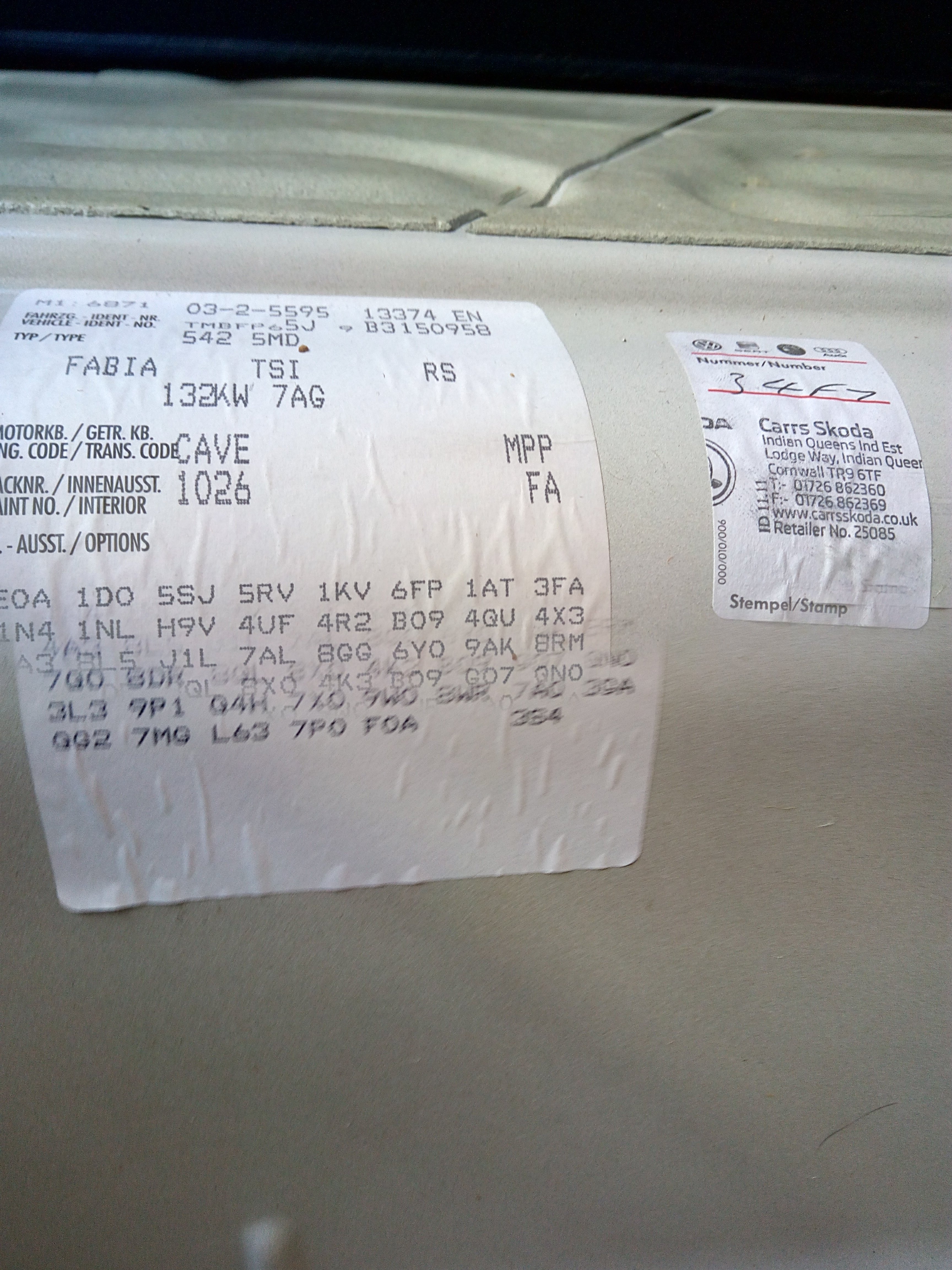

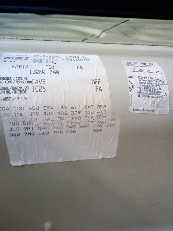

The World Wide Recall in 2012/13 and the European Service Campaign '34F7' from 2014 was for 'Loss of drive' which could occur because of a blown fuse,
but it was about the MCU / sulphur and all that jazz.
@Sittingbull is not having an issue with his Twincharger which has a new engine & £2,800 of DSG cost with new clutches & MCU but with a family members Mk3 Fabia.
Will not Start, stuck in P.  Dead as a dodo.
@USMANM19
Did your car get '34F7' done anytime since 2014?   That was called as a preventative measure against the 'Loss of drive'.

ive got the 34f7 sticker in the boot so it should hve been done
it had a engine change in 2014 from skoda when the car was on 45k miles now on 94k
SIMPSONS Skoda....
So there is a sticker, must mean they did it then........ Correctly hopefully.
Just rang the same skoda and they have said it has been done

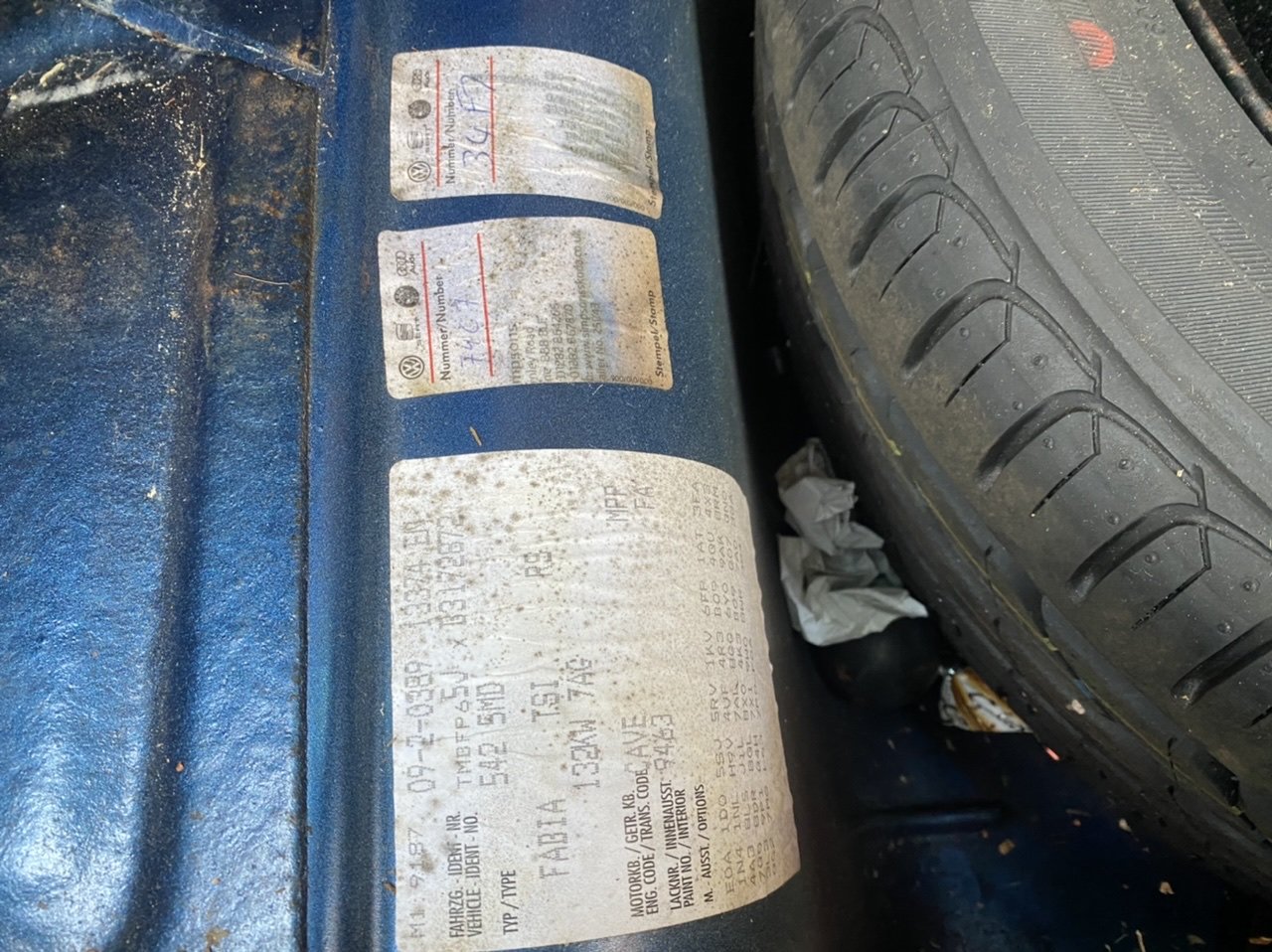

What is the other sticker, 74G7 or something?
Is it Heated Seats ?  a 'Skoda Secret Service Campaign' item
Is your car running the original engine?
Just wondered if it was a members from here that had a new engine in his.
New engine In 2014 and yes the other stickers for the heated seats
