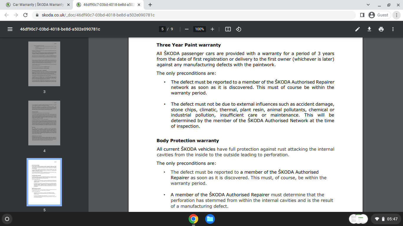

The Paint Warranty is 3 Years and it is the Corrosion Warranty they are concerned about here and the 'Bodywork Inspection T&C's' which do nor exist.
SKODA_Warranty_Terms_November_2021.pdf

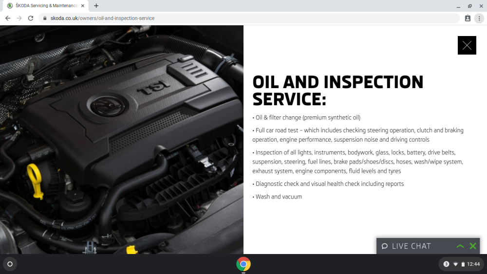

Skoda seems to fail to remind Dealerships that a Service is supposed to include a Body Inspection and a report of damage or poor repairs or corrosion.
http://briskoda.net/forums/topic/505391-treating-rust-in-tailgate
827614452_SkodaFixedPriceServicing.JPG.3dbea7606c029076ed94e2f0216199b6.jpeg.689c25a185d90e4e44889f342770023b (1).jpeg
995569228_Screenshot2020-03-06at12_44_10.png.348e1680dd3900132987496b75374788.png.83220c99bb899007cb2e16557a72981a.png

Before going all in fighting Skoda / VW UK about a 12 year corrosion warranty on a 2010 car be sure of the Warranty in 2010 and that it was for 12 years and not only 10 years.
You should have that Warranty Booklet, or some proof of Warranty cover.
