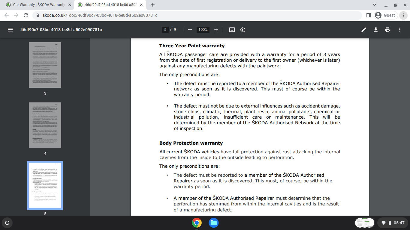

MIX UP HERE by WHOEVER WITHOUT ENOUGH KNOWLEDGE.
The Paint Warranty & Corrosion warranty are different things. The Pain Warranty expired @ 3 years.
SKODA_Warranty_Terms_November_2021.pdf
