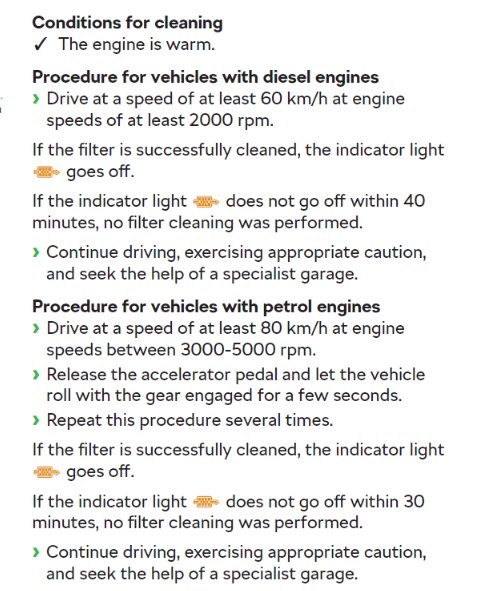

That you are describing is the Re-Gen process.  The car will always tell you to go into a lower gear - which it need to blow out all the crud from the DPF (Diesel Particulates Filter).  The idle RPM will also be at 1000rpm instead of 800rpm and you may also find that there will be a burning smell.
General hint - long fast journeys for Diesels are good.  slow stop start journeys are bad.

Long motorway runs are counter productive, what you are trying to do is clear the filter & heat is what does it, motorway driving creates too much cooling & therefore, will take longer to clear the filter.
I may have sounded flippant earlier but, high revs in lower gears will give the exhaust temperatures required & burn the crud out of your exhaust filter. Find a 50 mph dual carriageway near home & drive up & down it never going into a higher gear than 3rd, you'll find it quicker & use less fuel than your motorway option.

I say straight away that I haven't clue how the system works but from everything I've read thus far, a PPF works differently from a DPF given there's no reason for it to regenerate - unlike diesel, any soot is burnt off in normal driving. ( gases run at higher temp in a petrol engine thus particulates are burn off ).
Never heard of anyone having to burn off soot in a PPF before. Wonder if it's the filter not working as it should or perhaps bad fuel. How old is the car / how many miles has it covered?
