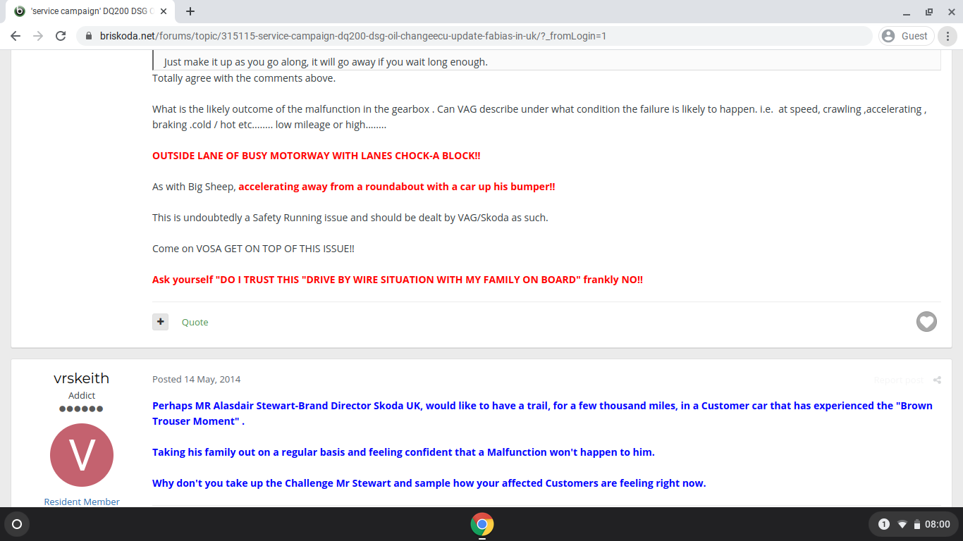

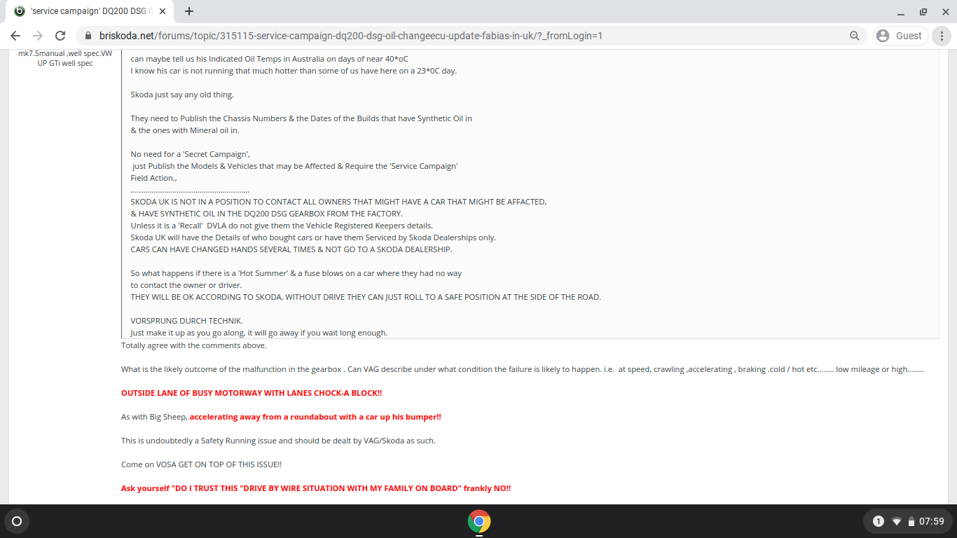

With the world wide recall on DQ200's in 2012 & the Service Campaign iin Europe / UK n 2014 '34F7' for the total loss of Drive, VW UK persuaded the VOSA/ DVLA that it was not Safety Critical and did not need a UK Recall as you could ' Coast to a place of safety'.
FT for a game of soldiers when you lose drive on a middle or outside lane maybe uphill with HGV's on your inside lane or up your jacksy.
Brown Leather Interiors were acceptable for some that had a DQ200 fail on them on a motorway or just on any road.
