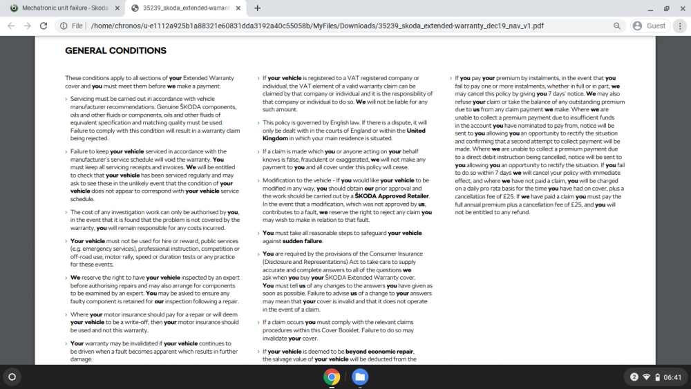

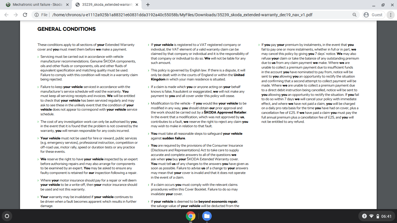

Extended warranty is with skoda- see attached copy- no mention of a courtesy car

35239_skoda_extended-warranty_dec19_nav_v1.pdf
