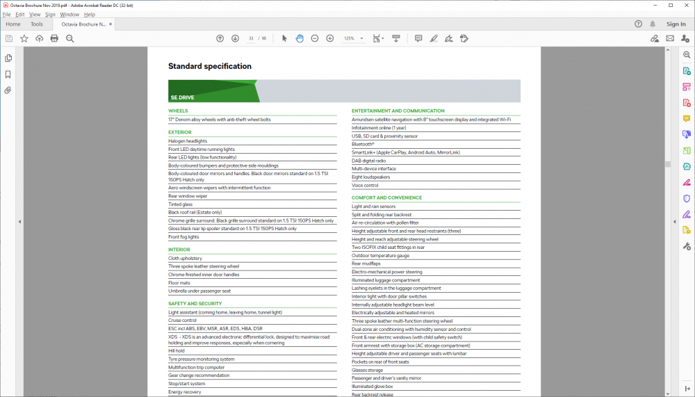

For interest, here is the only text from the owners manual which talks about the diff locks:
Electronic Differential Lock (EDL)
EDL helps to stabilize the vehicle when driving on road surfaces with different grip under the individual wheels. EDL brakes a spinning wheel and transmits power to a different drive wheel.
Electronic Differential Lock (XDL+)
XDL+ helps to stabilize the vehicle during fast cornering by braking the inside wheel of the driven axle.
So much clearer now! That is all, no indication of which models either option is fitted to. Both seem to be electronic in nature, no mention of a mechanical diff lock.
