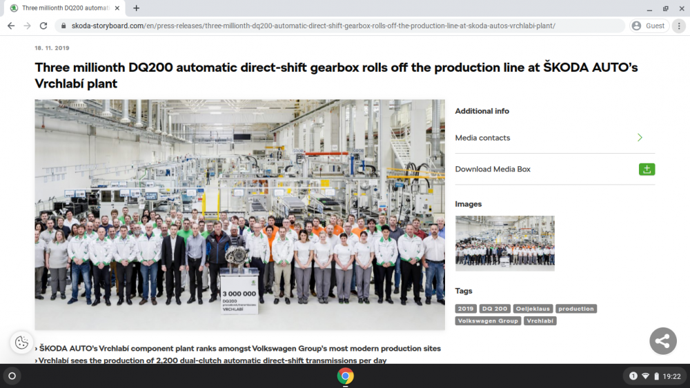

  • They do make millions and Skoda produce millions of DQ200,s for the VW Group Models.   But this is a DQ381 with a growing percentage of MCU failures globally and still nothing from VW Group
But this is a DQ381 with a growing percentage of MCU failures globally and still nothing from VW Group accepting any fundamental design, manufacturing or material faults.
