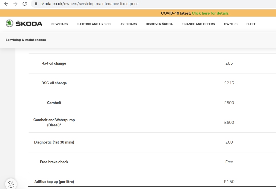

Did you ask their hourly rate for a Diagnostic?
Ar Participating Dealers of Skoda Fixed Servicing @ Maintenance it is £60 for the first 30 minutes.
