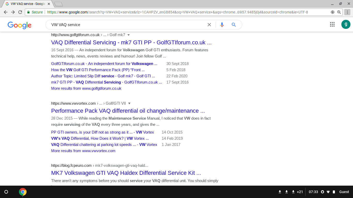

Had a quick google over a morning coffee.
Yes, I'd say the front diff and VAQ haldex oil are separate. When the dealer says the diff oil need replacing, they actually mean the VAQ haldex :)

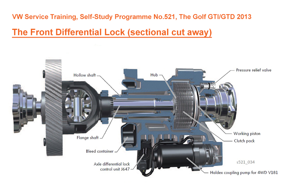

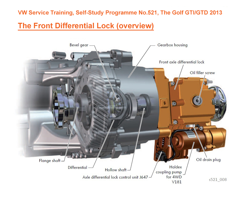

Few images for those not familiar with the VAQ.
Nice to see the SSP still names it "Haldex coupling pump for 4WD V181" even though there is no 4x4 involved :D
Anyway - the important notes are:
- if you have a VAQ fitted, it will need the haldex fluid replacing periodically
- It's around 3 years/30k miles but if you drive hard, do it earlier
- Much like a rear haldex, the haldex pump should be removed and the strainer/mesh cleaned
The last point is the important one as I expect many dealers won't do this as standard given what I've read of people rear haldex experiences :thumbup:

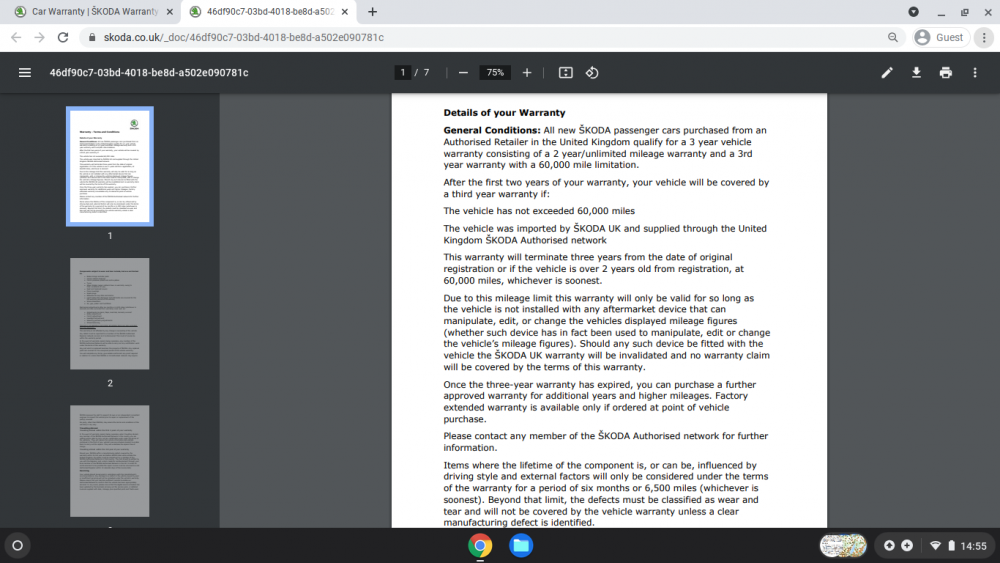

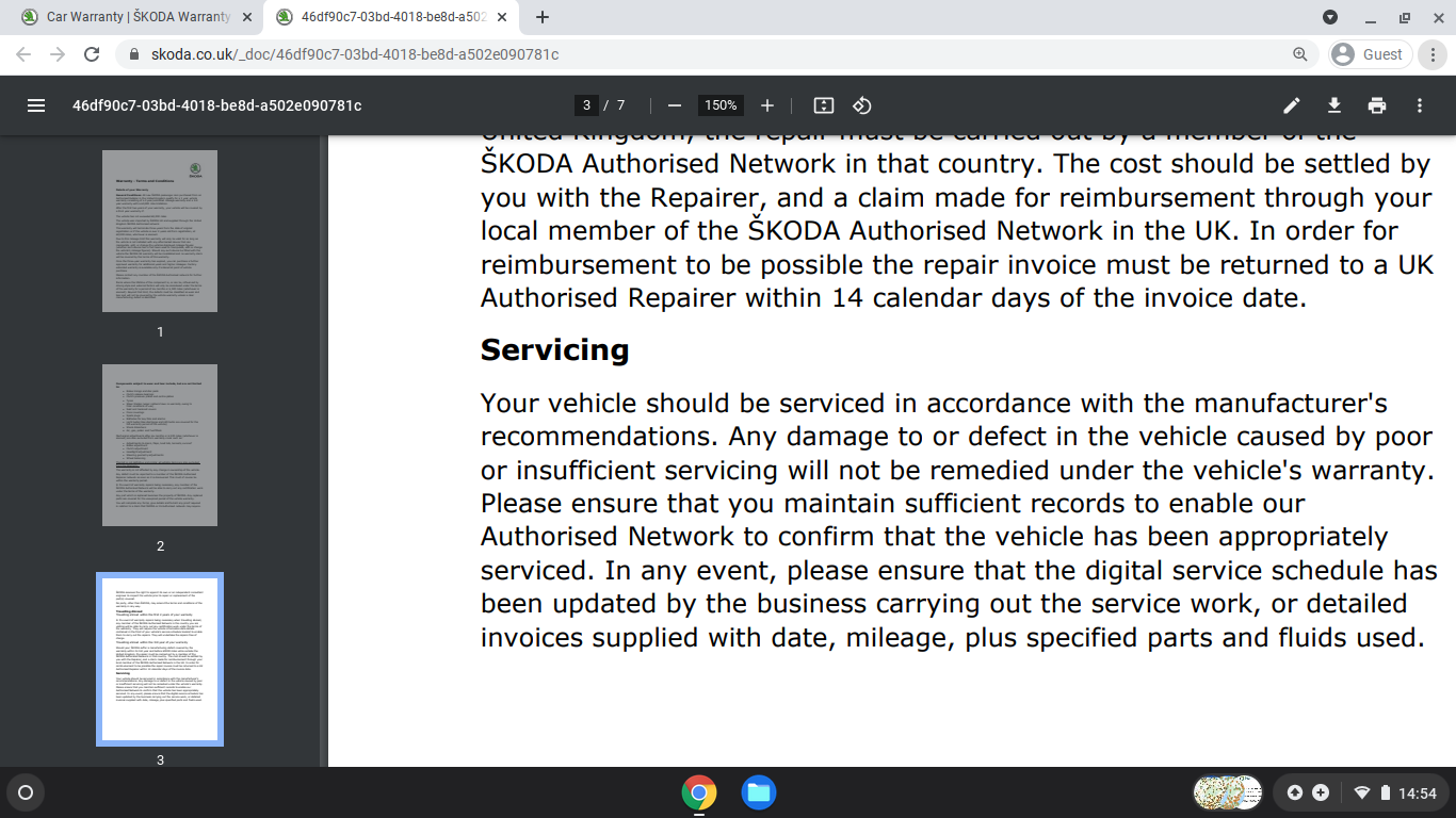

An important thing is that the Engineers / Engineering Designers have Screens / Filters because there is a need to Screen or Filter stuff.
That really means that Screens or Filters require cleaning or replacing.
At a Skoda / VW Group Approved Repairer just ask when getting the work done to the 'Manufacturers Recommendations' if they are Cleaning or Replacing Screens or Filters and if not is that keeping the Manufacturers Warranty Valid?
They can even put on the Invoice / receipt if they have not actually cleaned or replaced the Screen or Filter.  After all their work should be guaranteed for 2 years parts and labour.
It is required to be done for Manufacturers Warranties and Extended Warranties. OEM parts and Fluids, work done in Accordance with the  Manufacturers Recommendations.
If £110 at a VW Group / Skoda Approved Workshop is not getting the job done properly then that is really not 'Simply Clever'.
Sadly it is the case that Skoda Main Dealerships are doing half arses jobs regularly for customers who want proper servicing and maintenance on keepers.
(Not just some Lease vehicle they are handing back and then some person buys as a Used car with FMDSH,  a FMDSH with a history of half arsed servicing work.)

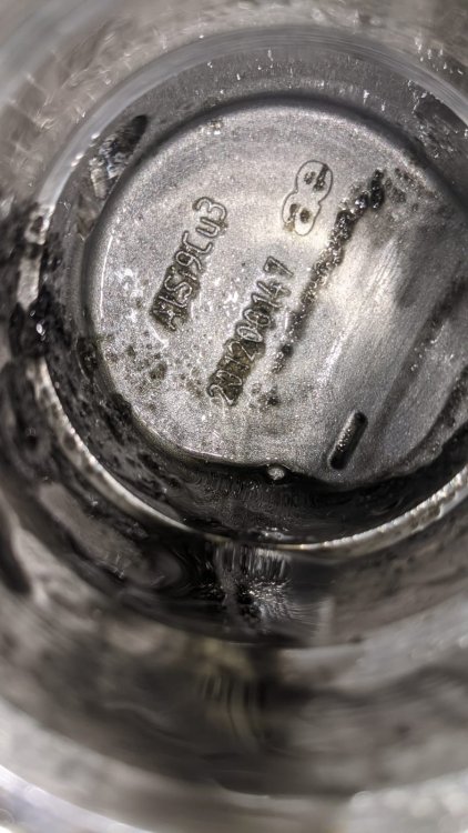

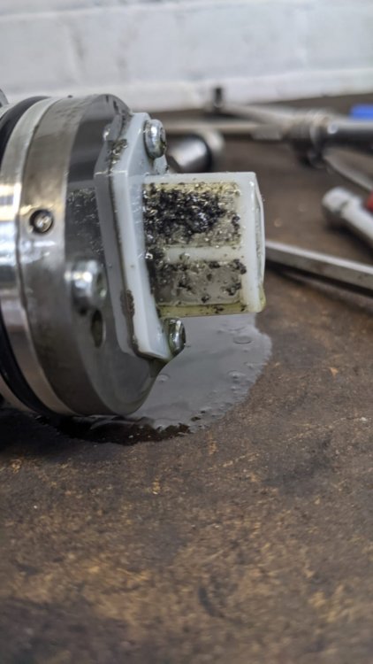

Hiya guys, thought I'd just update you for those interested in getting there Haldex serviced.
Although it wasn't too clogged up I imagine if you followed Skoda servicing and just got the oil changed you might end up with problems eventually.
2018 VRS 245 DSG at 24,000 Miles. I don't drive fast nor do I hoon it everywhere I go, but I do like to give it some every now and then.
Never launched the car ever and I don't think I ever will.
Hope this helps someone decide whether they want just the oil or the filter cleaned out as well :biggrin:
IMG-20210708-WA0001.thumb.jpg.dbc40691a8f8c95b44a5583d1983d132.jpgIMG-20210708-WA0002.thumb.jpg.7b0f3ded9e52425bce7361cab9ca2a5d.jpg
Edited by KyleHa
Interesting that. I've seen many more photos in similar condition and quite a few on the net far worse as well, even at 30k miles, some sugest lowing the interval, given the state of yours I too would want to clean it up.

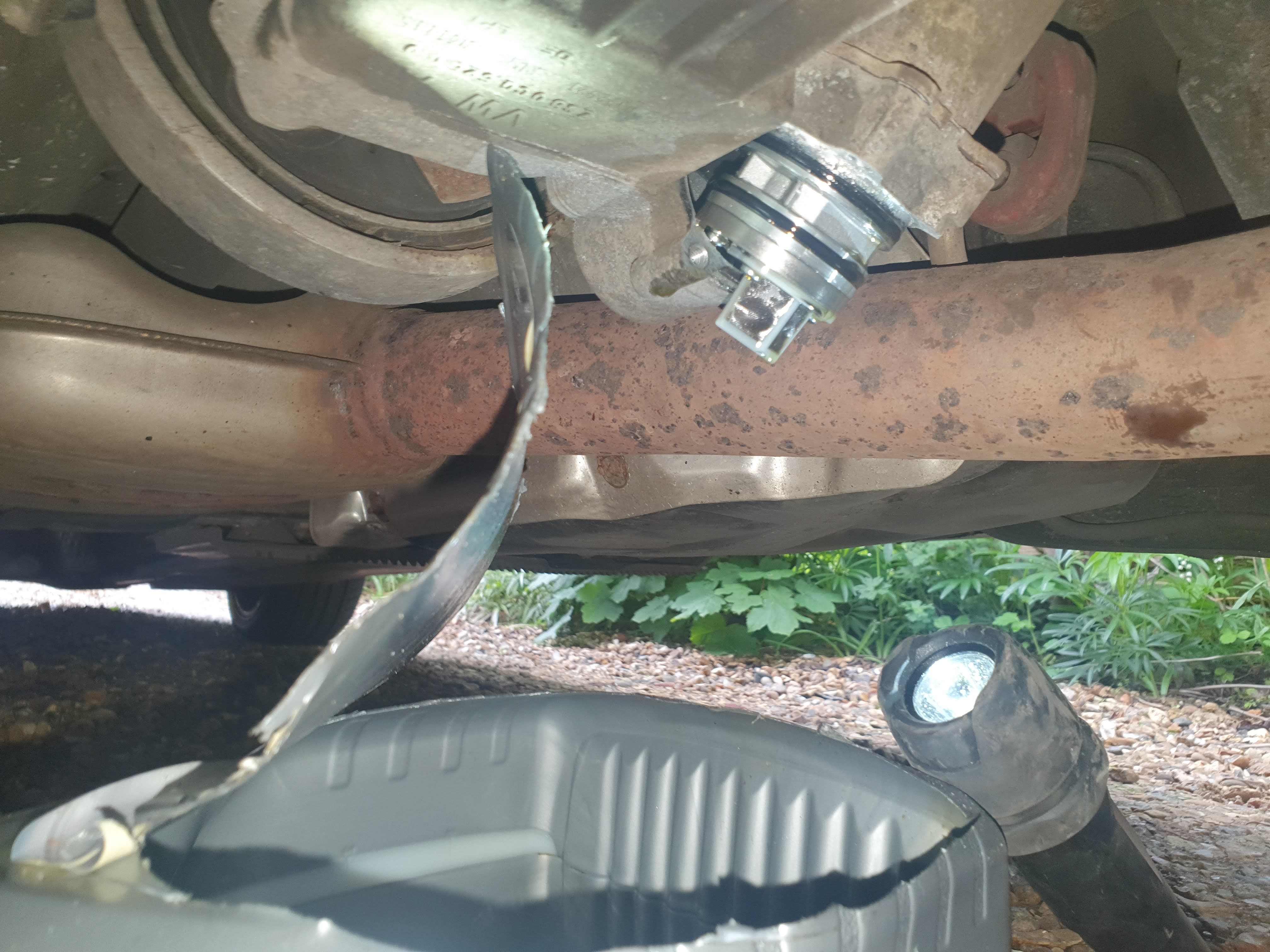

In contrast to that picture, I have done the haldex coupling used on the 4wd coupling and there is no front haldex diff coupling only the braking system on the front of my 4motion car.  The same or a very similar pump is used and fluid is identical. On my "new to me" used car, Dec 2015 registered, with 56k miles (I don't think it has been driven lightly), the strainer was spotless.
The oil was not perfectly clean and the change was probably in order. I really doubt it had ever had the haldex fluid done before either.
I'm very confident the pump and strainer had never been cleaned before because the bolts and wiring appeared to have never been moved or touched and it is tricky getting it removed from the housing.
An observation and conclusion I make is that the front diff haldex coupling is under higher duty and more susceptible to containments cloging than the same system used in 4wd coupling. My car is a Golf Mk7 but MQB platform so mechanicals still relevant.
Photo below from my car recently. nb. The discolouration on the screen is not clogging, if you zoom in it is just the oil colour and the shading due to the picture and light source.
Edited by TheClient
