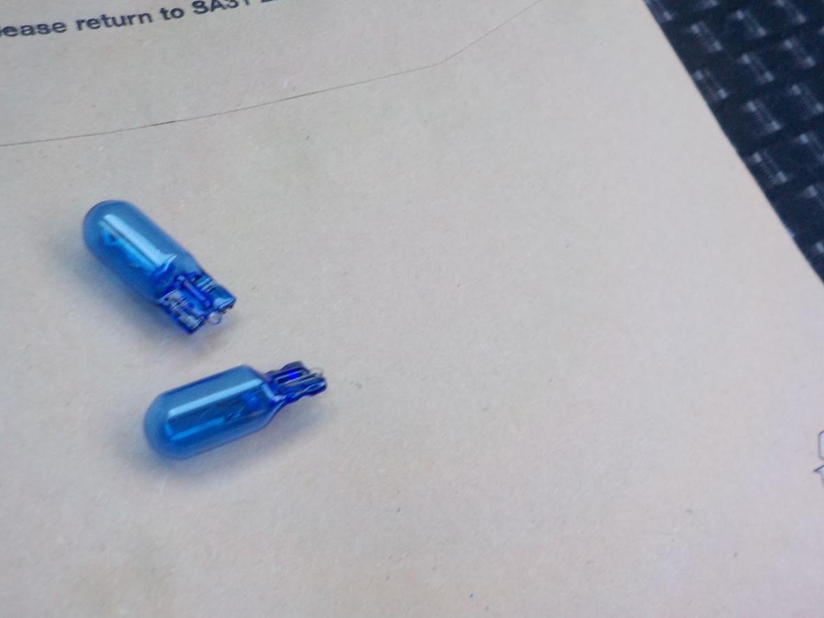

Also my side lights still don’t work after finding the switch next to fuse box , checking fuses and changing bulbs , anyone in leamington spa know about electrics ? Or I pop to the local garage I’ve been recommended
There is no Sidelight Bulb to swap out.  The Blue Bulb in the headlight is a dummy.
The DRL units you are showing are the DRL's if the Switch beside the fuse is on, (Later cars did not get the switch) and they are the Side Lights / Position lights when you turn on the Sidelights or Sidelights & Headlights.  Less bright when they are on as sidelights compared to when on as DRL's.
So do the DRL units not come on currently as the Sidelights?
Former owners might have modified the lights and actually have the bulbs in the headlights working as sidelights because some have done this over the years.

5a4d470712bb0_post-86161-0-74943500-1478766698(1).jpg.6279562329b359c3d9ae65e87bf477a1.jpg.96e30469cbb71594365926c780d3e0f7.jpg

There the lights yes but all other lights work and the drls seem to be on regardless of the switch ( but I check again)
so if the other lights are just dummies like me I will just leave it.
Thanks for clarifying this for me.
