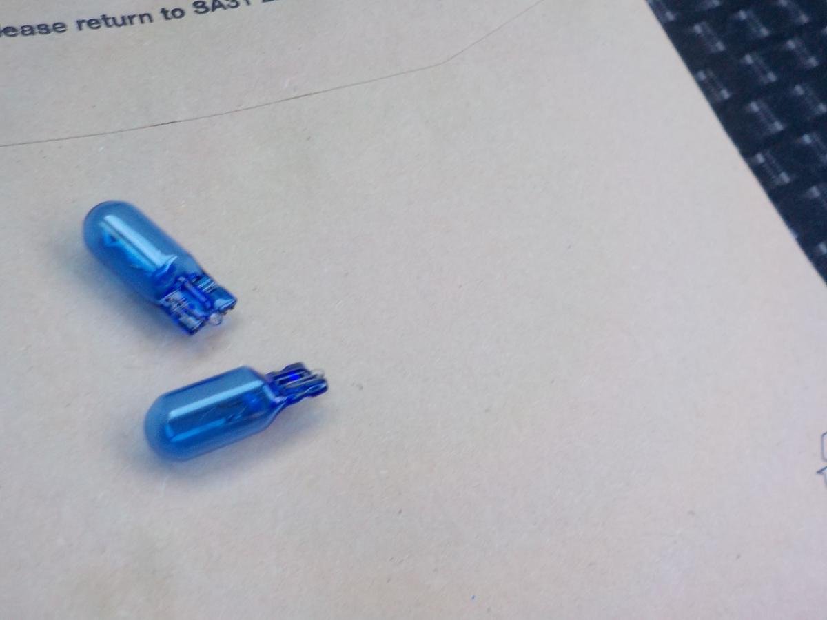

There is a thread for this subject already but it’s confusing with so many people commenting. Car just failed mot because of  HID kit installed and apparently no side lights working. (Ones in the head light unit) the bottom drls come on when I start the car up and stay on constantly but no sidelights. I can’t get the bulbs to work what so ever. It’s really starting to irritate me. DA60WUE. If the owner is in this forum please please enlighten me
They don’t work on the vRS they aren’t wired up.
There’s legit wires to the bulbs tho? So which is my side lights then?
On a Mk2 Fabia vRS the sidelights. / Position lights which do pass mot,s if the examiner is not stupid is the shared DRL unit,  the sidelights are the DRL,s dimmer.   Try on the sidelight switch,  that is front and rear sidelights. DRL,s are just to the front.   Blue dummy bulb in head light is just that a dummy, like some mot examiners that fail twinchargers on no sidelights.  One even took my lights apart as a favour....

The blue dummy sidelight bulb you can see as mentioned is there but no power to it, and the fogs were mistaken are obviously DRL's

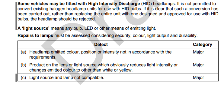

Info below on the HID's ban on older cars, but you prob already know...
Taken from Page 2, must be affecting a lot of second hand modded cars now unfortunately.
mot-inspection-manual-for-classes-3-4-5-and-7-from-20-may-2018-draft.pdf

@Offski so the sidelights are actually your drls? and yes @Kobayashi he must of thought they have always worked! just baffles me that they've even gone to the extent of putting false wires in also. very annoying but kind of glad I know what I'm faced with now!
No.  The Sidelight units are the DRL units and DRL if you want.  Switch in the Fuse Box to put DRL's off until Skoda deleted that and no switch.
When you were looking for a new DRL unit were you not aware they were also the Sidelights & also the Parking Light if using as a parking light?
Less bright than DRL's.
