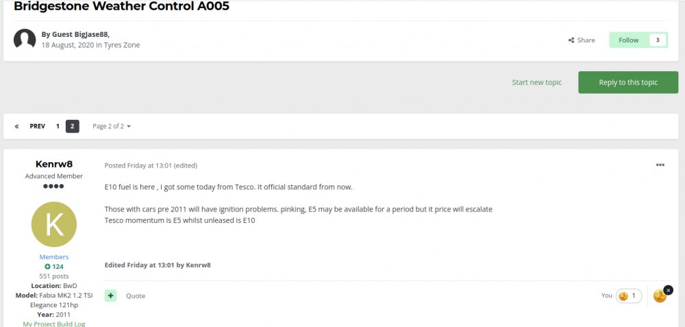

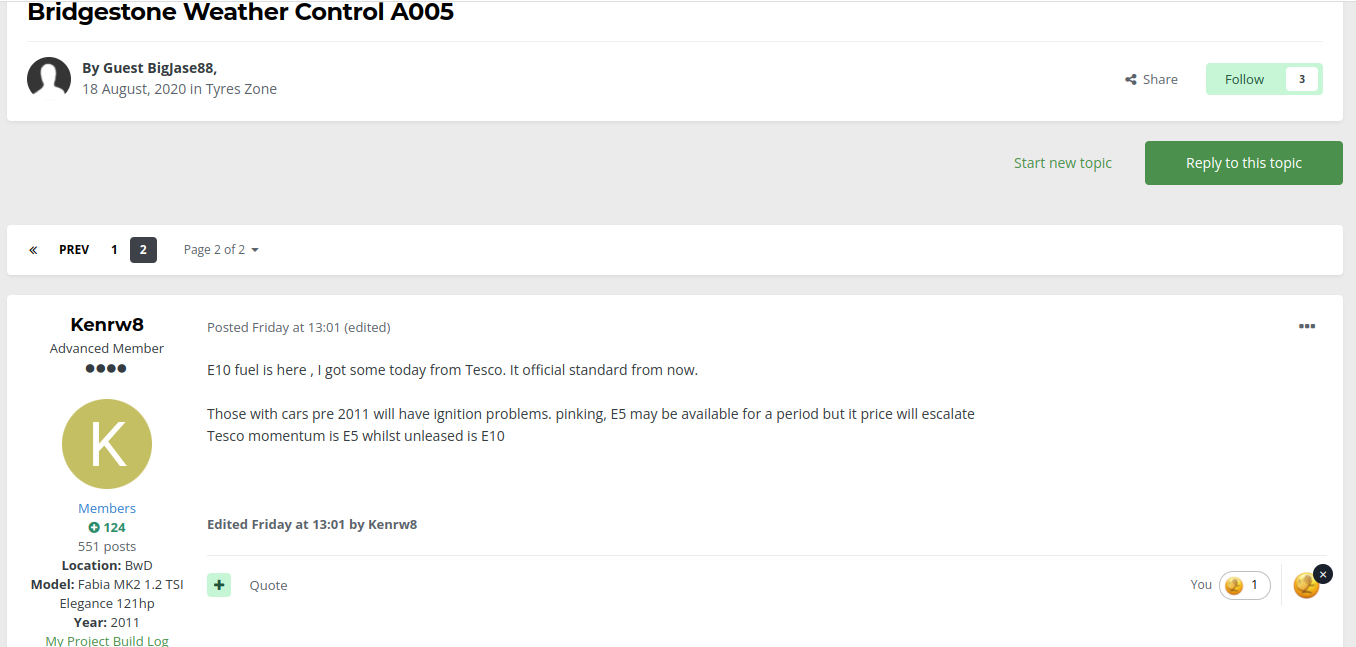

E10 fuel is here , I got some today from Tesco. It official standard from now.
Those with cars pre 2011 will have ignition problems. pinking, E5 may be available for a period but it price will escalate
Tesco momentum is E5 whilst unleased is E10
Edited by Kenrw8

@Kenrw8
 You need to be careful when starting Internet Myths.
I take it you mean 'Cars pre 2011 'may' have ignition issues.   Not 'will have'.
Many millions of cars pre 2011 are perfectly OK running E10 before manufacturers had to produce engines that could.
Are Tesco really displaying misleading or false information on pumps now on E10 being what is being delivered.
What about the Octane, is it showing 95 octane (min) for Unleaded and 99 Octane (min) for Tesco Momentum 99.
The same 95 ron for Tesco Unleaded be it E5 or E10.

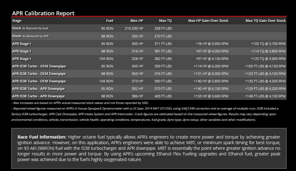

Thanks George useful info. I use a mix of 95 and 99 anyway. Ethanol has a higher octane rating than gasoline so that's one positive.

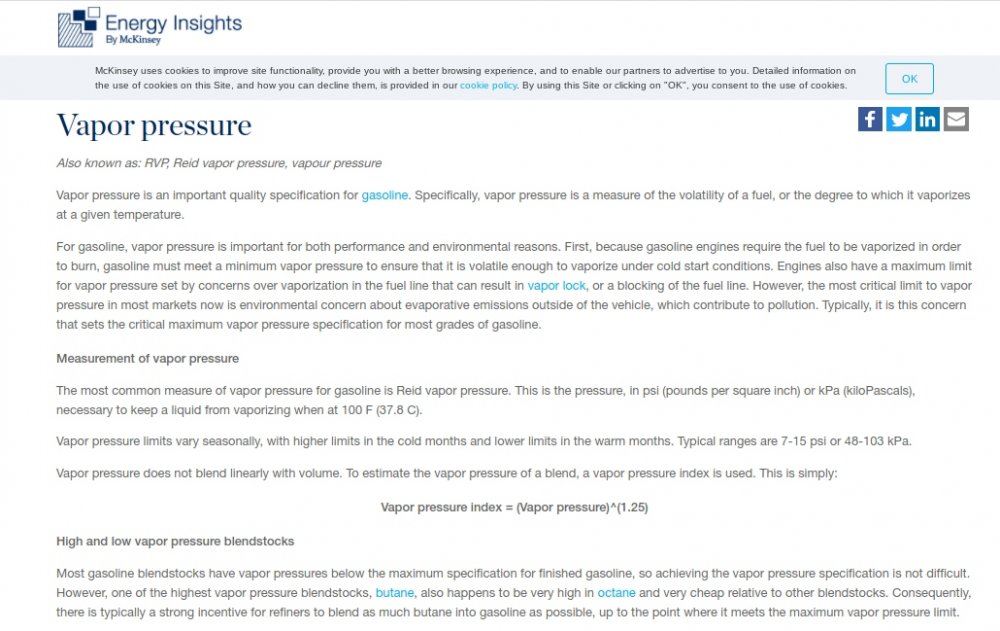

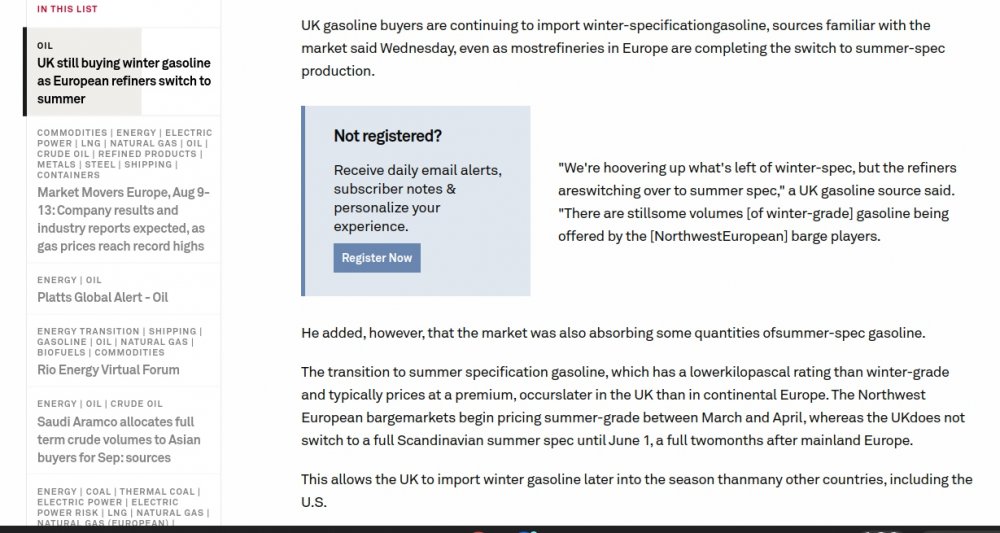

But in winter spec fuel those that used ethanol as an octane booster reduced it as it is  hygroscopic.  You pay to buy fuel and energy, if E10 produced less energy then that is an issue but fortunately it has the same Ron / Mon.    97 and 99 super unleaded are the minimum they can put out the pumps as is  95 Ron.  If more fuel is required to cover the same miles when using E10 then that is not 'greener' as it takes more tankers to deliver more fuel to filling stations.

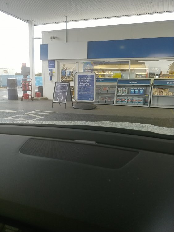

Tesco have labeled their pumps (BwD)  and selling the 95 Octane as E10. 99 is still labelled as E5,  as I read it E10 is available as 95 octane.
Edited by Kenrw8
Indeed, as stated in the linked article, many places have already added the logos in advance, but that's not yet what is going into your car.
That might be because at anytime the 95 Ron with up to 10% bio might get delivered but Trading Standards should be right on them on that one.  If the customer is getting E5 presently then that is what they should display.  Stickers at the kiosk to be slapped on the pumps  would take staff no more than 20 minutes at the time a tanker arrived to fill tanks with E10.   Tesco or others do not display the prices of fuel as they might be tomorrow, next week or next month.
