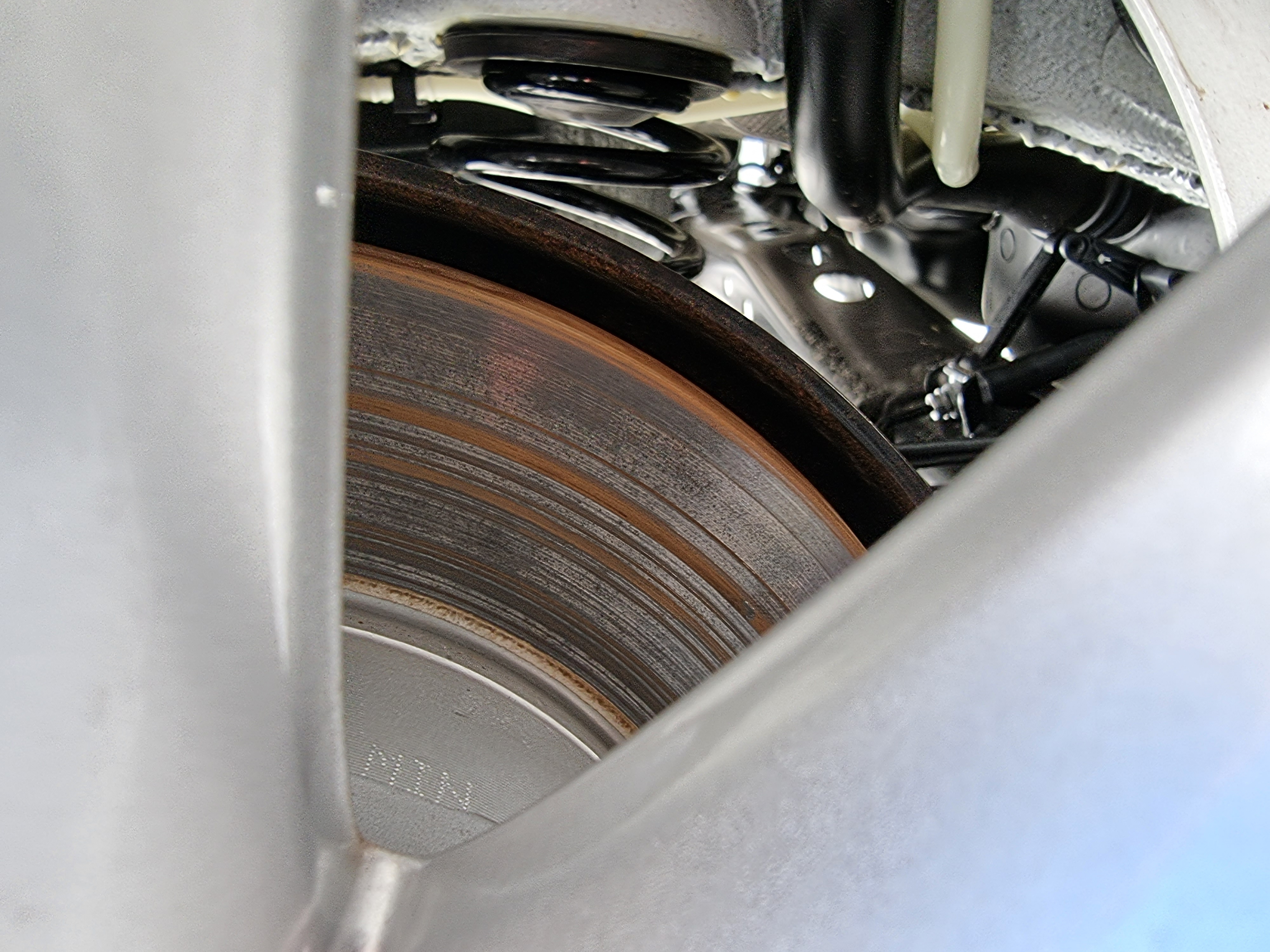

Can some one tell me the rear brake disc thickness on an Kamiq LE 1.5
I have a problem with a worn one nad want to know what it should be
The car has 18"Crater mags  so I presume they will be bigger discs than the 14 and 15's have

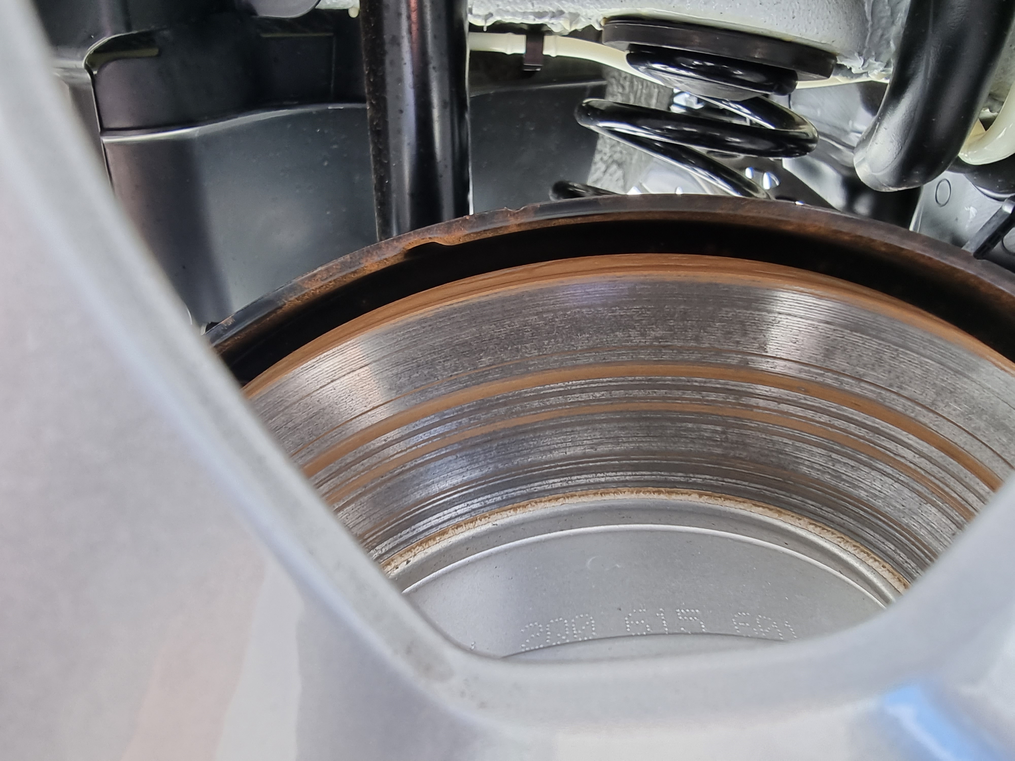

I reckon they are 12mm thick and one of mine is 11.34
This is on a 1 DAY OLD CAR that has done 32 kilometers
Something is weird so back to the Dealers tomorrow

It looks like rather than just wearing off the protective coating and a bit of cosmetic rust from the discs the pads have done the scoring.
Best get the car back to the dealership.
Yes and the left one even has a small lip on it on the outside  Drums are beating girding up for war  LOL
According to Autodoc its 9mm with a min of 7mm. You should be able to read the Min value printed on the hub. New to Min is normally 2mm for most discs.
My Superb has 10mm discs. Kamiq is a featherweight in comparison.
Just looks as it you need to do a bit more braking to clean up the rust from being stood around during shipping and at importer/dealer. It should clean up ok with a bit of heavier braking.
Part no on photo is 2Q0 615 601 which is a 9mm disc
https://www.autodoc.co.uk/car-parts/oem/2q0615601h

No its not I have the workshop manuals from ERWIN and for 14  and 15 in wheels it is 9. These discs Ive measured with a vernier and they are at least 11.75 mm and NO, more braking wont fix them and they are GROOVED like 40,000km discs, when the front one's which do most of the braking are shiny smooth. As are the 4 discs on my 2 year old Tiguan with 10,000km on it. They are stuffed as far as Im concerned. I paid for a NEW car not one with grooved brake discs and stuffed pads.

Check for a further character beyond the 601 on the disc.
Also, see what it says after "min".

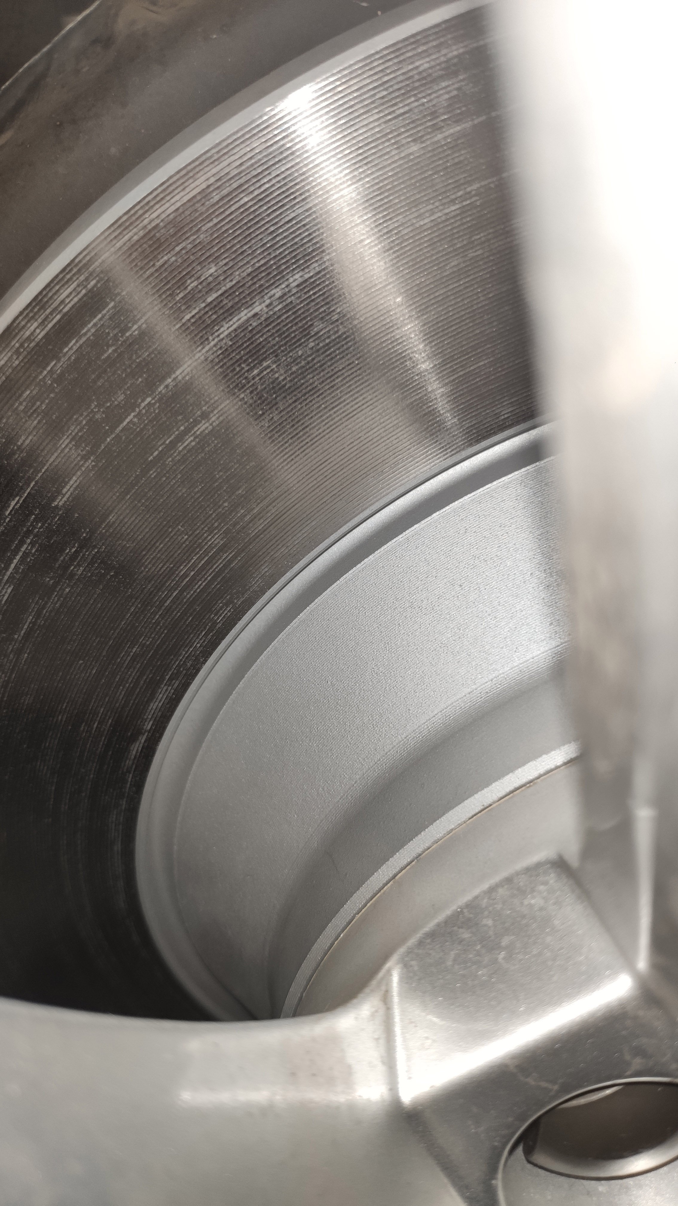

The concentric grooving looks like machining marks, the same as on my Superb when they were new. Skoda have a reputation here on Briskoda for low grade rear discs if you do a search.

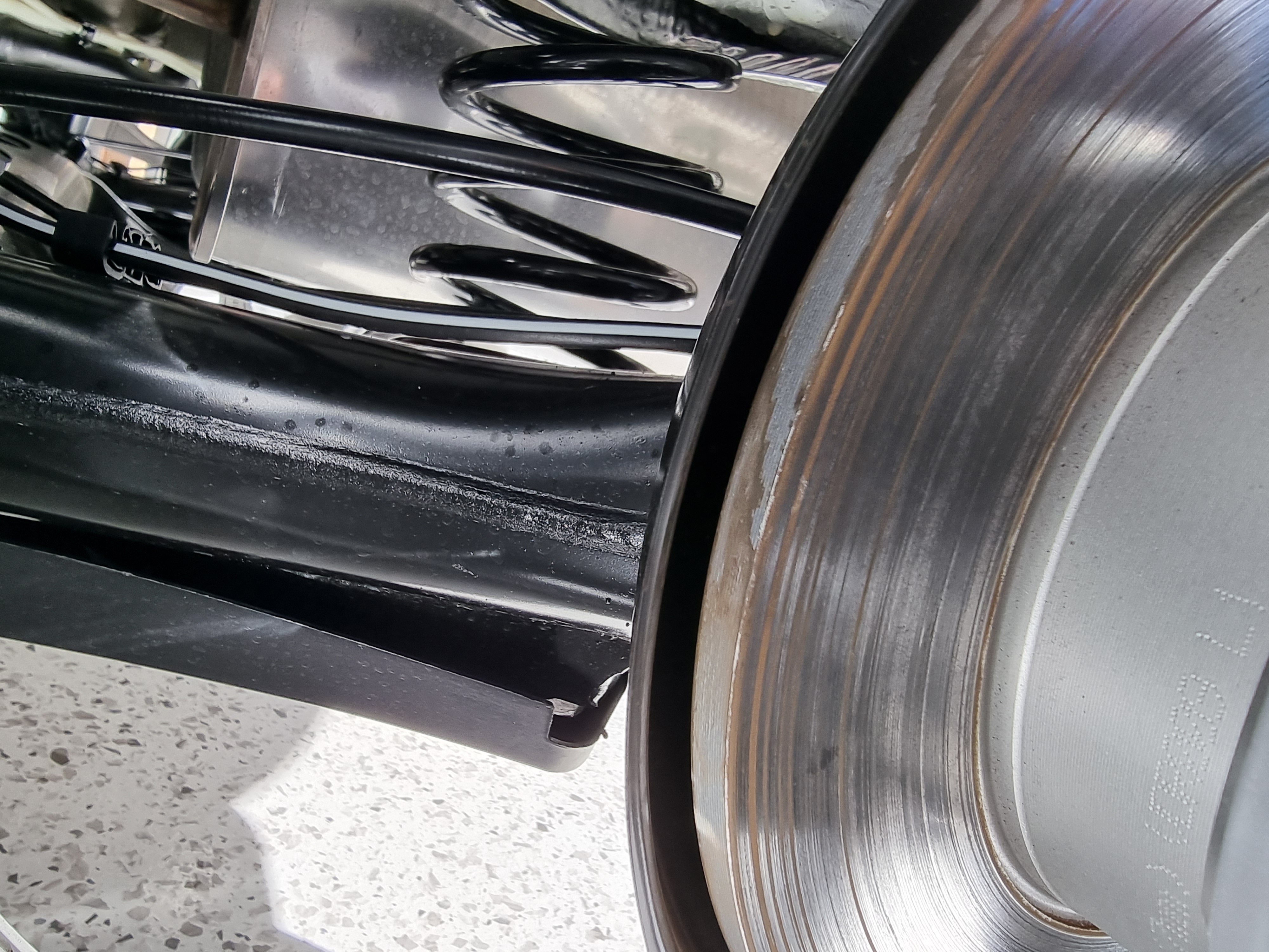

The grooves are not even across the faces and on one you can see a wide band of rust where pad is simply not touching the disc at all.
They look like the are used ones and someone borrowed mine to replace some one elses and forgot to replace mine.
The hubs would be rusty and the laser etching wouldn't be so clear and clean if they were "used discs".
IMO they are not yet bedded in. You've only done 32km! Disc/pad manufacturers recommend  around 300km to bed in. Longer if you are a light foot braker.

The problem is they have been stood and rusted during the journey from factory to you. Try some heavy braking to clean them up, thats what the dealer will do.

Ok then tell me this    If the discs on my TIguan are as bright and smooth as glass after 10,000km and the fronts on the Kamiq are also as smooth as glass why do the rears look like old ones with grooves that you can catch your fingernails on and patches that the pad isnt even touching. Will post dealers response tomorrow.
At a guess, its because your Tiguan has done 10,000 km with plenty of proper braking. And in the case of the Kamiq, because the fronts do 90% of the braking, possibly more if you are carefully running in and not done any seriously quick stopping and Skoka OE front discs are better quality than their OE rear discs as I have stated they have a bad reputation here on Briskoda.

Truth of the matter is the discs have been scored by the pads or something between the pads and discs.
If the car was in for a service a tech might well remark on the scored discs.
The Dealership might well just want to replace the pads.
But the car has only 32 km on the clock, of which possibly 20km at point of delivery. i.e. car driven only 10 miles or so from dealer.

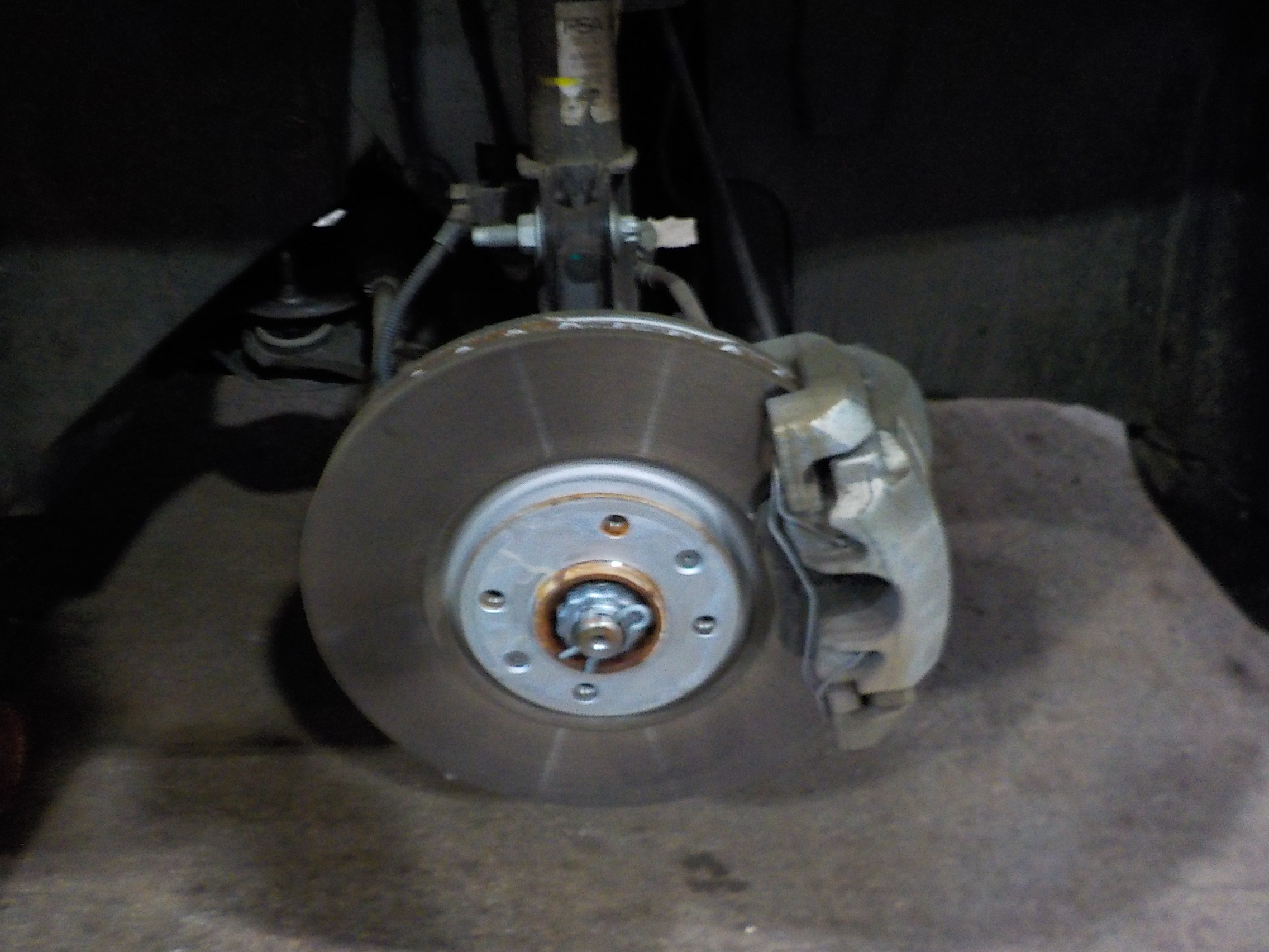

And what is the point of those photos? @e-Roottoot

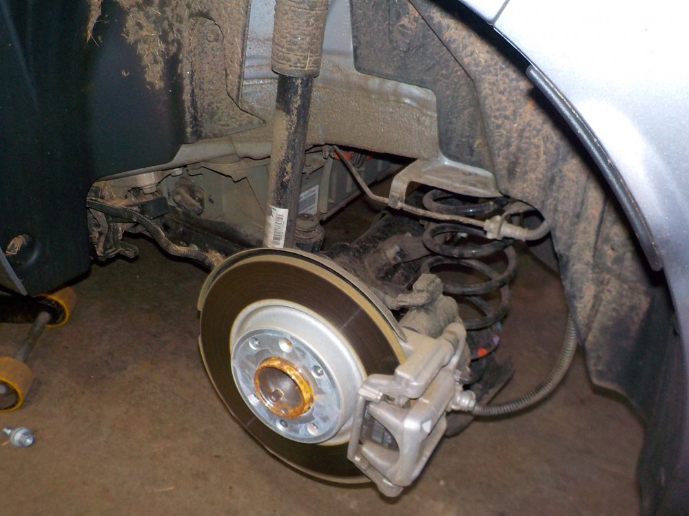

Here is a pic of a new rear disc on a Superb where you can see the machining marks

Car had been in transit mode up until got to dealers as they reset it  I was told which is 14mph roughly   Discs dont look like the Superb ones as grooves are not even at all and look like my old Falcons looked like after I had caned it and warped the discs  (easy to do on them)
Odo has 23 km on it at delivery  Will find out in the morning as 9pm here ATM

In my opinion they are not score marks but rust and protection coat residue not quite yet removed from the machined disc. A photo cannot really tell all.
A car shipped across the Atlantic through the Panama canal and across the Pacific is likely to pick up some surface rust on the discs, the protection coating having been removed (mostly but not all) on the drive out of the factory to the transporter/train/ ship. Takes more than 9km to remove that rust/remaining protection off the rears as they are hardly used in normal driving.
My experience is the rear discs on the latest Skodas will rust up even while stood within days in a dry locked garage, presumably from humidity from outside.
The OP may find a lot of the rust has mysteriously gone by the time they drive back to the dealer if he has to make a sharp stop along the route.

Well why is there wide patches of rust not worn off where the pad should be touching the  disc.  I know what machining marks are like and they are nowhere near as rough as these ones which are uneven variable spaced ridges. Yes my Passat discs used to have a light coating of rust on them the day after I washed it but wore off smooth in first couple of brake applications. I live a km from the coast so rust is a normal thing here and we know about it .
If the disks were smooth with machine marks I wouldnt worry but these look like they have uneven pads in them. One would expect new pads to wipe the whole area of where they touch off evenly and leave the disc nic and clean and just at the most have the machine marks and not obvious ridges on them
A light rub with wire wool or a scouring pad could remove any coating residue or rusty stour very easily.
The OP's finger nails can tell the depth of any scoring if that is what the deeper rings are.

BTW Only 232 x 9mm discs are listed on Skoda-parts.com which usually has the complete range.
https://www.skoda-parts.com/spare-part/1j0615601q-rear-brake-disc-232x9mm-ate-14339.html
On one of the OP's photos you can see the min value is printed as 7mm so confirming the discs as 9mm
Get that vernier and measuring technique checked!
