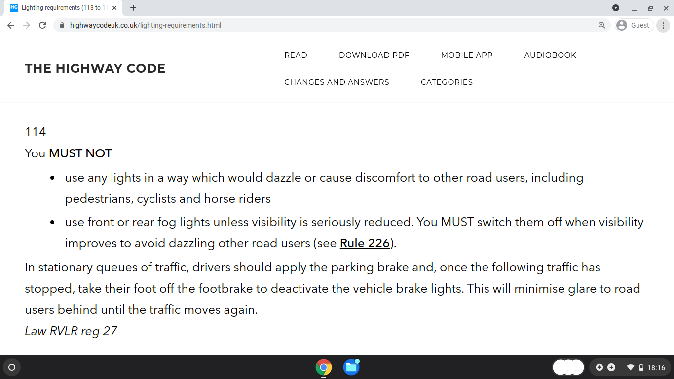

Basically the EU / EU & other manufacturers do not care about the UK Highway code, they get by using C&U as the EU has it.
So drivers need to think about what their rear lights are as also with the front ones.
At extended stops maybe use the Parking Brake at extinguish the brake lights.
Edited by e-Roottoot
To be fair, that part is a should and not a must - so it's not actually breaking the law.
But I do agree that the lights should go out once you take your foot off the brake pedal, even if autohold is turned on.
