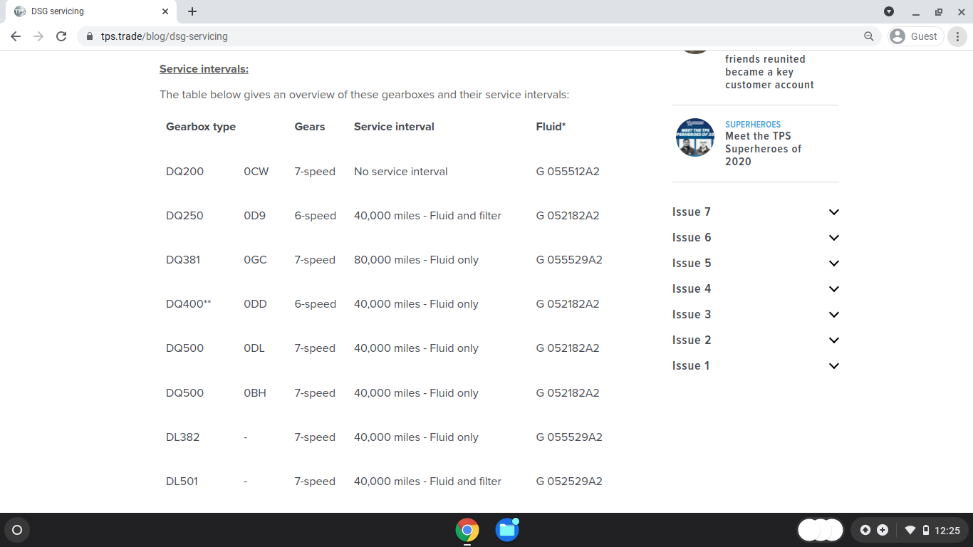

1.5 TSI's with front wheel drive & 7 speed twin dry clutch DQ200 DSG's do not require DSG Services.

The DSG is a 40,000 miles Schedule, they do not use the word Schedule.
it is not a 4 year old by Guidelines, Recommendations or Schedule.
I would get back in touch with them to check,
That might be the price of the DSG Oil change and the Haldex Service.
  Have you had the Haldex Serviced?   Was it done at 3 years or 30,000 miles.   It used to be @ 4 years, 40,000 miles years back then it came down to 3 years and 30,000 miles or sooner.
Needs properly done, not just the oil changed.
There are threads on Briskoda about DQ381 servicing and the 80,000 miles.
Various info comes from Main Dealerships on that one.
Thanks for that.  I do a bit of work with VW UK in my "day job" so I might check with them to be certain, but nothing I've seen online has suggested that the DSG oil is time-dependent, only mileage, and our mileage is certainly low.  I doubt it will have done 40,000 miles by this time NEXT year, even!
The Haldex oil was changed earlier this year.  We bought the car at 3 years old (supposedly fully-serviced) and then they sprang that one on us when it was in for some warranty work.  Whilst I specifically asked (and they assured me they checked) the strainer, I'm willing to bet that they never touched it!  Either way, the service record does show the Haldex oil change now having been done.

There is no Servicing of a DQ200 DSG, no oil change or any other Service Actions.
(There are people that have changed the Oil and VW Group changed the Oil from Synthetic to Mineral from 2013/14 on in their World Wide Recall of millions and the Service Campaign in Europe.)   But then you will still be told they are filled for life, because the is no Maintenance Schedule.
