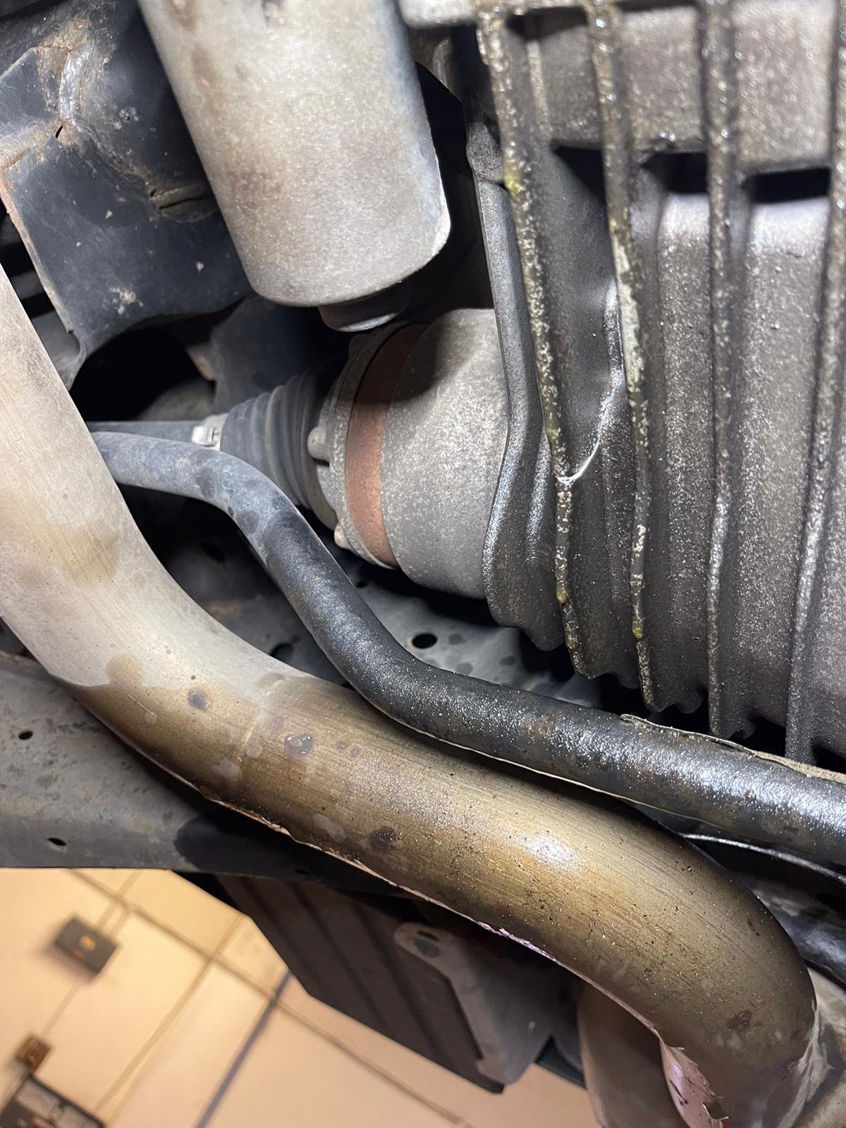

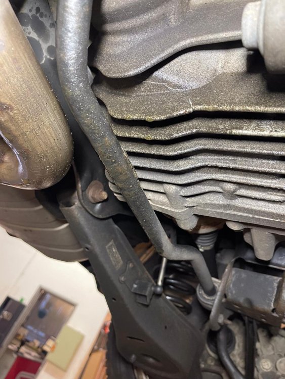

Yeti is back in the UK without any apparent mishaps. It’s been popped up on the ramp for a quick look underneath. It’s not pretty…..

Just wondering if one of the tyre fitters casually put his trolley jack under the casing before lifting half the weight of the car with it ?
A variant of the traditional "jack it up under the propshaft and bend it to a banana shape"
If it cracked, that would cause a slow oil leak and throw off the precision bearing and gear alignment, giving odd noises followed by rapid wear and then breakup.
So the crack could be cause rather than effect.
That’s an interesting thought, thanks. I’ll have a look when I go to see it for any jacking marks.
However, it lives in a garage and there’s never been any oil on the floor and after it broke down, oil ran out for a considerable time onto the road.
Some oily bits probably resembling shrapnel have made a bid for freedom.
