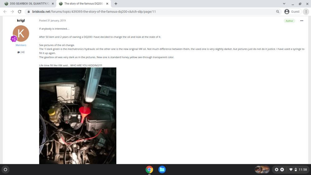

Was the car part of the Service Campaign '34F7' so in for a Oil change since 2014 on DQ200's 2009-2012 to get the Synthetic Oil changed to mineral oil & a software update?

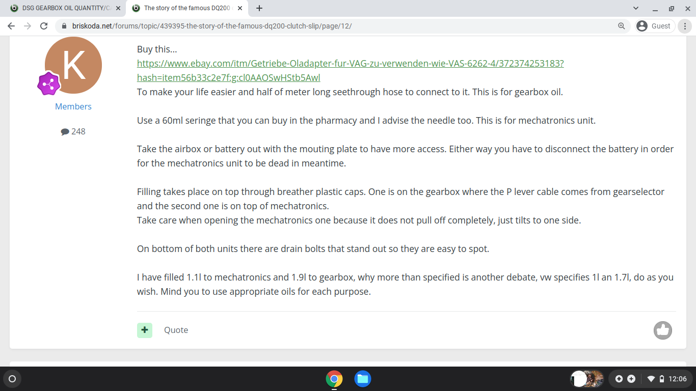

Page 11 & 12 is an Oil Change on a DQ200,  Box and the MCU, there are 2 different oils.
http://briskoda.net/forums/topic/439395-the-story-of-the-famous-dq200-clutch-slip/page/11

DQ200 has two parts oil wise, the main gearbox and the mechatronics unit. Seperate oils and completely different oils, the gearbox oil is just gearbox oil just over 2 litres probably,  the MCU oil is a hydraulic oil about a litre I think. Don't confuse the two.
Your fault indicates a likely failure of the pressure accumulator in the MCU, a common problem where it cracks and leaks
6 litres of oil is for the 6 speed Wet DSG not yours.
