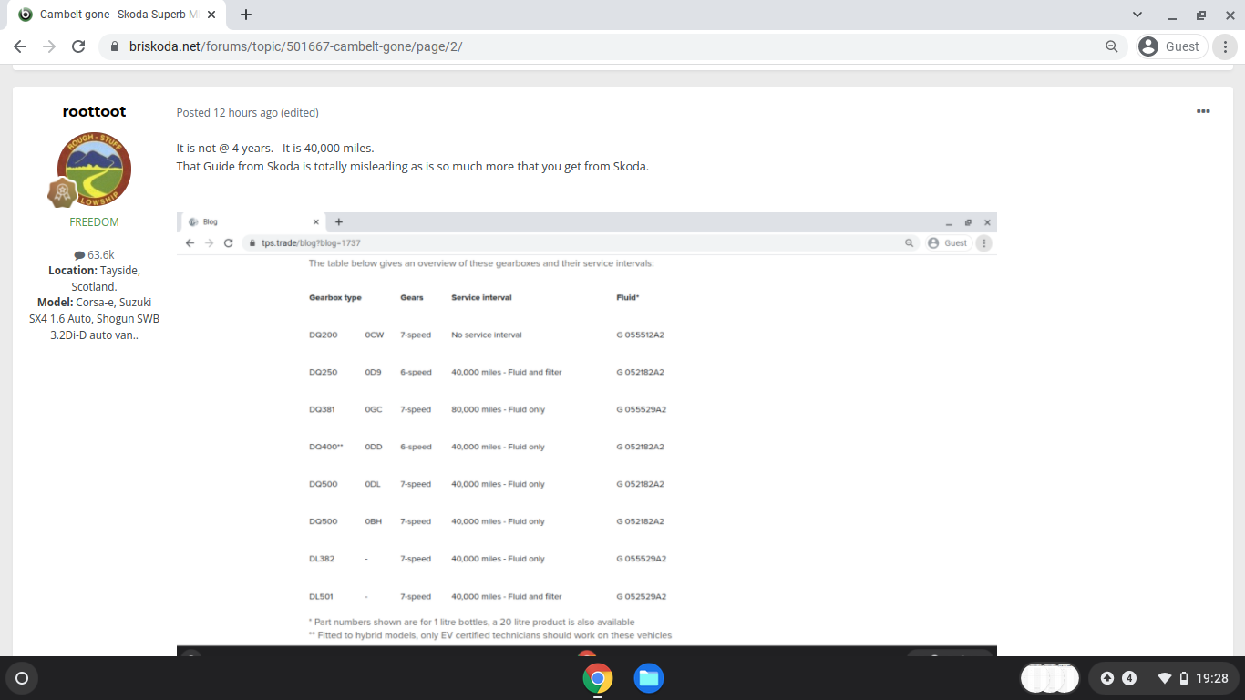

13 hours ago, roottoot said:
They put the Cambelt @ 5 years / 50,000 miles. Intending that as what comes soonest.
Just as Wet Clutch DSG's will be at 40,000 miles if that is before 4 years has passed,
1168293554_37335614_Screenshot2021-09-14at07_38_18(3).webp.ee5b8a609f78b3b2f42441d7532010fa.webp.99fd848152f92fa6dc8a60146e657e5a.jpg
http://briskoda.net/forums/topic/399720-octavia-iii-2015-16-tdi-cam-belt-intervals
http://briskoda.net/forums/topic/408046-16tdi-4years-80000-miles-should-i-change-my-cambelt
http://briskoda.net/forums/topic/329316-16-tdi-update-timing-belt-every-5-years
I think you are reading the chart wrong, the lower bits arent on the same time scales as above, they could be on one or the other. DSG oil is definetely not 4 years, only a time marker on it.

@ApertureS  I think i am not reading it wrong.
I know and have never suggested the DSG Service is at 4 years & post exactly that almost weekly in threads.
I posted this morning this morning to the member that asked just after the post you linked.

Its not an issue, but the only 'true' source is the owners manual and vehicle spec, not a dumbed down sales spreadsheet for every car, seen as every engine and model has different routines. Also depending on climate can effect some countries.
Im gonna try and find the true values for the question we are all bouncing back and forth on
@ApertureSIt is an Issue that the 'Owners Manual' will not tell an Owner with a DQ200 DSG that their box does not have a Schedule for oil changes but Service Desk staff or Sales Staff will tell some their cars DSG is due at 40,000 miles and this has been for over a decade now.

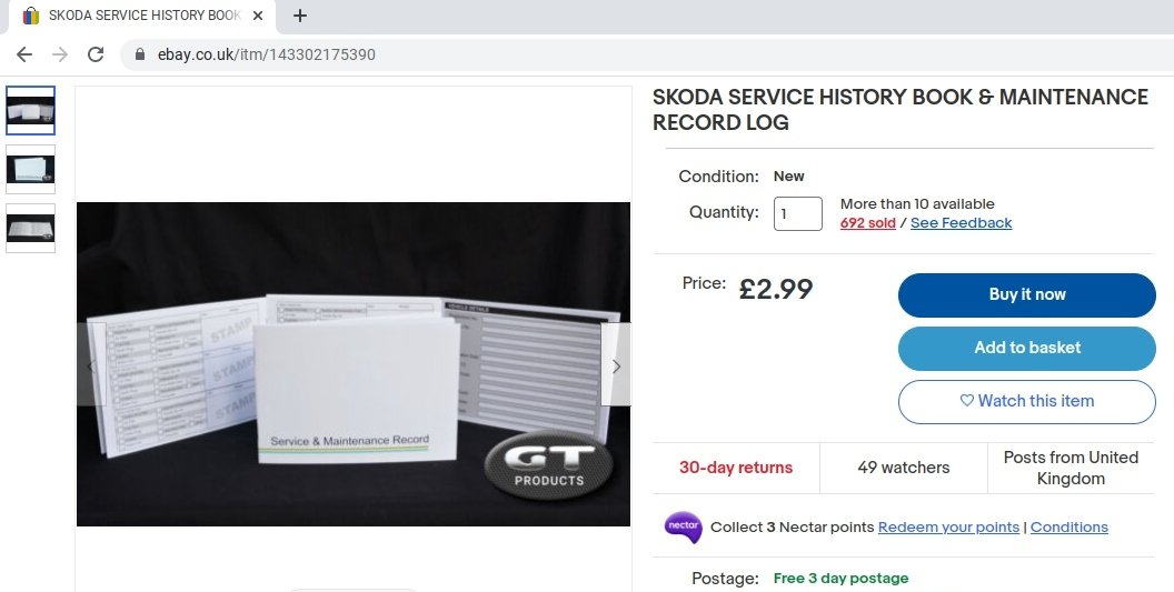

so with that said does anyone have any ideas where I can get a Skoda service logbook?  Dealer won’t give me one.
You could look on Ebay.
You can get Blank Service Books which you can ask people servicing to fill in.
They were commonly used by people to make up false Service Records for vehicles.
But then a Service Book for cars pre 2014 is not much use for looking at what each service shows for a car after that of a different generation.
Things like at the 5th Service on fixed regime replace the Alarm Siren tends not to be done.
Best pay your money and get the information from online for your cars servicing schedule or recommendations / guidelines.

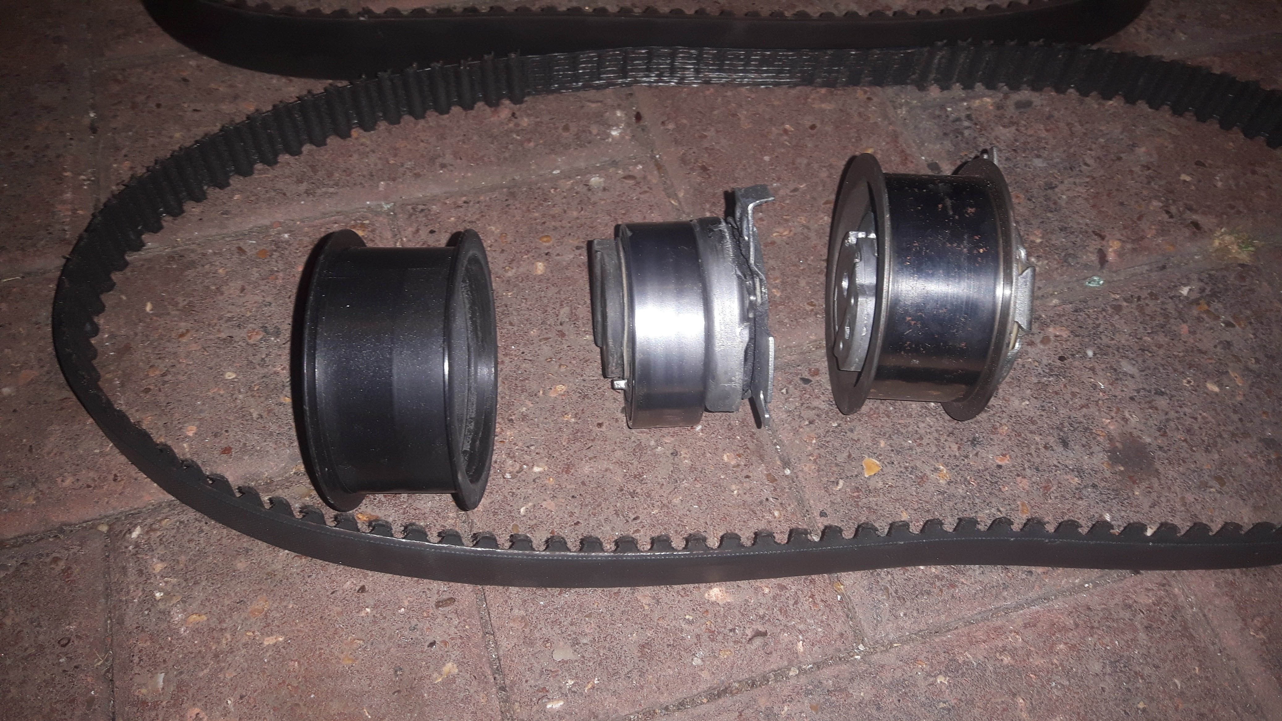

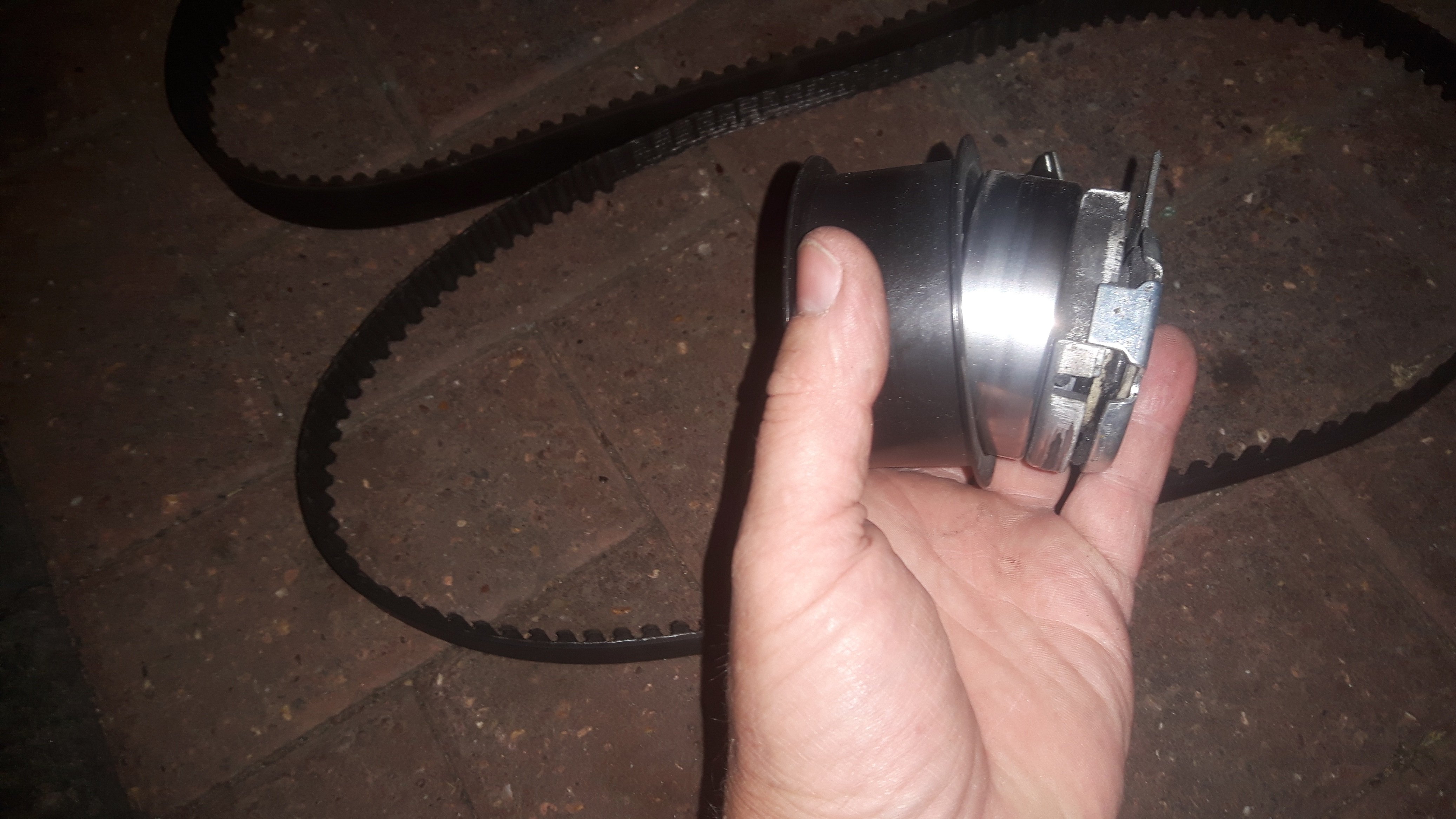

I bought a high mileage 2012 Superb MK2 last September with 181,000 on the clock. The service record wasn't complete but did show what must have been its 1st cam belt change in September 2017 when it was 5 years old with a mileage of 107,433. So it had been changed as per Skoda's suggested service interval of 5 years or 145,000 miles which ever comes 1st. So by that reckoning the next cam belt change interval was a year away and should have been September 2022. For the sakes of £70 I bought a Gates cam belt and water pump kit and changed it. All the old parts appeared to be in good condition no noticeable noise or play in any of the rollers or water pump and the VW logo was still just visible on the cam belt. Some of you might argue that they'd save their money and they'd expect a cam belt to last to the manufactures suggested service interval. Okay that's your choice but what will you have saved if the cam belt does fail prematurely to the suggested service interval? I'd sooner try and avoid the aggravation of it failing and have some peace of mind

I had no reason to check it really as I'd changed the cam belt some 3 years earlier when I 1st bought the car. I wasn't excepting the tensioner roller outer to come un-bonded ! though since I've read about this kind of failure of plastic outer rollers bonded to steel inner rollers.
I agree, it was an observation not a riposte, I check mine regularly because I have gone to 250K before replacement before now so it's condition is important to me.
After replacing the belt I continued as I had not changed the tensioner, bearings or waterpump etc, I trust the factory fitted stuff more than aftermarket once it has already covered that sort of mileage without failure.

I had changed the roller & tensioner  on the Ibza at the same time so wasn't expecting anything to go wrong ! 😅 Though as you've previously mentioned some none OEM parts are of a questionable quality. Though some none OEM supplied parts are made by the same manufacturers who supply  OEM just not allowed to use the car manufacturers logos or part numbers.

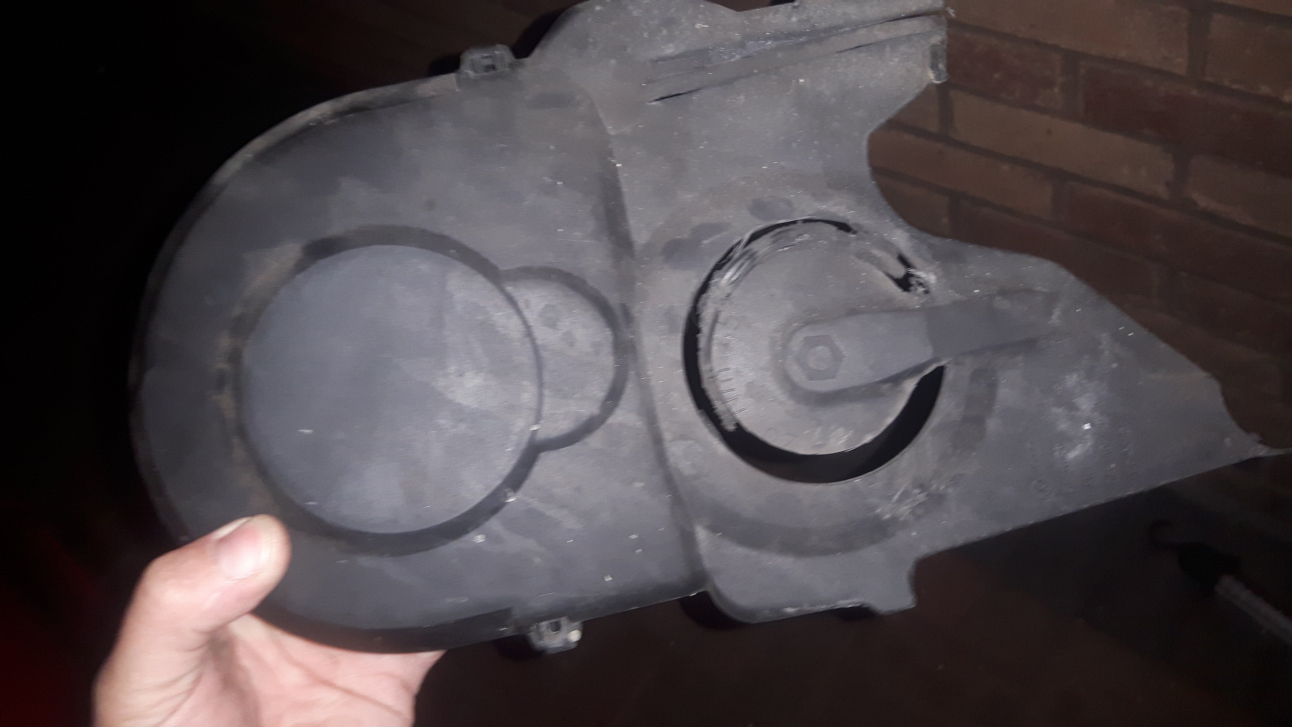

Going back to this threads original subject my Superb MK2 2.0 TDi  CFGB engine cam belt layout in the photo is much different to the Superb MK3  2.0 TDi EA288, DFHA engines?
