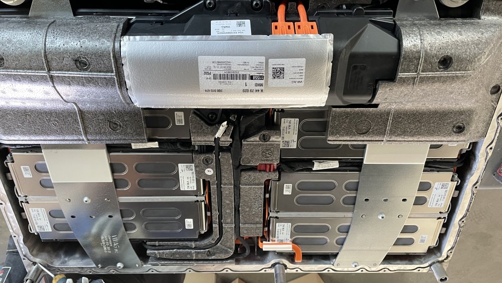

the opening looks like this

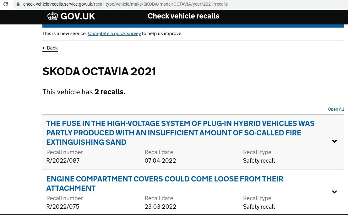

i received the recall leter from Skoda UK today about the need for a high-voltage battery insulating mat to prevent the possibility of a voltage flashover into the vehicle interior following a short circuit and a burst fuse. Slightly alarming, to say the least. I've contacted our dealer and another dealer 60 miles from here or about thirty from ours may be qualified to do the work when our car goes in for the mysterious battery cable replacement in mid-June. As with all the warranty work (six trips so far including a service) no mention of a contribution towards travel expenses. So the saga continues.

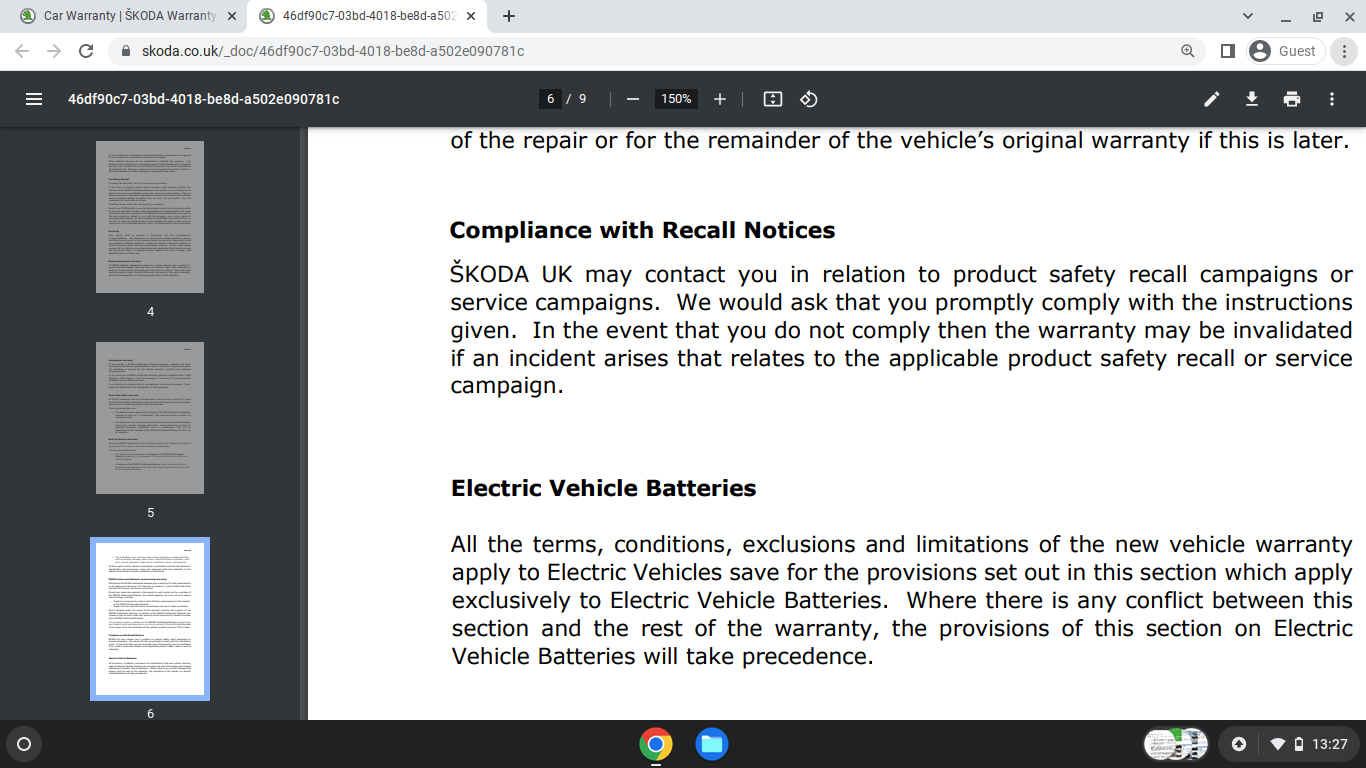

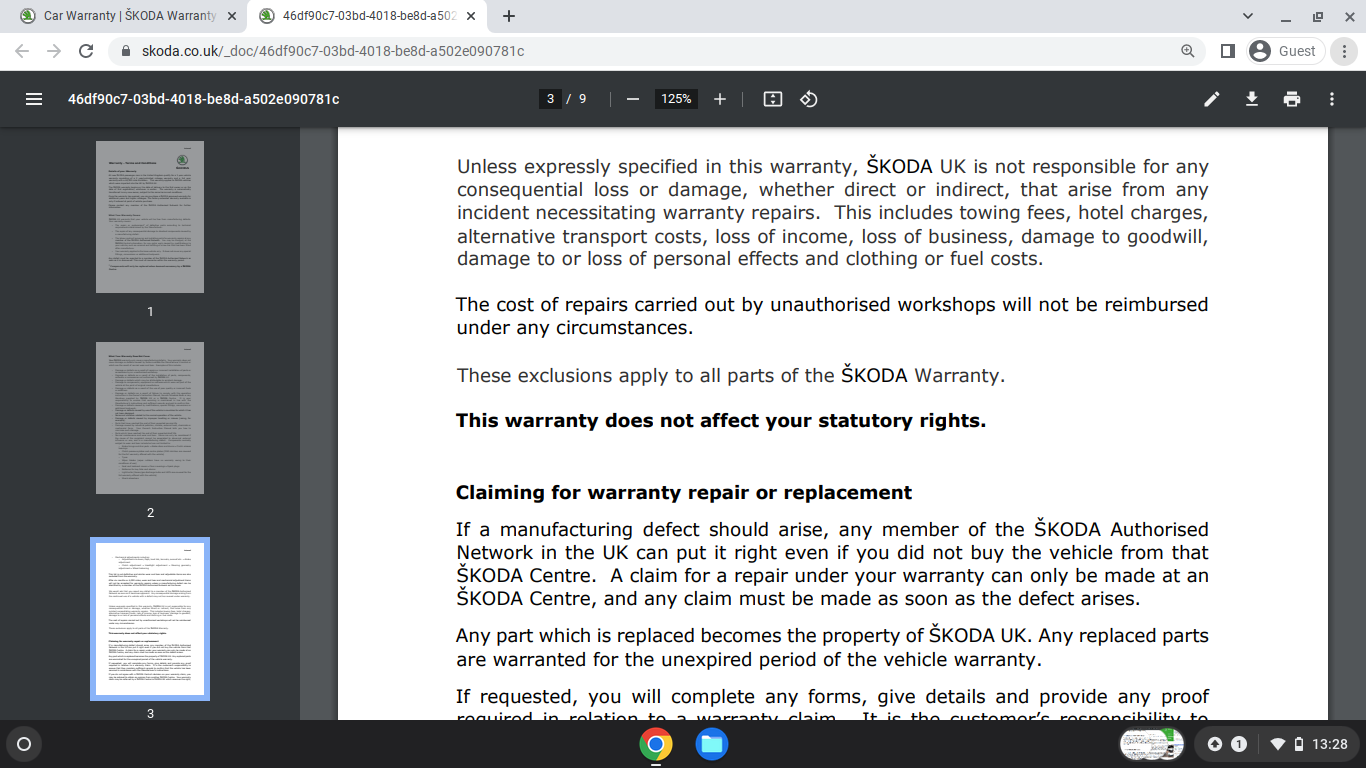

VW group had to train up people and equip vehicles when they did the Emissions fix which was a voluntary recall / service campaign.  This is a Safety Critical recall which they are required to carry out and as such for the warranty, owners need to have done.  Also for their and others safety.  So basically VW UK / Skoda UK need to shake their lazy backsides, put their hand in their pocket and if they need to mobilise techs then do so.  Or cover customers expenses in travel.   They know the hourly rate they charge customers, so they know what they need to pay.  They will after all get tax deductions for what their fundamental design, manufacturing and material or workmanship failings cost them.  Car buyers will get diddly squat other than inconvenienced.
This campaign is different from a Warranty Claim / issue,
this is a SAFETY RECALL because of Manufacturing Failings that have been discovered.
So travel at your own expense is questionable if the Approved Repairer network can not get it's act together.

Our Octavia has had a new battery cable fitted. This includes a control unit, so presumably the voltage loss will not happen again. I'll plug the voltmeter into the boot socket to keep an eye on things. The insulating mat is booked for sometime in August as there are very few dealers who can do the work. I'm hoping that the car is taken on a trailer if it is some distance away. Has anyone had success in asking Skoda UK to contribute to costs - this is our car's seventh warranty visit (including a service) so it's cost me over 400 miles worth of e-power and fuel.

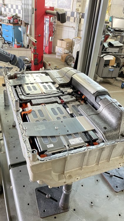

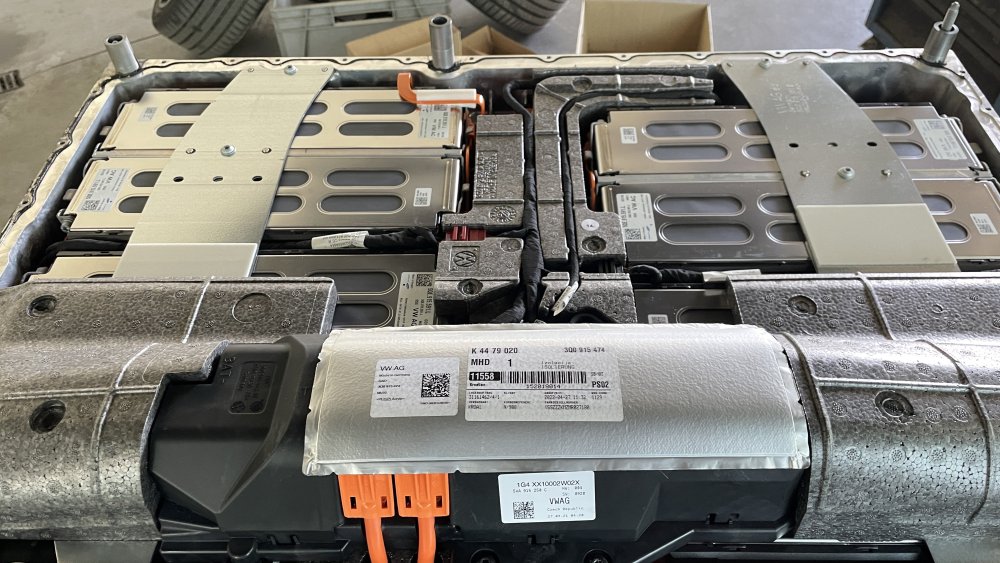

Just to let you know that I had this work carried out last year after applying lots of pressure to Skoda.
It took 2 days, mine was the first car to have this work completed so the mechanic said that it took longer than it normally would.
