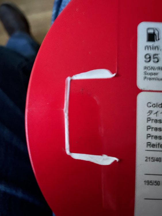

Mrs Gaz has just managed to snap her plastic petrol flap clean off 🙄:
It's a clean break.  Has anyone glued one back on before?  I'm wondering what glue might be best, or whether to just get a new one and be done with it.

I've got JB Cold Weld, but it looks like Loctite All Plastics might be the one to try for this particular application.

Do you know what type of plastic it is? If it is ABS then a smear of acetone, which melts ABS, on both halves and then press together should give a strong bond.  Otherwise as long as it is a voean break I would try  medium viscosity cyanoacrylate and a small amount of "kicker" although the use of kicker can weaken the joint. I am sure you are aware but if you use Gorilla Glue then you need to be very sparing with it and clamp the joint firmly as it foams otherwise it will push the 2 parts apart.
Superglue & Baking powder works wonders.
When doing it with the hinge on the car a bit trickier.
But basically once a little glue holds the flap in the correct position you apply the glue sparingly around the edges and sprinkle / blow the baking powder at the glue.
(Youtube videos of Superglue & Baking powder are available)
I have never used the bottom stuff with baking powder as the top stuff is amazing with it.

Loctite All Plastics seems to have done the trick :thumbup::
Unfortunately not before Mrs Gaz dropped the flap on to the drive for no apparent reason, chipping the paint:
