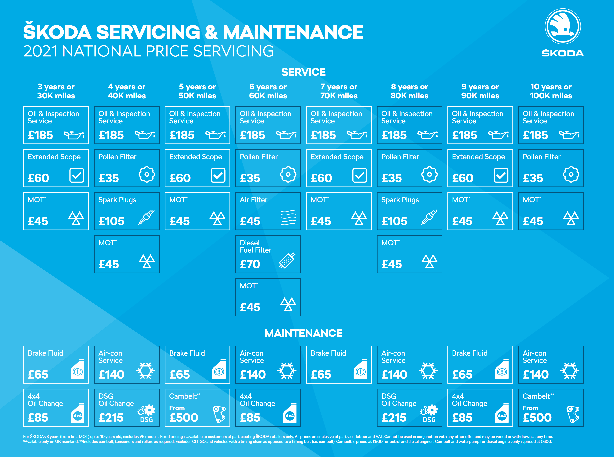

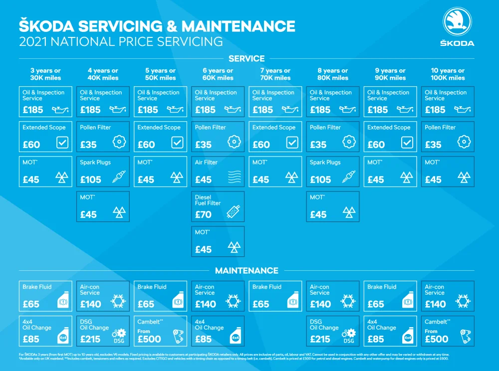

@ballcock  was that service at 40,000 miles done correctly might be the issue.  Were you advised to have it serviced then?    If it is a DQ381 the recommendation, guidelines, schedule from Skoda / VW is at 80,000 miles.  Sooner might be sensible.     But that would be by someone that does it correctly.    Just suggesting this as a possibility.    ?? Who was it that said a oil change was needed at 40,000 and was the filter changed?
@ballcock  do you have an invoice for the service showing parts used, this matters to see what was used as it is not the same as a DQ250.  I would be wanting to know that the correct service procedure was done.  They know which Tech or Fitter did the device.
Maybe that’s the problem. I had the DSG oil change done by a local garage specialising in VW cars. The 40,000 miles guidance was as per  a Karoq maintenance schedule dated 2021 I had downloaded.
Maybe they screwed it up.
@ballcock  I fear they might have.
There are videos showing just how it is done.
This Chart has mislead so many.   Skoda.
Then the TPS one, 80,000 miles.  But no filter.  Ridiculous.
