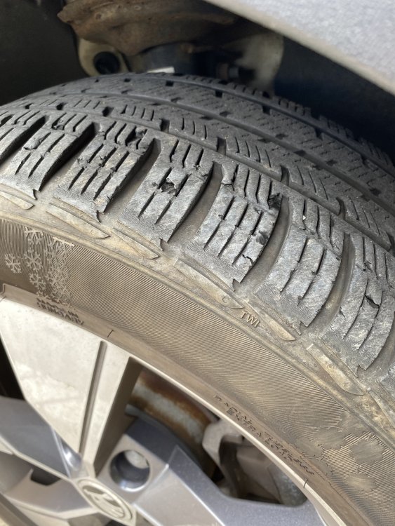

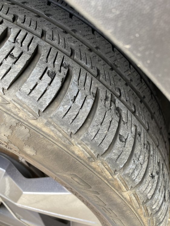

Has anyone ever seen this type of deterioration on front tyres? It looks a little alarming to me. DOT date on these is 3019 so not that old. They are Apollo Alnac All Season tyres that came on the car when bought so not sure of their mileage.
FA5FE0A9-7608-4096-8423-92BBAE811F81.thumb.jpeg.ec18b5d073d6b5f8b2be29194f4e4168.jpegC074884A-758A-4D05-88BC-29C7AA1C62D3.thumb.jpeg.9ab984be5975de51a592d74bf8a5decd.jpegThanks

2019 so not that old, but how many miles have they been on?
That is what can happen with All Season (Winter tyres) used in warmer weather.
Not all All Seasons obviously
Edited by roottoot
I have. Usually on cars that have winter tyres on during summer as the high temperatures destroys the rubber.
I have on All Weather / Snow tyres all year and that can include high temperatures in a Scottish Summer.
Not all £70 tyres will fall apart but some can.

Have you been driving at over 60mph in the summer, or have you been driving like Miss Daisy?
If you haven't gone over 60mph, and have that heat damage, then those tyres are really, really bad and not just bad.

I do drive like Miss Daisy! My daily commute is 120 miles around. Usually set cruise at 68mph. All easy motorway miles too.
I'm not a big fan of tyre review summaries, you need to read individual reviews to see how relevant they are to your circumstances and needs and note the review dates, tyres have changed a lot even in the last few years. - https://www.tyrereviews.com/Tyres_For/Skoda/Octavia-Scout.htm
60 miles with 68mph on some of the very hot days we've had might affect some tyres, once the damage is done it's done.  Some roads including bits of motorway seem to have some rough chippings type surfaces which I've found more noticeable on more recent tyres.
Are there any other things you can think of that might have contributed - you carry heavy loads, like drifting, having lower tyre pressures, like skidding to a stop, have you lent the car to any younger members of the family or friends, work colleges.

I imagine drifting an automatic, AWD car is quite difficult. It’s only ever driven by me, with no extra load, correctly inflated tyres and never skidded!!! I guess they’re just junk.

They won’t have be original from when car was new
You have clearly be turning, or parking on some very rough tarmac to get those sort of abrasions, probably when it is quite a hot day

Not so much with junk tyres.  😁  I wasn't being entirely serious just seeing if there might be further information.
Don't get too over-confident because it's an AWD as you've discovered it still rides on four small patches of 'rubber'.
It maybe that the vehicle was standing a lot on those tyres rather than being used which can also age the tyres.  The TWI (tread wear indicator) bar in the tread isn't showing in your photo so the tyres may not of had too much mileage and/or they are very hard wearing, in other conditions.
