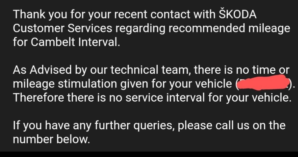

  • I called Skoda....the helpful customer service desk sent me email below (told me the recommended intervals were removed July 1st 2023), which says both time and mileage based intervals are no longer g

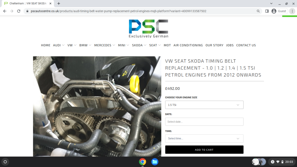

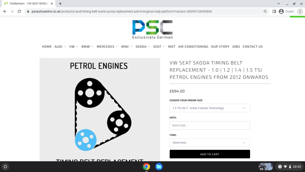

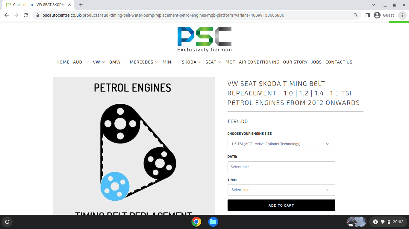

Much cheapness then if it is for a 1.5 TSI ACT.

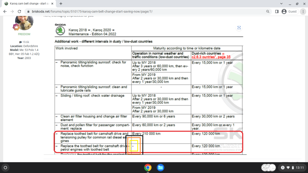

The debate will always rage on, for a "dust rich Country" there is only a distance requirement of 120,000km, for UK this means it doesn't need changing.  Skoda UK will tell you do it at 5 years to cover themselves, but if you prefer to play it safe, do it at 120,000km or inspect it.
