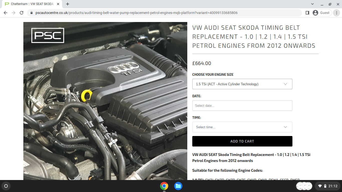

Ouch!  Over a grand for a timing belt. Mine is due within 6 months time, I won't be paying that for sure. I'll post some prices nearer to the time, if I decide to keep it. Other option put the grand into another car. Neither am I going to pay for their tool, they'll be using it on hundreds of engines no doubt.
Just had a quick look online, PSC would do one fro £664-
https://www.pscautocentre.co.uk/cart
Edited by Phoenixboy

Not like it's submerged in oil, costing mega money to change it. The Skoda dealer I used for some servicing work last year quoted me just over £500 to change the belt, although no idea if their prices had gone up, too. I'd certainly shop around no matter what, anyway.
@Phoenixboy
Simples. because you have to move stuff to do the work and then replace and supply with parts and people talking 6 hours plus and book in for 2 days that gets you where you are price wise.
Easy to quote £500 when you are on a service desk and know nothing about which TSI you are talimg about.
But they are learning eventually like  now that a 2 hour job is not the same as a 4 hour plus job.
Service centres have a displayed price using the parts they usually use, and then a different price with OEM parts.
eg.
PCSAutocentre that is up in a post.
*ASK THEM!*
Edited by toot

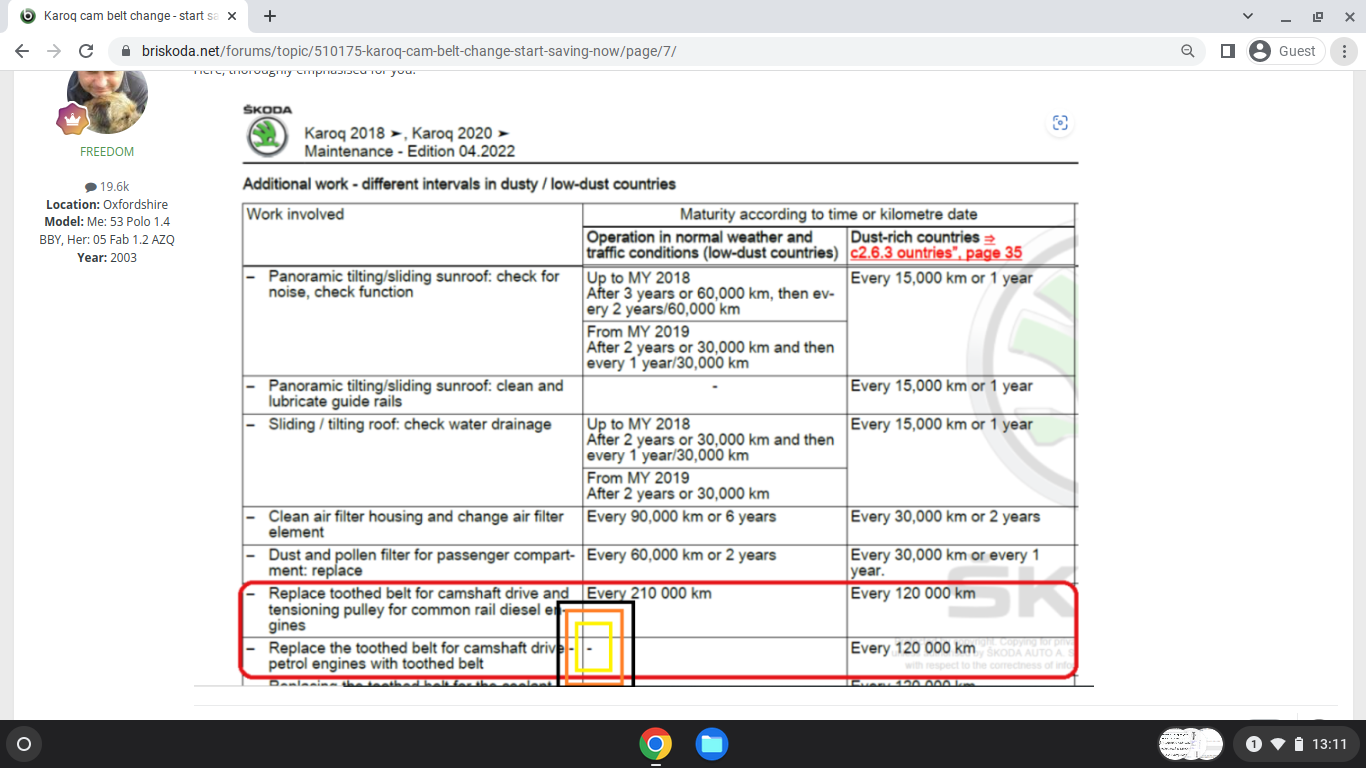

 I looked in the Maintenance book from erwin-skoda, doc subscription number D4B802A2B38, edition 10.2017.
In section 2.4.4 - "Additional work from MY 2017" - the table says "Replace the toothed belt for camshaft drive - petrol engines with toothed belt":
 - "Operation in normal weather and traffic conditions (low-dust countries)": "-" (no mileage or time interval specified)
 - "Dust-rich countries": "Every 120,000 km" (no time interval specified)
If anyone got hold of a newer edition of this book please check.
@rumburake  210,000 km / 130,000 miles shown here.
('Dust rich countries 120,000 km')
This is the issue, so many numbers around on-line quoting something some has seen, or mi-read / mis-heard.
Karoq.
Edited by toot

No it isn't toot. It shows - for the petrol engine, no specified interval.
That's why I triple ringed it to make it clear!
Please be more careful, it sems to be you that's misreading.
Edited by Breezy_Pete
