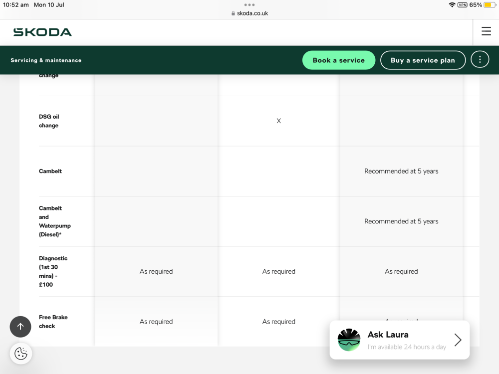

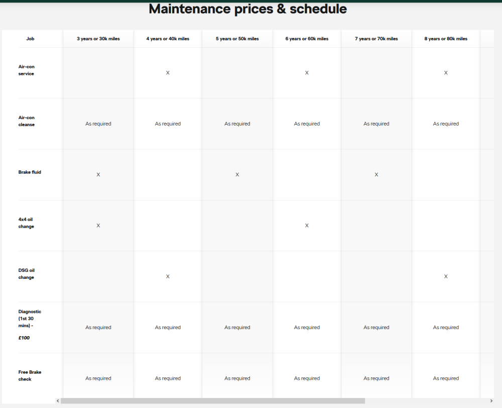

When I called Skoda UK themselves , they said they weren't aware of such an update and they still recommend chaning the cam belt every 5 years or 50k miles. So I'm still confused :D
 If I understand it right skoda does not really recommend changing the cam belt and it is one for life? So the dealerships are just playing scare tactics and getting customers to change it?

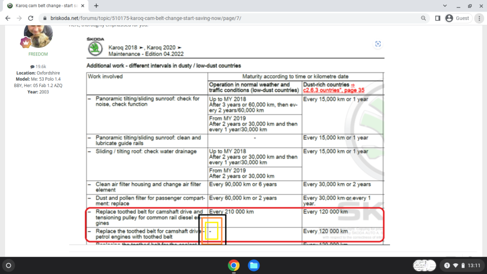

Up to MY20 and after MY21 the belt is 210,000km (60,000km in dust rich Countries)
"Up to MY21 and after MY21".    Is that another way of saying all of them ?   :D

No definitely not correct.
Up to MY20 then it swaps to a new year MY21 (meaning anything built in MY21 and onwards.)

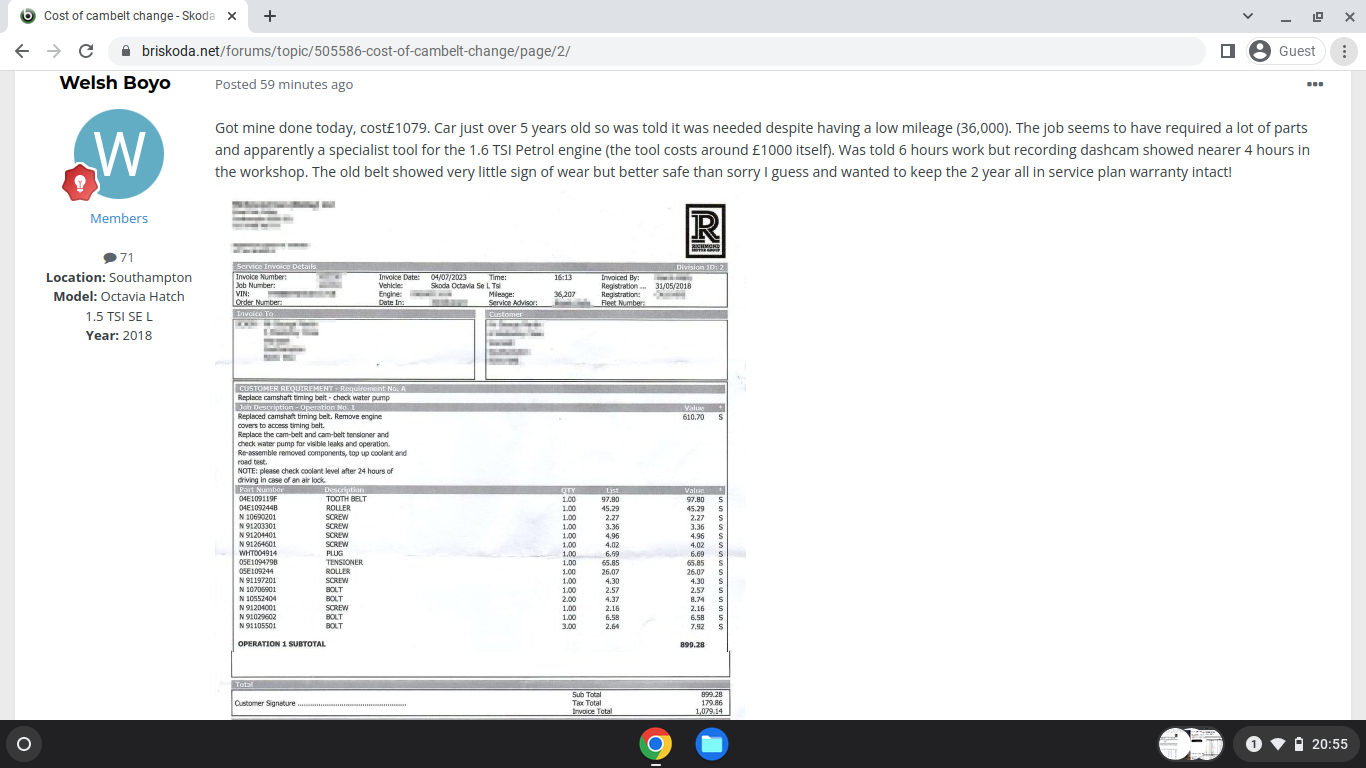

I had my Octavia 1.4 tsi cambelt changed at 5 years and 38k miles and asked for the old belt and tensioners back. On inspection they looked brand new. I still have them . I am on hols at moment but will post photos when i get back.
