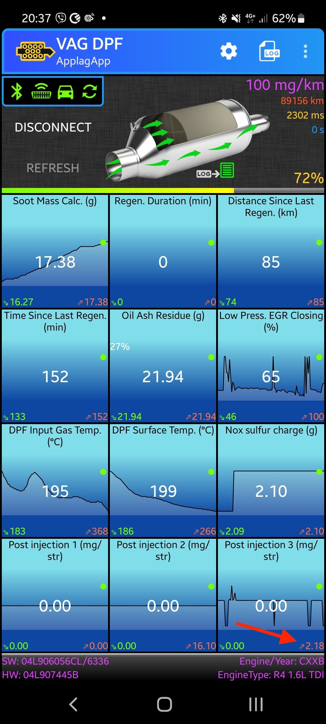

Hope you dont mind me stealing some of your time again. This evening I hooked up VAG DPF app while driving. Even though its not doing any regen, it is doing some post injection 3. In the lower bottom right corner you can see max value. Usually when I would peek on the app i would see 0.6 but it was not all the time. It was changing from 0 to some value. 1 and 2 were zero all the time.
Here is the SS from the app itself I took few minutes ago.
